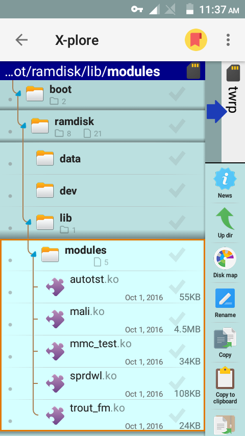

I have SPD 7731C running 6.0 Going To  Make Custom Recovery...
1)I have Used Magisk Manger to Path boot image  after Installing boot it's not Done Mean Root....
Installing in Recovery  booting Problem...
2)ported Via Howatek SPD Porting Tool Touch not Working
Original Recovery unable to Port
Ported via boot
Working touch issue..
Tried to fix touch.But could not find Exactly .ko file
Which is Used in Original Boot
Suggestions...Touch.... ko
See
Screenshot....

I need TWRP touch working
50,906
31-08-2020, 03:12 PM
(31-08-2020, 05:13 AM)AtifKhan Bhatti ...
does your stock recovery include the file, init.recovery.****.rc?
if yes, you could check its contents if the pathway for the .ko is included
if no, then unless you can find the ko. file, you're definitely looking at other alternatives @ https://www.hovatek.com/forum/thread-24209.html

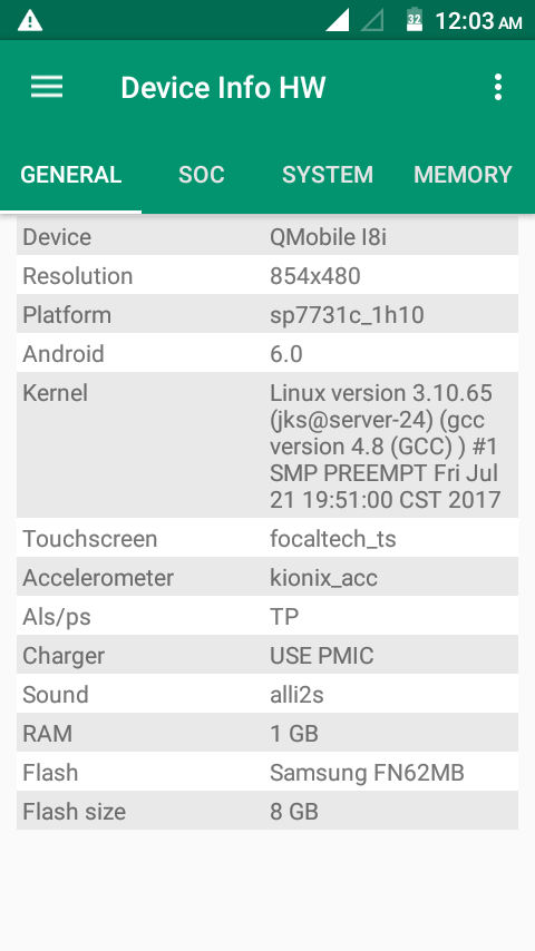

I Have
init.recovery.sp7731c_1h10.rc
 Apk showing focaltech_ts as driver
Unable to find Focaltech_ts.ko
In firmware or Root
In modules
Other ko files not Focaltech _ts
This post was last modified: 07-09-2020, 09:10 AM by AtifKhan Bhatti.
