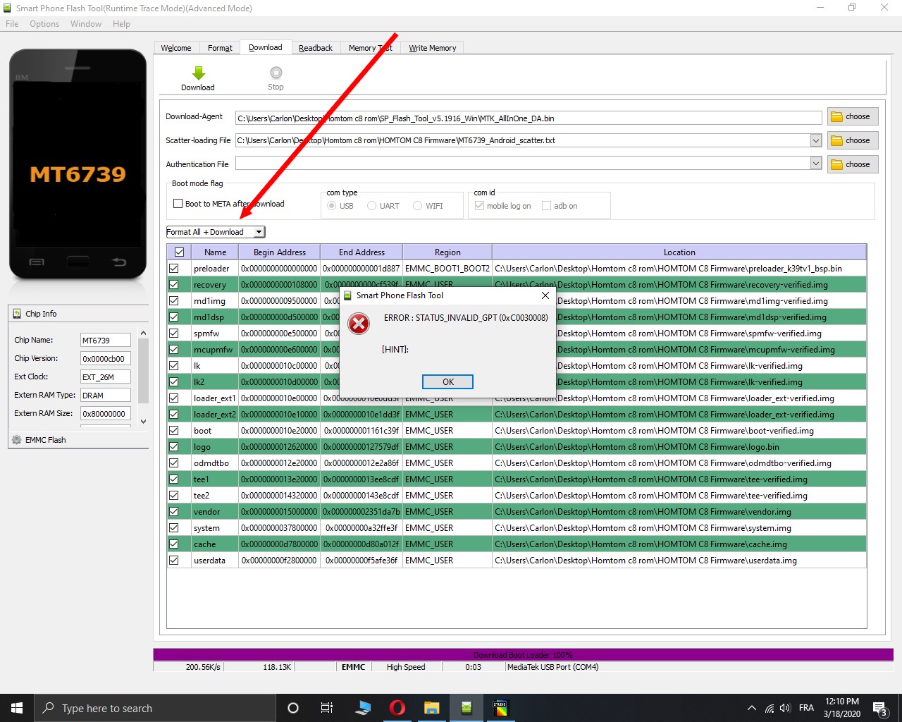

my HOMTOM C8 phone went dead after bad flash on SP FLASH TOOL programm
i tried to use programms and looking for everything but i still can't figure out how to bring it back to life
my phone won't boot up or shows up anything anymore
so my phone brand is HOMTOM C8 cpu MT6739[Image: ae08c014-8cce-4965-aa99-d5516dbd3937.jpg]
i tried to flash it again by SP FLASH TOOL
[Image: Untitled-1.jpg]
Successful formatting process as you can see
[Image: 2.jpg]
Write memory by preloader successful but only by  HEX 0x0 and Region EMMC_BOOT_1 otherwise won't works
[Image: 3.jpg]
but i get this error everytime at the end
[Image: 4.jpg]
even with Fomat All +Download still gives me that error
please i need help how to flash my phone to bring it back to life again i miss to my phone :'(

(18-03-2020, 12:23 PM)brander55 Hi!
from your screenshots, you are able to write back preloader using the write memory tab
this preloader you wrote back, is it the right preloader for your device? i.e have you ever used it successfully in the past?
if yes, then after writing the preloader are you able to at least power on the phone or it's still totally dead?

18-03-2020, 08:52 PM
(18-03-2020, 08:27 PM)X3non
Yess it's right preloader and i used it successfully in the past
i am able to write preloader in HEX 0x0 and Region EMMC_BOOT_1 otherwise won't works
but it's still totally dead :'(

19-03-2020, 10:17 AM
(18-03-2020, 08:52 PM)brander55 Yess it's right preloader and i used it successfully in the past
just needed to confirm these, the emmc chip on your device is faulty and needs to be replaced
