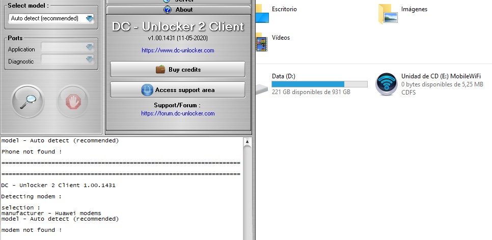

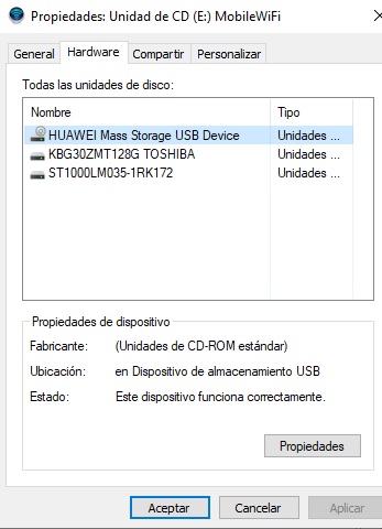

10-04-2021, 04:51 PM
#42
Thanks for answering X3non!
Plugin in the modem show up in 'my pc' as a drive E. See attachment.
Then it executes E:\autorun.exe.
Right-click on the icon gives the modem information, see attachment.
Still no modem detection by DC unlocker .....
12-04-2021, 09:51 AM
#43
(10-04-2021, 04:51 PM)superfast944 Thanks for answering X3non!
very strange, download the tool @ https://drive.google.com/file/d/1fWL3xmo...BeuCN/view
run the project mode .cmd
it should switch the com ports, then retry dc unlocker
