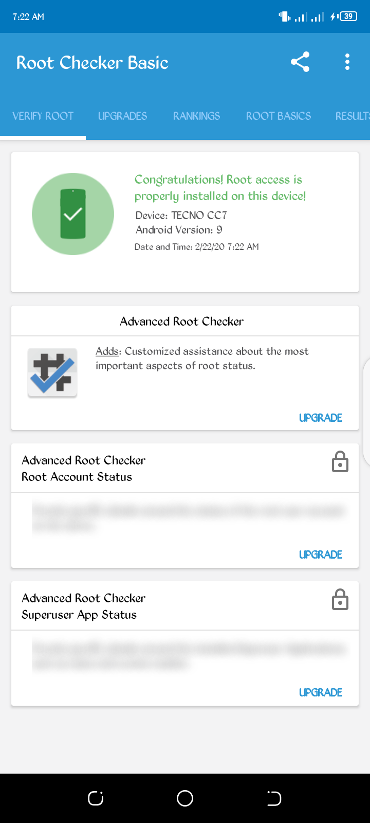

[Image: attachment.php?aid=7527]
I've successfully rooted my TECNO Camon 12 using the below procedure:
Download recovery.img & scatter file @ https://www.hovatek.com/forum/thread-31989.html
Download latest magisk manager app and zip @ https://github.com/topjohnwu/Magisk/releases
Install the apk then copy the zip to your sdcard
Port TWRP recovery using twrp auto port @ https://www.hovatek.com/forum/thread-21839.html
Download empty vbmeta @ https://www.hovatek.com/blog/dm_verity-i...-bootloop/
Flash the ported TWRP recovery.img and empty vbmeta using latest SpFlashtool @ https://www.hovatek.com/forum/thread-13970.html/
Boot to recovery and flash the magisk zip you copied to sdcard and reboot
