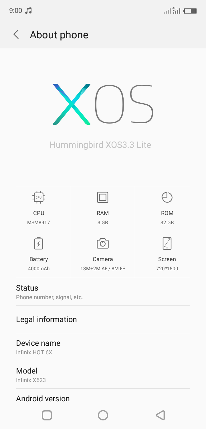

I attached a screenshot of the phone info
I take it this screenshot is your current build info (after flashing) and not before.
Have you tried a different (build number) firmware ?

The screeshot i took is after flashing and not before.
Yes, remember I told that you that my build number was Infinix_Hot_6X_X623_V37_181029 but after flashing this build number (Infinix_Hot_6X_X623_V37_181029) the sensors are stopped working. So I had to reflash the phone  from this Infinix_Hot_6X_X623_V37_181029, using your threads to this
[/quote]
Infinix_Hot_6X_X623_V38_181029 To see if the sensors problem was with build number. But I was wrong
So you can see from the screenshot I sent, but still the sensor are not working even with this build number Infinix_Hot_6X_X623_V38_181029_ Pls help me I donot know what to do any more. Pls help I donot have the money to change the phone. Pls help me.
