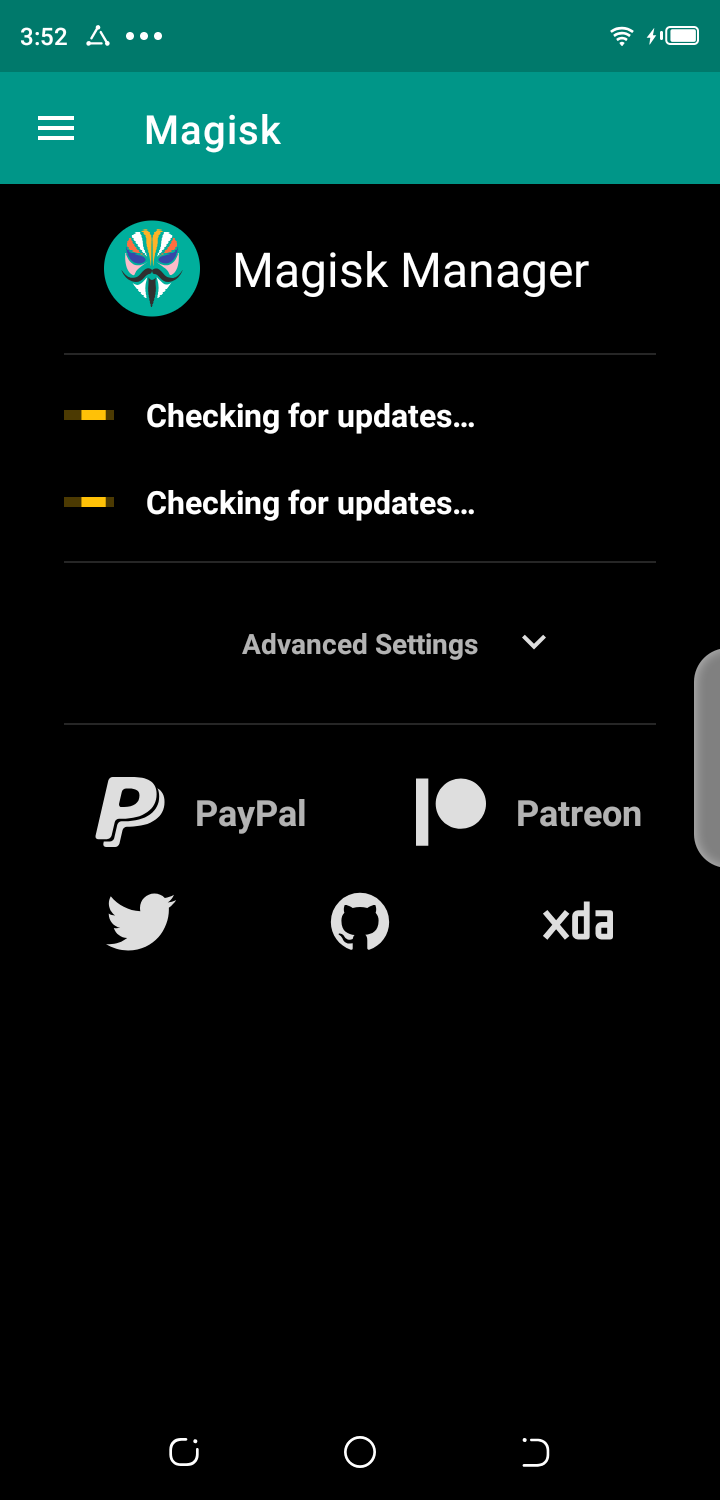

10-09-2019, 04:33 PM
DM_verity was not found when I flashed PhiIz recovery but it didnt work. It took me back to stock recovery. After that I flashed the patched boot from my stock ROM trying to installs magisk but I just got stock to the magisk updates. Its been updating for hours. Pls what should I do. I know I have a stable Internet. Pls find attached screen shot.

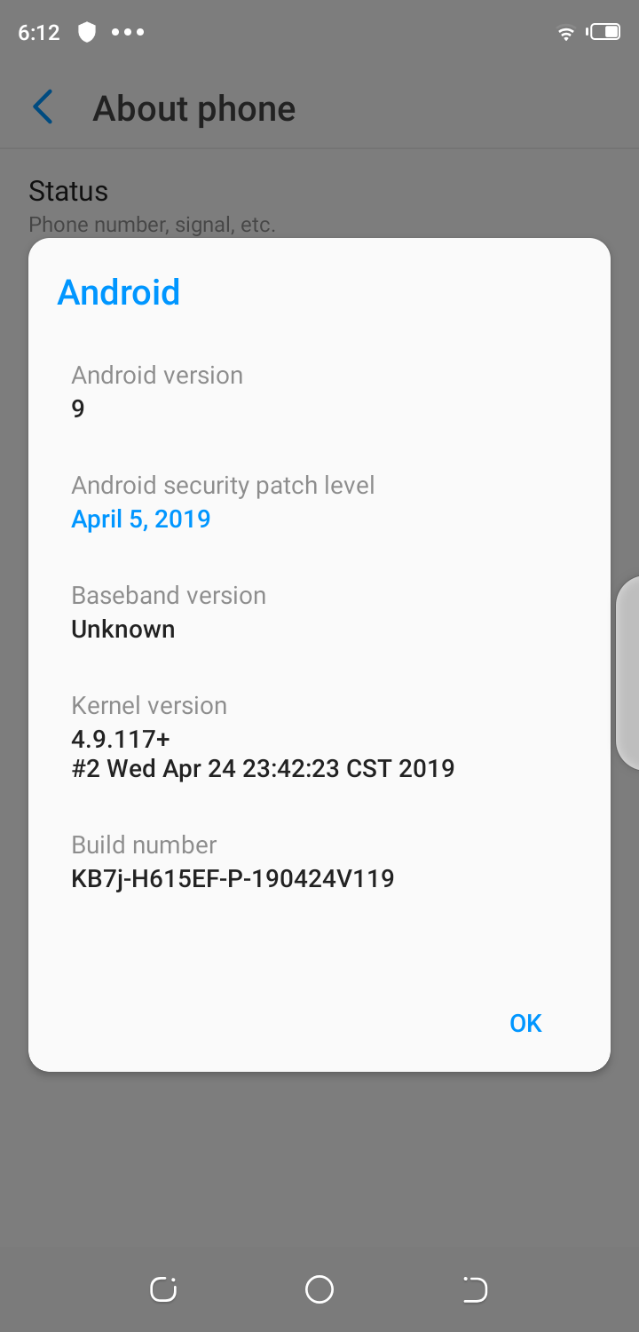

11-09-2019, 08:44 AM
My Tecno KB7j not yet rooted after waiting for the hanged updates. Ported Twrp & Philz recovery not working. I got the stock and boot image from your site.( I have flashed a full stock ROM) I will appreciate if you can send me a working modified twrp recovery for my PHONE MODEL. Find attached phone details. Hope to hear from you soon.

51,023
11-09-2019, 01:04 PM
(10-09-2019, 04:33 PM)Tomilola Ajayi DM_verity was not found when I flashed PhiIz recovery but it didnt work. It took me back to stock recovery. After that I flashed the patched boot from my stock ROM trying to installs magisk but I just got stock to the magisk updates. Its been updating for hours. Pls what should I do. I know I have a stable Internet. Pls find attached screen shot.
there's no fixing imei on an unknown baseband
what was the build number of your device before this unknown baseband problem?
do you have access to another working KB7j without this issue?
if your was baseband is the same as it was before the unknown baseband problem then download and flash the firmware @ https://www.hovatek.com/forum/thread-27738.html then factory reset in recovery mode to fix baseband
