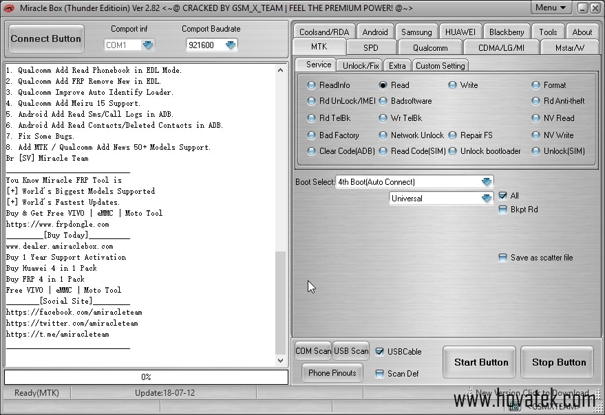

  1. Launch Miracle box
    [Image: How-to-use-Miracle-Box-to-write-IMEI-to-...roid-1.jpg]

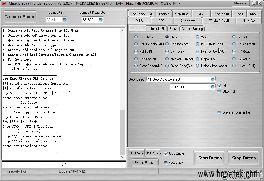

  3. Tick the check box beside IMEI(switched off)
    [Image: How-to-use-Miracle-Box-to-write-IMEI-to-...roid-3.jpg]

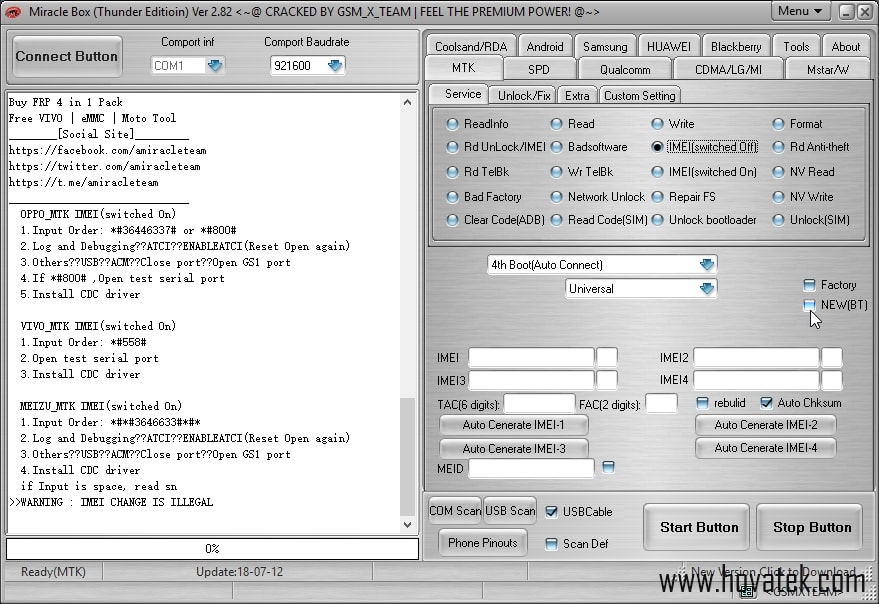

  4. Tick the check box beside NEW(BT)
    [Image: How-to-use-Miracle-Box-to-write-IMEI-to-...roid-4.jpg]

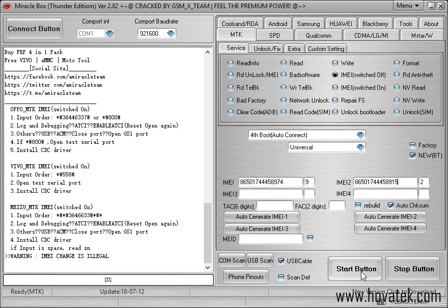

  6. Input the original IMEI into the IMEI boxes
    [Image: How-to-use-Miracle-Box-to-write-IMEI-to-...roid-5.jpg]
  7. Click Start
    [Image: How-to-use-Miracle-Box-to-write-IMEI-to-...roid-6.jpg]

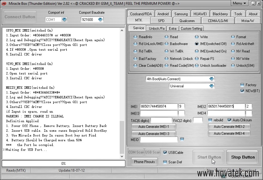

  8. You should now see >>> Waiting for USB Port... At this point, switch off the phone then connect it to the PC via USB cord without holding any buttons
    [Image: How-to-use-Miracle-Box-to-write-IMEI-to-...roid-7.jpg]

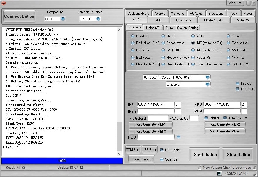

  10. Once the process is complete, you should see 'IMEI OK'
    [Image: How-to-use-Miracle-Box-to-write-IMEI-to-...roid-8.jpg]
