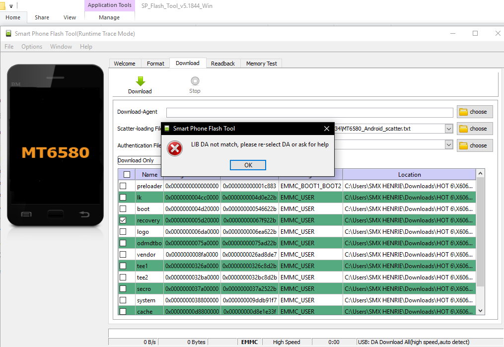

Hello,
I downloaded the DA file for infinix X606 from HERE
but got an error message:
"Error: LIB DA not match, please re-select DA or ask for help"
I used the lastest SP_Flash_Tool_v5.1844
If you have a new DA or Auth file please help.
my build number is:
X606-H8023CE-O-181227V134
Trying to get the phone from bootloop to normal without losing data.

From the error screenshot you posted, the DA is not loaded on SP flash tool.
I doubt you can get your device to normal without loosing your data. Boot to recovery mode and wipe/clear cache then reboot and see if it boots to home screen.

(05-02-2019, 05:50 PM)EMMANUS From the error screenshot you posted, the DA is not loaded on SP flash tool.
Cleared cache, but when you click choose for download agent to load the new DA file for x606, it doesn't get loaded and instantly displays error message. Or seeks for auth file if i use the sp flash tool DA's file.

06-02-2019, 08:18 AM
(05-02-2019, 05:53 PM)xhz
Try using a different version of sp flash tool, download @ https://www.hovatek.com/forum/thread-13970.html

(05-02-2019, 05:53 PM)xhz Cleared cache, but when you click choose for download agent to load the new DA file for x606, it doesn't get loaded and instantly displays error message. Or seeks for auth file if i use the sp flash tool DA's file.
delete the spft folder then re-extract a fresh copy and retry or try a different spft version e.g v5.1828
