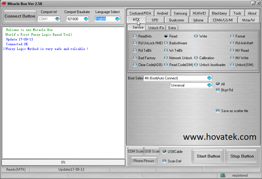

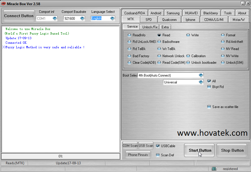

  1. Open Miracle Box and Click on MTK
    [Image: how-to-bypass-frp-using-miracle-box-1.png]

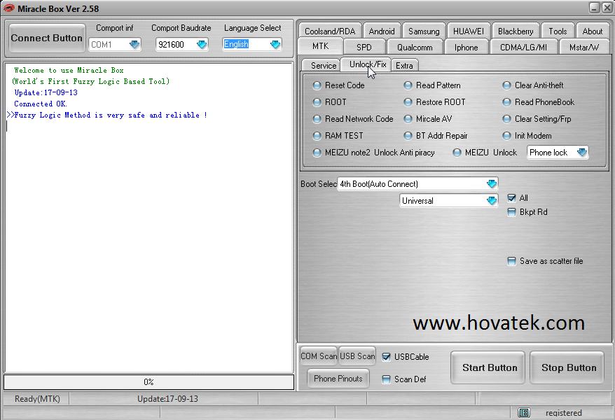

  2. Under MTK tab click Unlock/Fix
    [Image: how-to-bypass-frp-using-miracle-box-2.png]

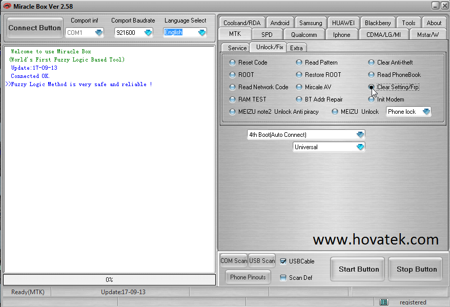

  3. Click on Clear Setting/FRP
    [Image: how-to-bypass-frp-using-miracle-box-4.png]

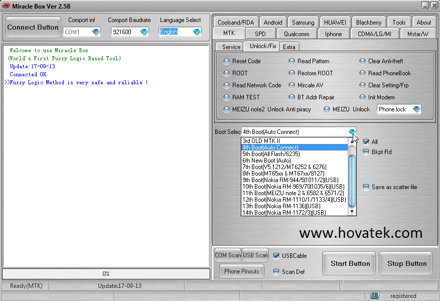

  4. Click on the Arrow to Select your phone's chipset or leave on Auto Connect if you don't know your phone's exact CPU.
    [Image: how-to-bypass-frp-using-miracle-box-3.png]
  5. Click the Start Button
    [Image: how-to-bypass-frp-using-miracle-box-5.png]

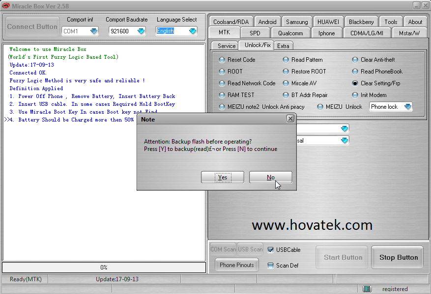

  6. Click 'No' on the pop-up dialog.
    [Image: how-to-bypass-frp-using-miracle-box-6.png]

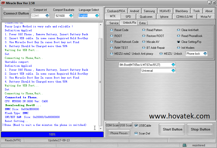

  7. Connect the USB cable to your phone once you see 'Waiting for USB Port...', miralce will detect and remove frp and you'll see the success message.
    [Image: how-to-bypass-frp-using-miracle-box-7.png]
