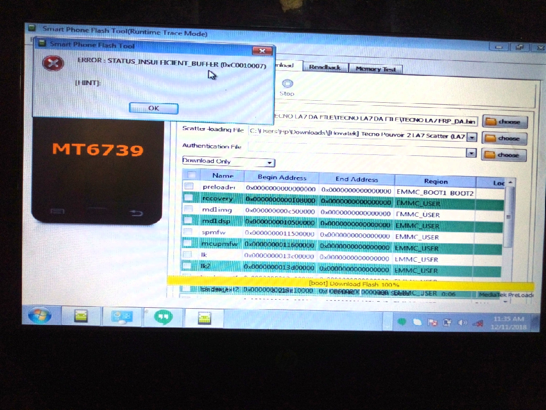

I tried 3 versions of spft
1st spft loads the scatter file but when I click download it stays at 0%.
2nd spft it downloads and when it gets to 100% it shows an error insufficient buffer size.
3rd spft doesn't load the scatter file asks to check scatter file.
My drivers are OK
Attach screenshot and try the fix @ x3non's reply.

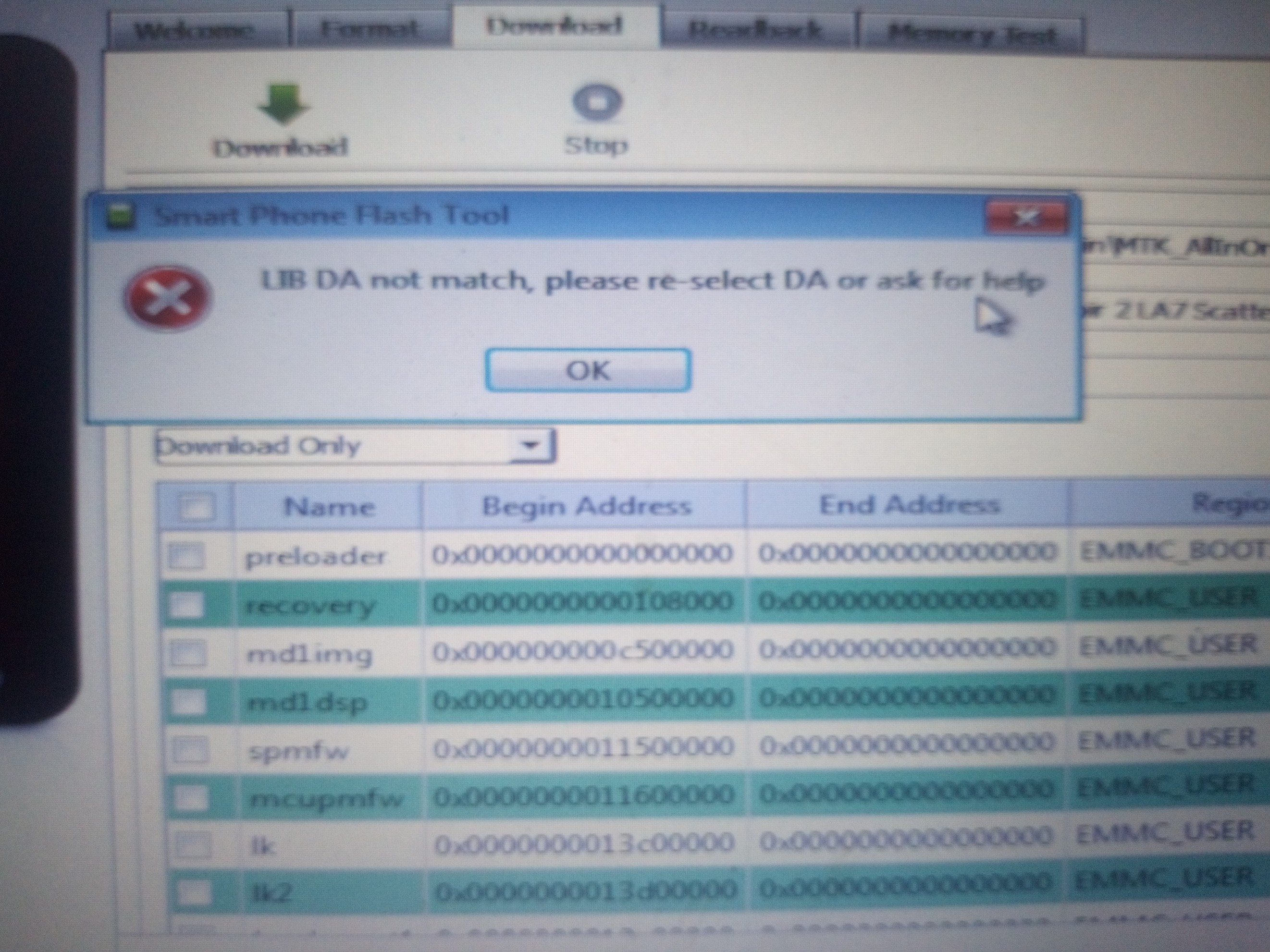

(10-12-2018, 07:57 PM)X3non
(10-12-2018, 05:19 PM)Ofomiyan1 Oem unlock? Yes. which of X3nons reply?
try using latest sp flash tool version along with the custom DA for LA7
attach a full screenshot of the SP flash tool window when you get the error message [shift the error message box to one side of the screen]
When I try to add tecno la7 da I got this error. I downloaded the latest sp flash tool
This post was last modified: 11-12-2018, 11:00 AM by Ofomiyan1.
51,003

(11-12-2018, 10:52 AM)Ofomiyan1 When I try to add tecno la7 da I got this error. I downloaded the latest sp flash tool
what's the exact version of SP flash tool you're using?

(10-12-2018, 04:59 PM)innagee
(10-12-2018, 04:23 PM)Ofomiyan1
(31-10-2018, 09:37 AM)X3non
(30-10-2018, 11:54 PM)Ofomiyan1 Do you know the flash tool he used because I've been trying to root my phone too tecno la7
to flash patched boot
download custom DA for la7 at https://www.hovatek.com/forum/thread-23243.html and see how to use custom da at https://www.hovatek.com/forum/thread-23733.html
flash using sp flash tool at https://www.hovatek.com/forum/thread-159.html ensure to load the custom da for your model and flash ONLY patched_boot using DOWNLOAD ONLY in sp flash tool
My drivers are OK
Is your phone's bootloader unlocked?
This is the error I get when it gets to 100%

(11-12-2018, 11:43 AM)hovatek
Spft 5.1828 downloaded from hovatek. I've also tried 5.1844. I don't know maybe the scatter file is not correct or something

#29
(11-12-2018, 12:14 PM)Ofomiyan1 Spft 5.1828 downloaded from hovatek. I've also tried 5.1844. I don't know maybe the scatter file is not correct or something
Your phone doesn't seem to be accepting the patched boot via SP flash tool. Hence the buffer error.
Unlock your bootloader using https://www.hovatek.com/forum/thread-19578.html then flash the patched boot via fastboot or sp flash tool
This post was last modified: 12-12-2018, 09:46 AM by hovatek.
