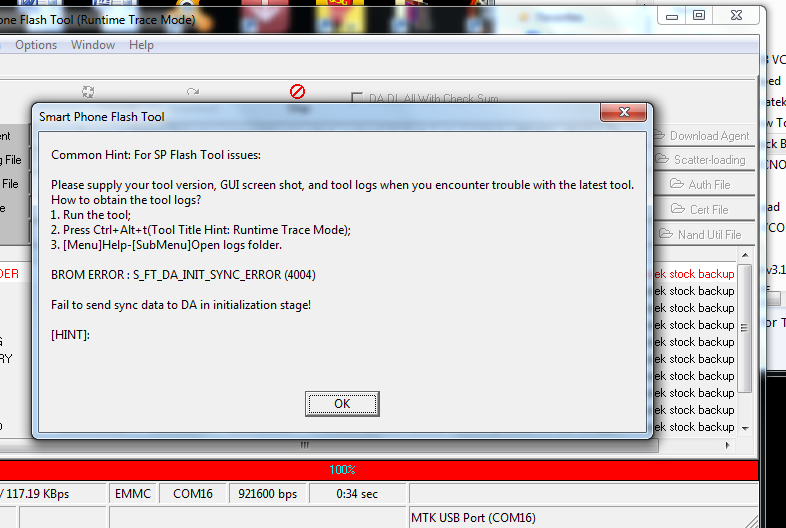

13-04-2015, 10:14 AM
HELLO and good morning Admin, this is a snapshot of the error message i got after using the sp flash tool , please what am i to do now? thank you sir

13-04-2015, 10:17 AM

(13-04-2015, 10:17 AM)Adele HELLO and good morning Admin, this is a snapshot of the error message i got after using the sp flash tool , please what am i to do now? thank you sir
ensure the phone is off before connecting for flashing.
try another port, cord and then PC

13-04-2015, 01:17 PM
Admin, my device is fixed, up & running and more super !!!!
fixed by inserting a memory card in the device before trying the flashing again and secondly i downloaded sp flash tool version 5 instead of using the version 3. x i downloaded here......thank you thank you thank you, God bless you for this good work you guys are doing.... i really trully appreciate...
