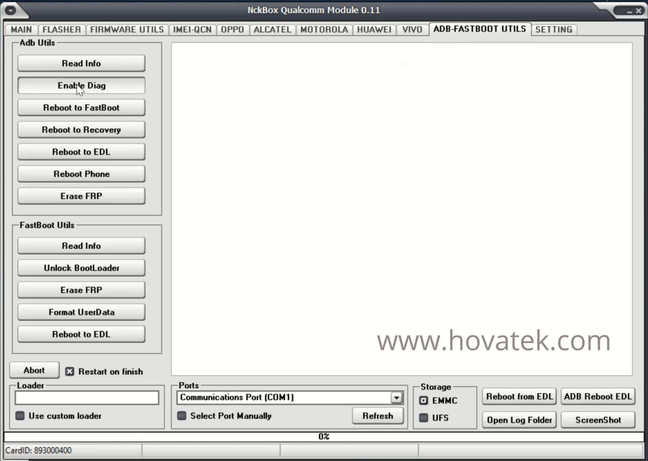

  2. Click the ADB-FASTBOOT UTILS tab
    [Image: How-to-flash-or-restore-QCN-to-a-Qualcom...-Box-2.jpg]
  3. Connect the phone to the box (while powered on) then click Enable Diag
    [Image: How-to-flash-or-restore-QCN-to-a-Qualcom...-Box-3.jpg]

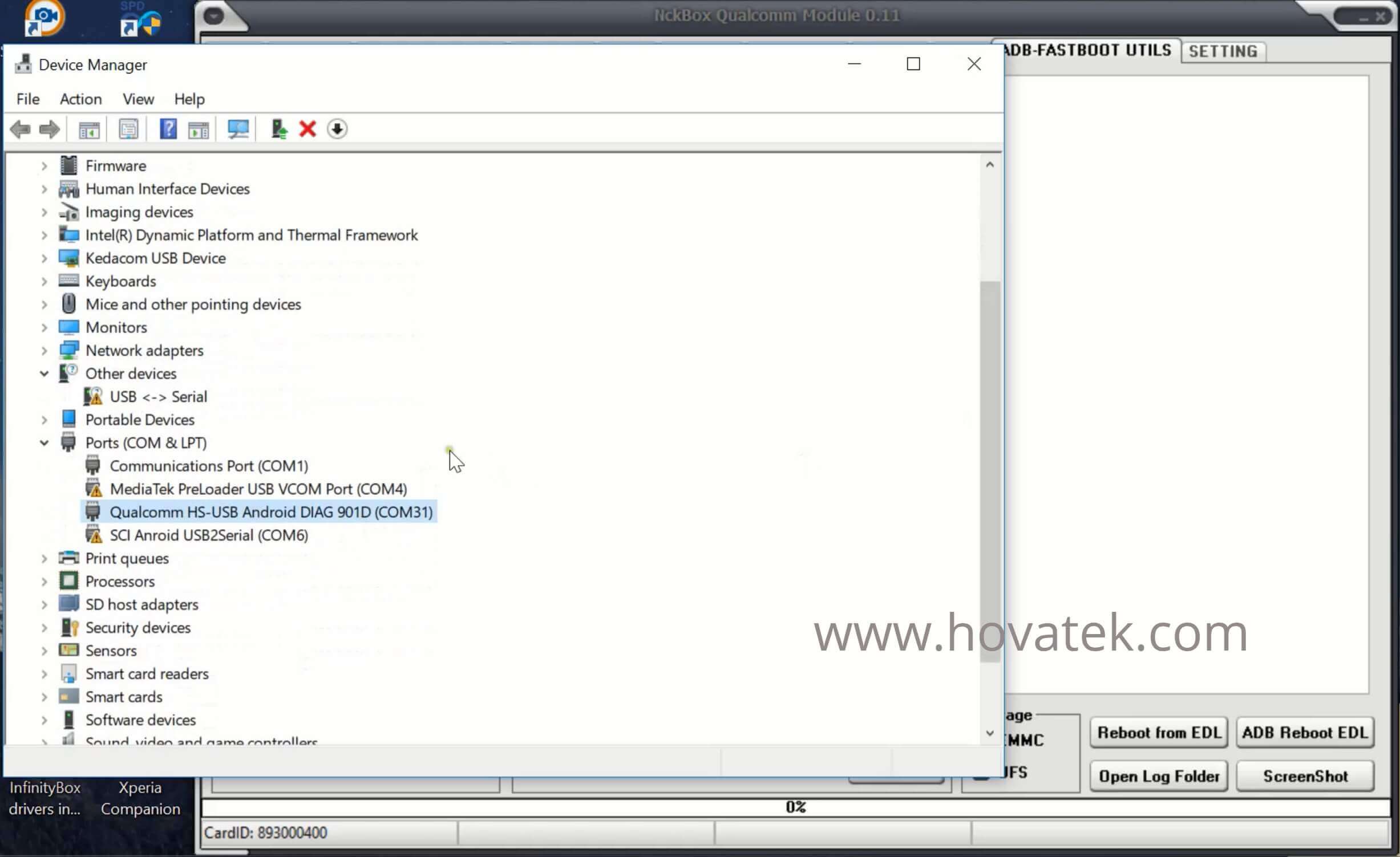

  5. Check Device Manager to confirm that Diagnostic Mode has been enabled (Qualcomm HS-USB Android DIAG 901D)
    [Image: How-to-flash-or-restore-QCN-to-a-Qualcom...-Box-5.jpg]

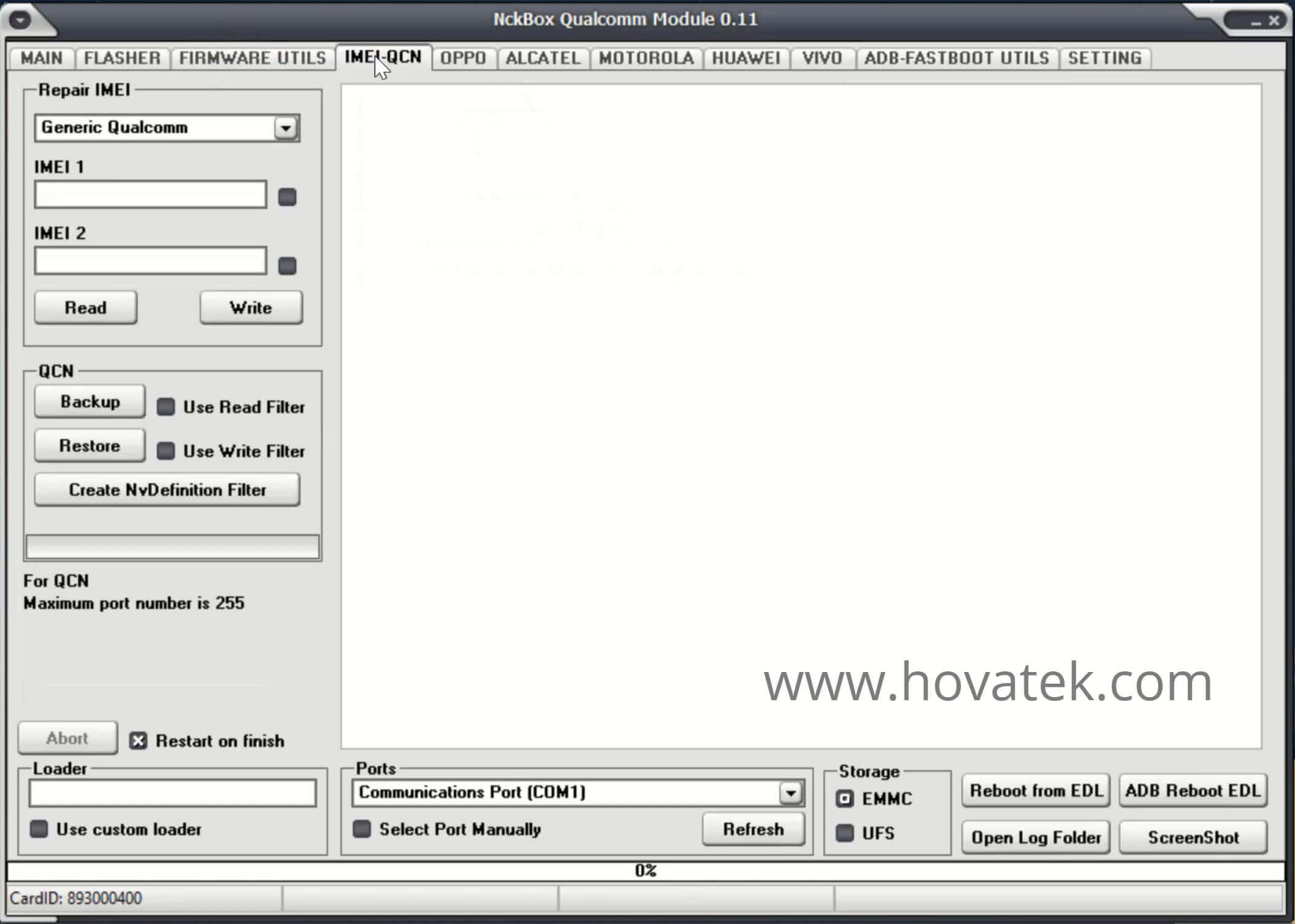

  6. Back in NCK Box, click the IMEI-QCN tab
    [Image: How-to-flash-or-restore-QCN-to-a-Qualcom...-Box-6.jpg]

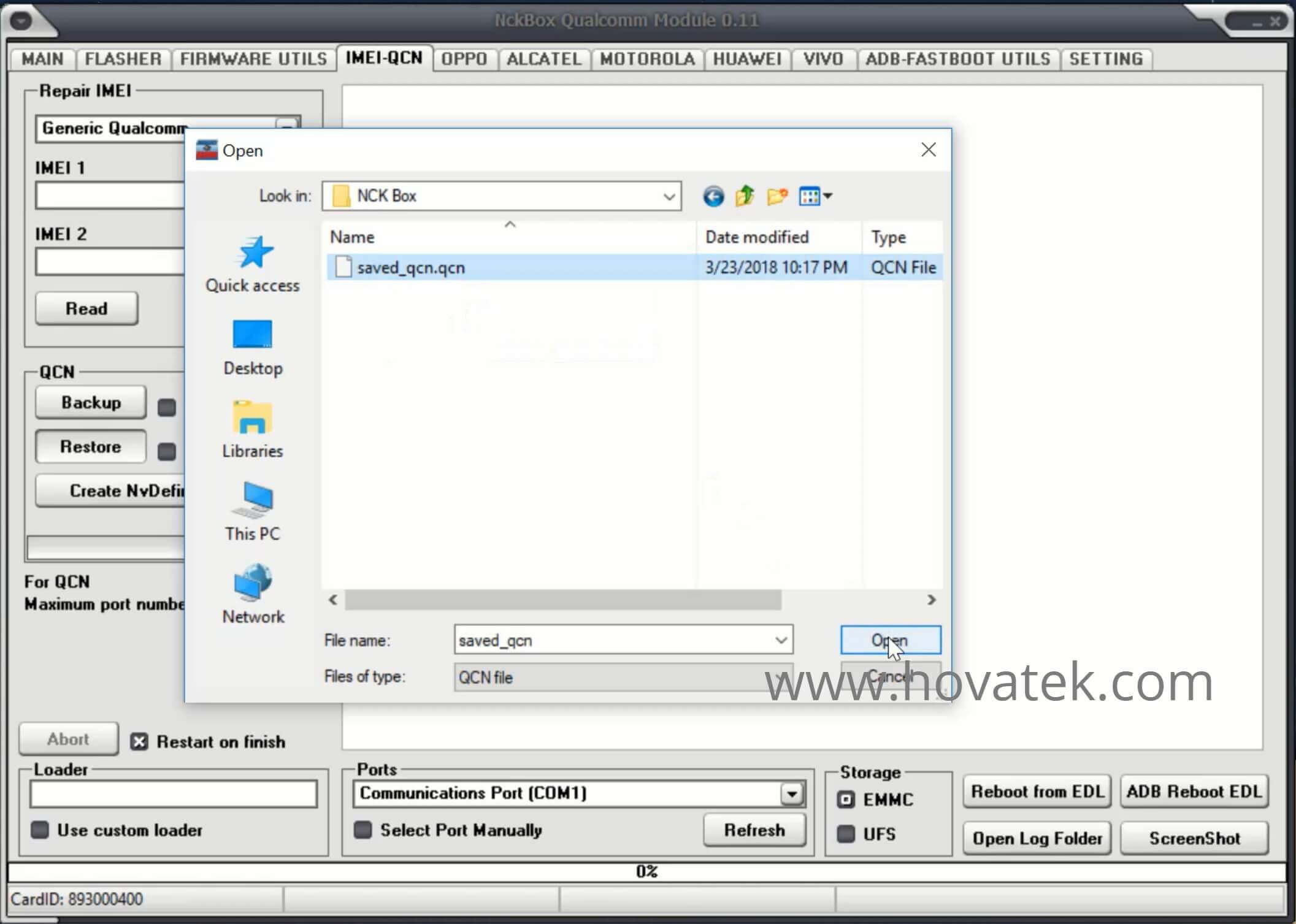

  8. In the Window that pops up, navigate to the location of the QCN file, highlight it then click Open
    [Image: How-to-flash-or-restore-QCN-to-a-Qualcom...-Box-8.jpg]
