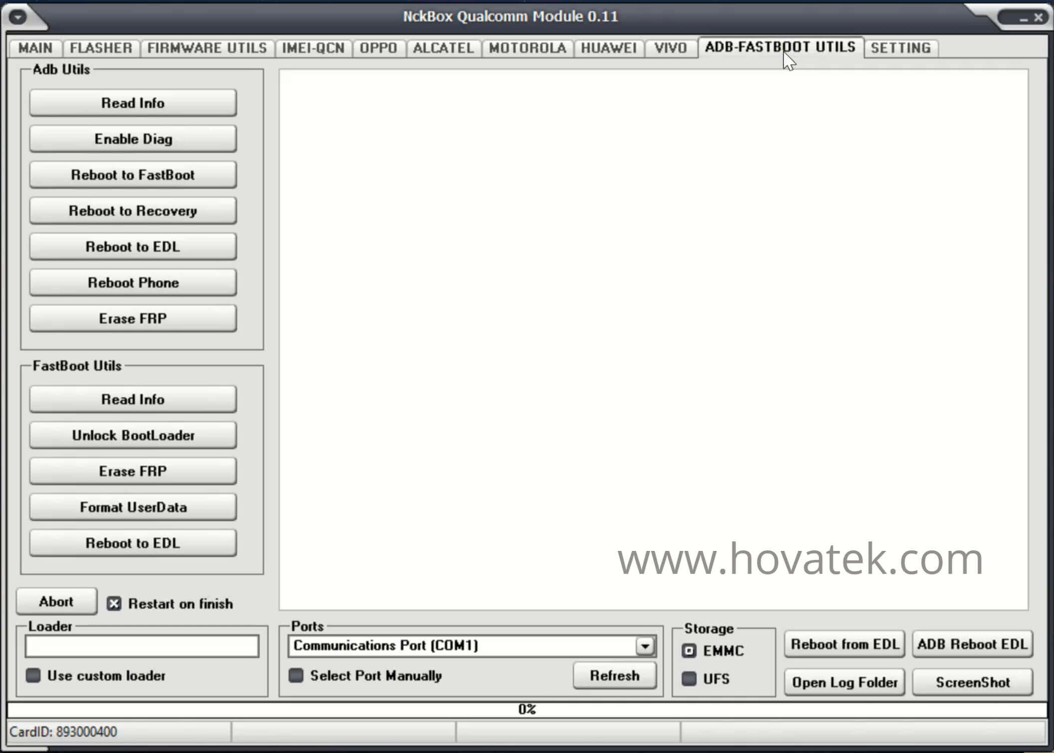

  2. Click the ADB-FASTBOOT UTILS tab
    [Image: How-to-backup-dump-a-Qualcomm-Android-ph...-Box-2.jpg]

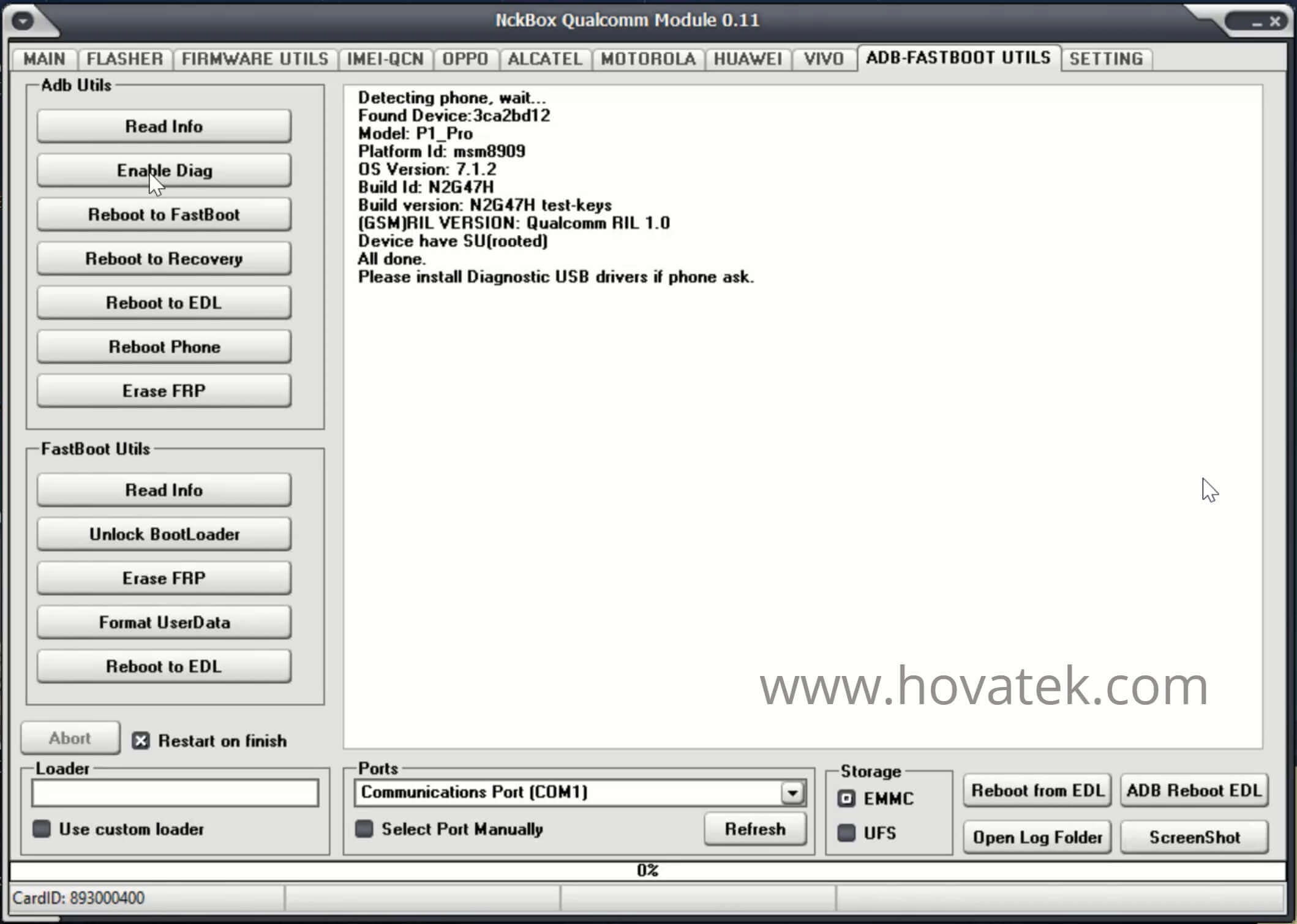

  3. Connect the phone to the Box (while powered on) via a USB cord then click Enable Diag
    [Image: How-to-backup-dump-a-Qualcomm-Android-ph...-Box-3.jpg]
  4. You should get a prompt on your phone asking you to grant Shell Super User permission, go ahead and grant. Once Diagnostic Mode has been successfully enabled on the phone, you should get an All done message.
    [Image: How-to-backup-dump-a-Qualcomm-Android-ph...-Box-4.jpg]

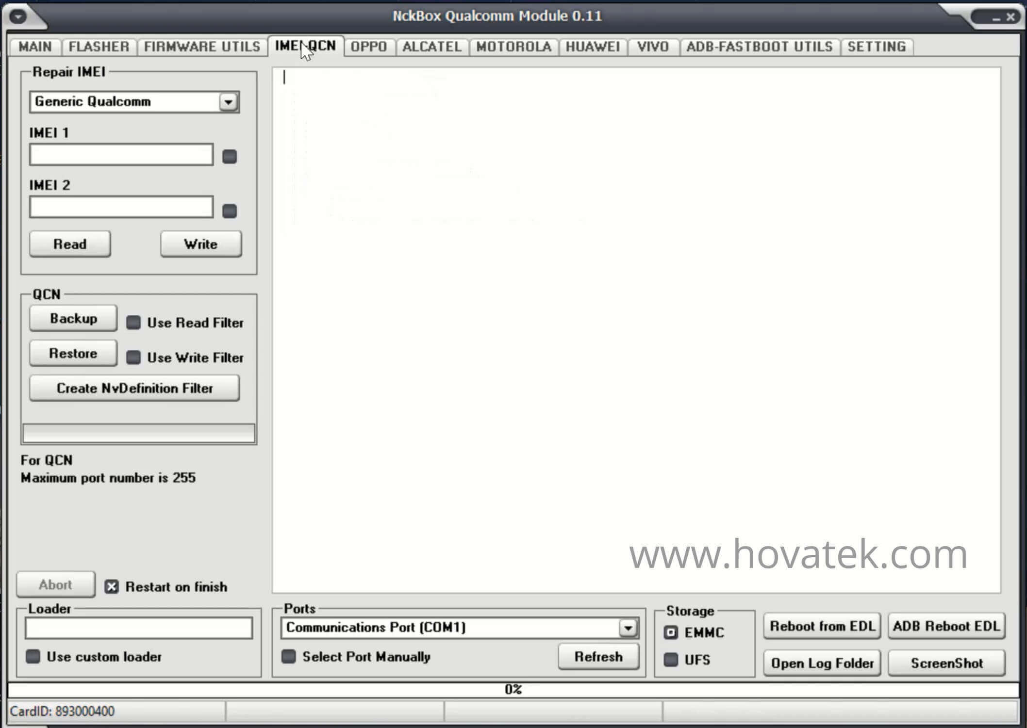

  6. Back in NckBox, click the IMEI-QCN tab
    [Image: How-to-backup-dump-a-Qualcomm-Android-ph...-Box-6.jpg]

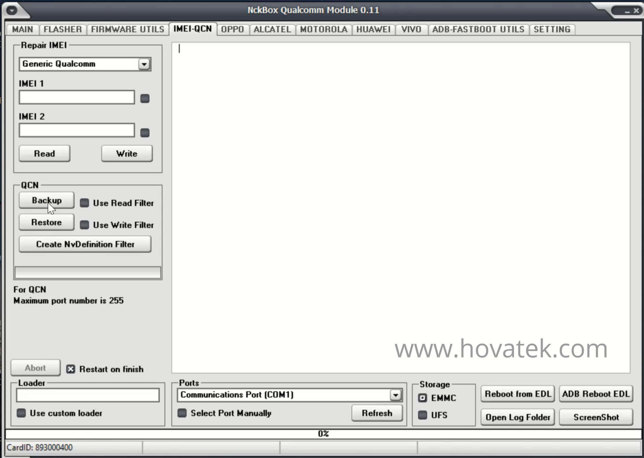

  7. Under QCN, click Backup
    [Image: How-to-backup-dump-a-Qualcomm-Android-ph...-Box-7.jpg]
