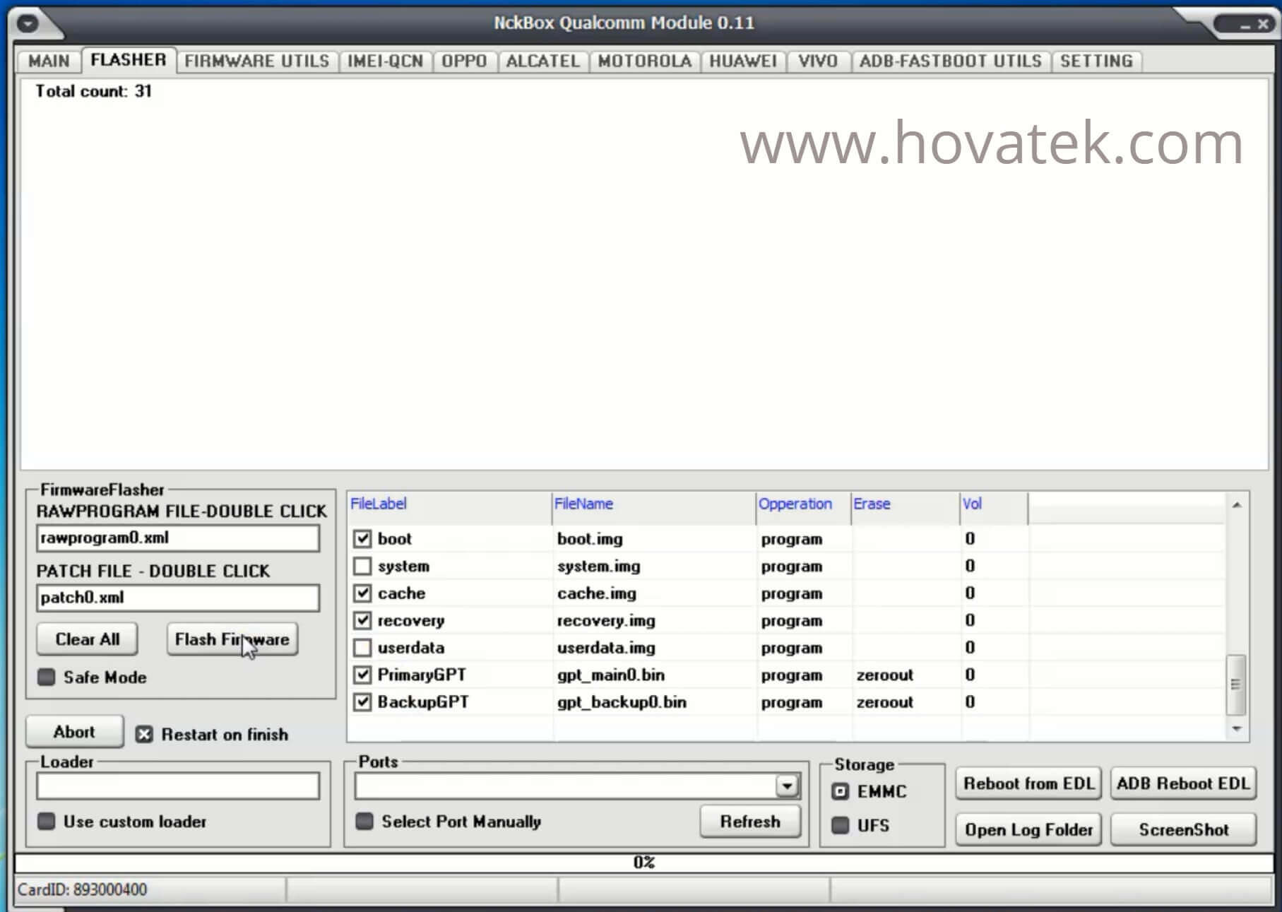

  6. You may untick any partition you do not wish to flash or just leave all ticked to flash all
    [Image: How-to-flash-a-Qualcomm-Android-phones-f...-Box-6.jpg]

Quote:In this video tutorial, I'll be explaining how to flash a Qualcomm Android phone using NCK box. You need to have the hardware box and set it up. We have a guide on how to do that. You need to also install your Qualcomm drivers, we also have a guide for that. You need to download & install the NCK box Qualcomm module setup, this is it right here. You also need to have the firmware which you want to flash to your phone. I'm going to show you a preview of what it looks like. Alright! Great! Now, once you have all these in place, launch the NCK box Qualcomm module and wait for it to come up. This is the dashboard. Click on the FLASHER tab [resizing]
Now, double-click this RAWPROGRAM field. In this window that pops up, navigate to the folder where you have your firmware and you select the rawprogram() XML file and click Open. That is going to load all the available files from the firmware. You can untick any file you don't intend to flash. It really depends on you. I'm going to untick heavy files to make the flashing process much faster. You can leave everything ticked if you want but I want to speed up this flashing so I'll just untick system because its a very heavy partition, and userdata. Once you've done this, what you'll want to do is to click Flash Firmware.
