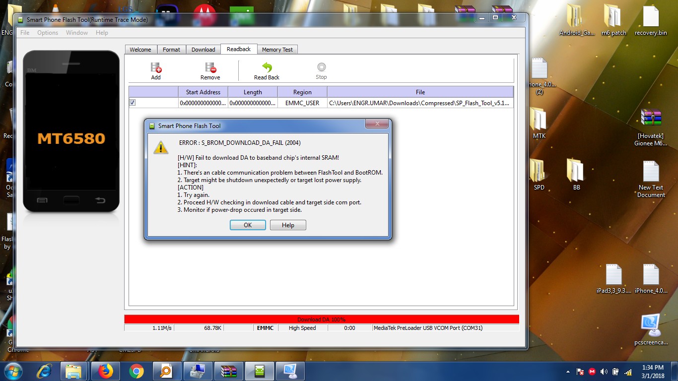

01-03-2018, 01:39 PM
(27-02-2018, 07:00 PM)X3non
(27-02-2018, 03:51 PM)umfah its mt6580 android version 7.0. but it has a secure boot
attempt generating a full scatter file using the method @ https://www.hovatek.com/forum/thread-21970.html
if successful, then remove FRP using the SPft method @ https://www.hovatek.com/forum/thread-12794.html
read back error
01-03-2018, 03:54 PM
(01-03-2018, 01:39 PM)umfah read back error
try the fixes for that error listed @ https://www.hovatek.com/forum/thread-439.html
