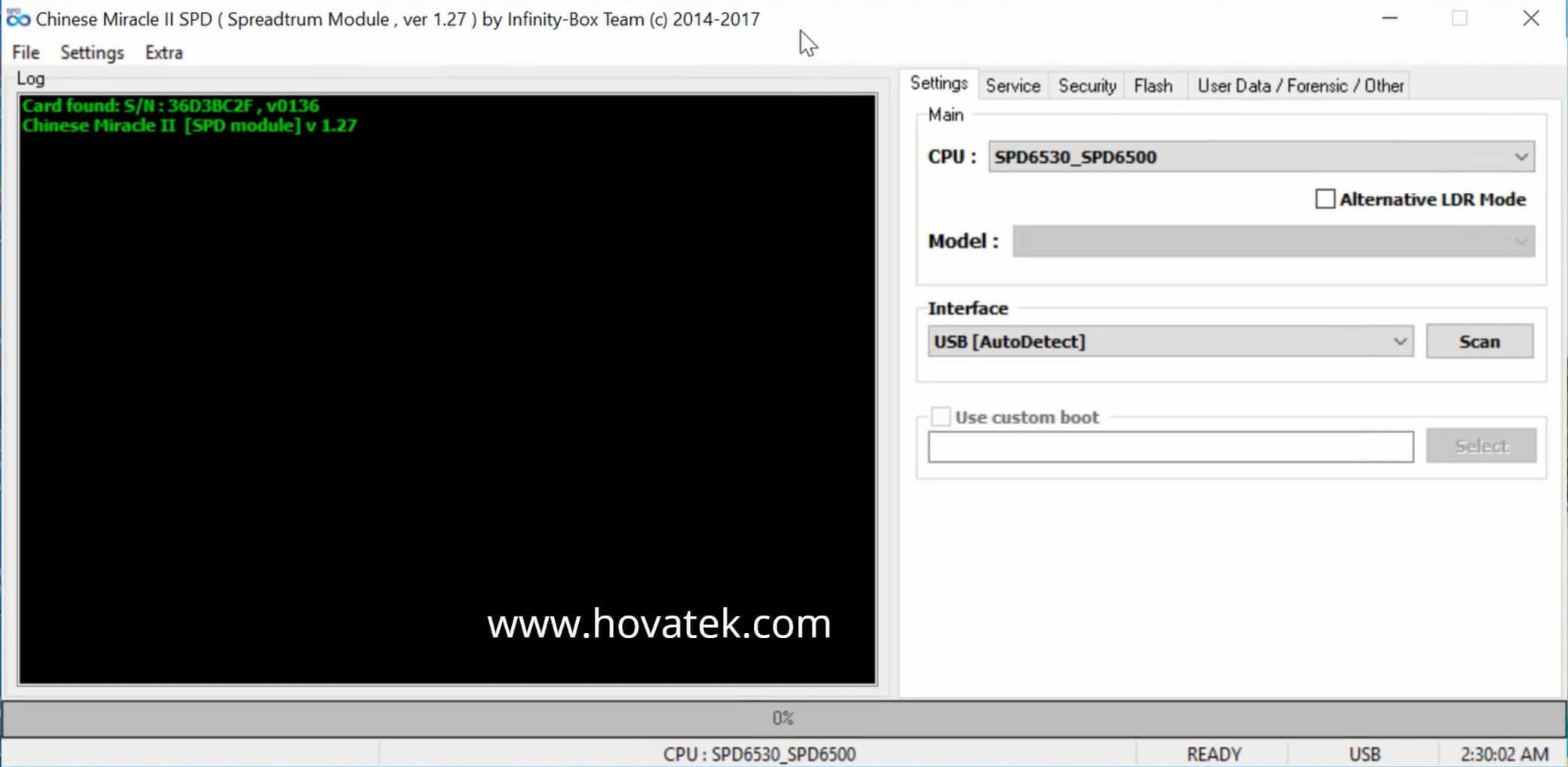

  1. Launch Infinity CM2SPD
    [Image: How-to-write-IMEI-Bluetooth-MAC-address-...2SPD-1.jpg]

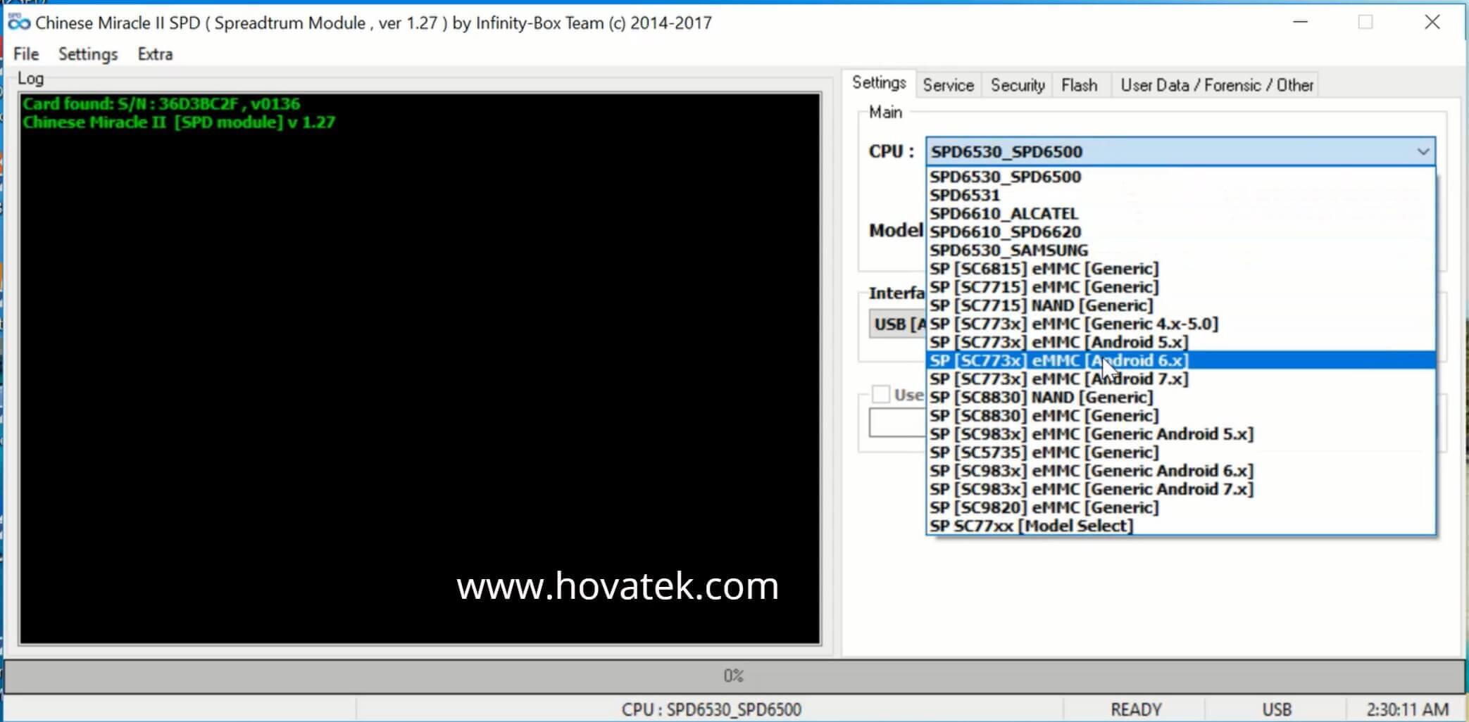

  2. Under Settings > CPU , select the phone's chipset (refer to https://www.hovatek.com/forum/thread-13054.html )
    [Image: How-to-write-IMEI-Bluetooth-MAC-address-...2SPD-2.jpg]

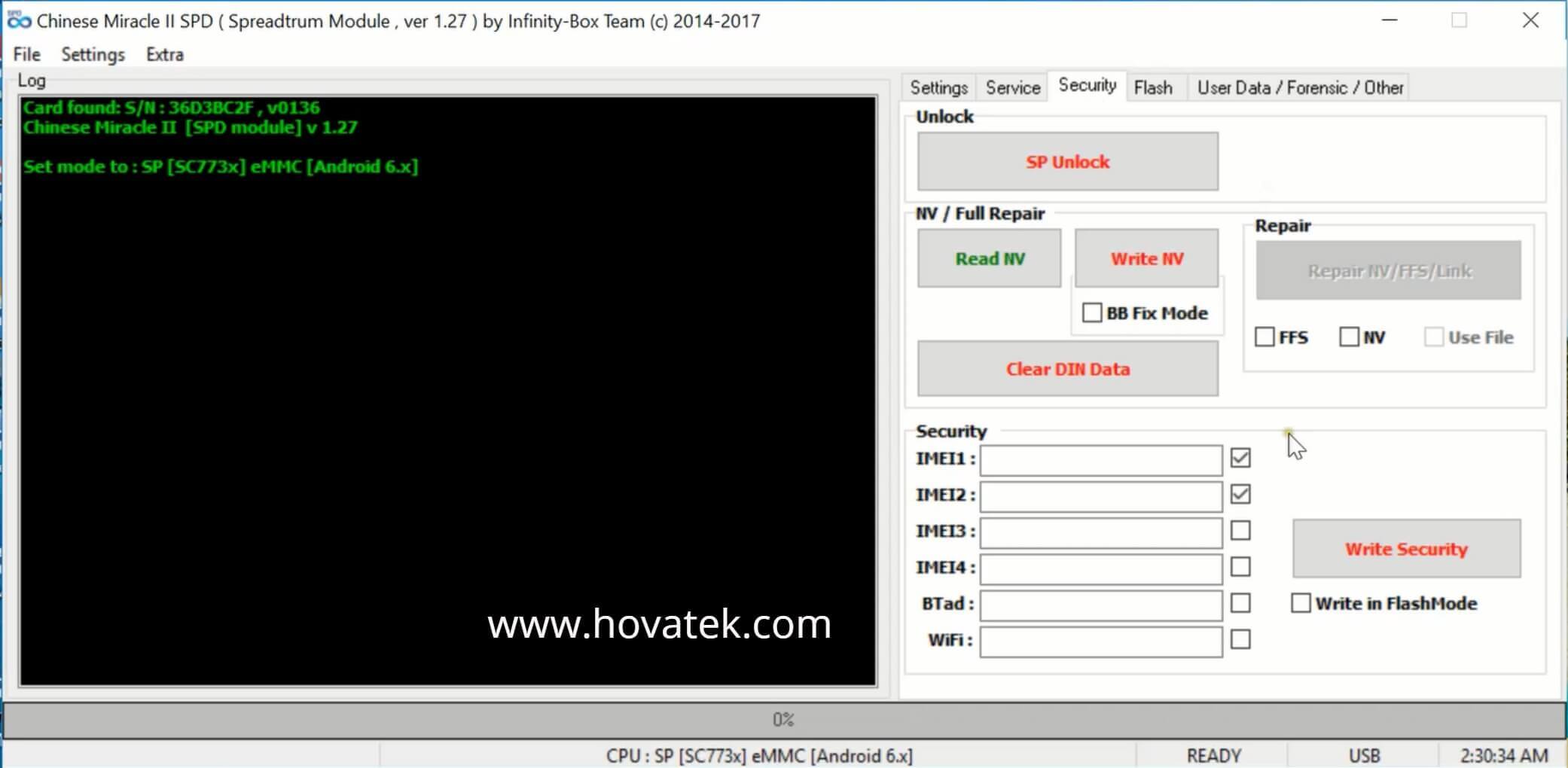

  3. Click the Security tab
    [Image: How-to-write-IMEI-Bluetooth-MAC-address-...2SPD-3.jpg]

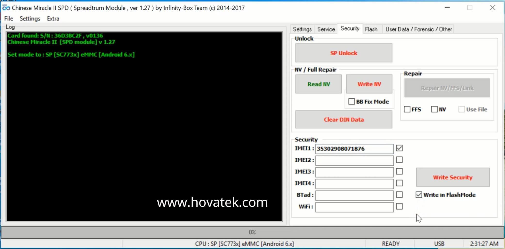

  5. Tick Write in FlashMode
    [Image: How-to-write-IMEI-Bluetooth-MAC-address-...2SPD-5.jpg]
  6. Click Write Security
    [Image: How-to-write-IMEI-Bluetooth-MAC-address-...2SPD-6.jpg]

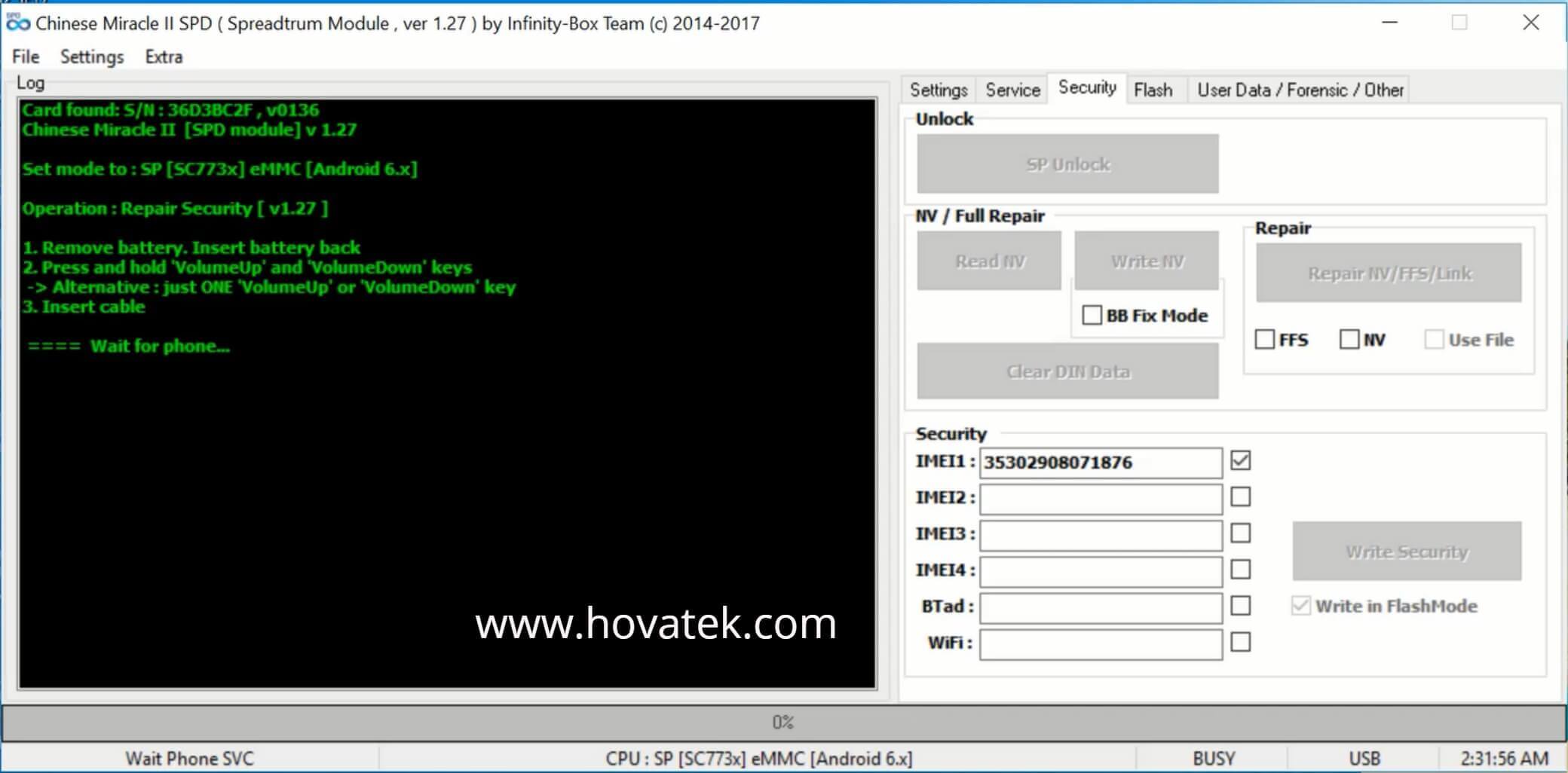

  7. Once the tool shows ====Wait for phone... , power off the device (with battery inserted) hold the Volume down button then connect to the PC via a USB cord
    [Image: How-to-write-IMEI-Bluetooth-MAC-address-...2SPD-7.jpg]

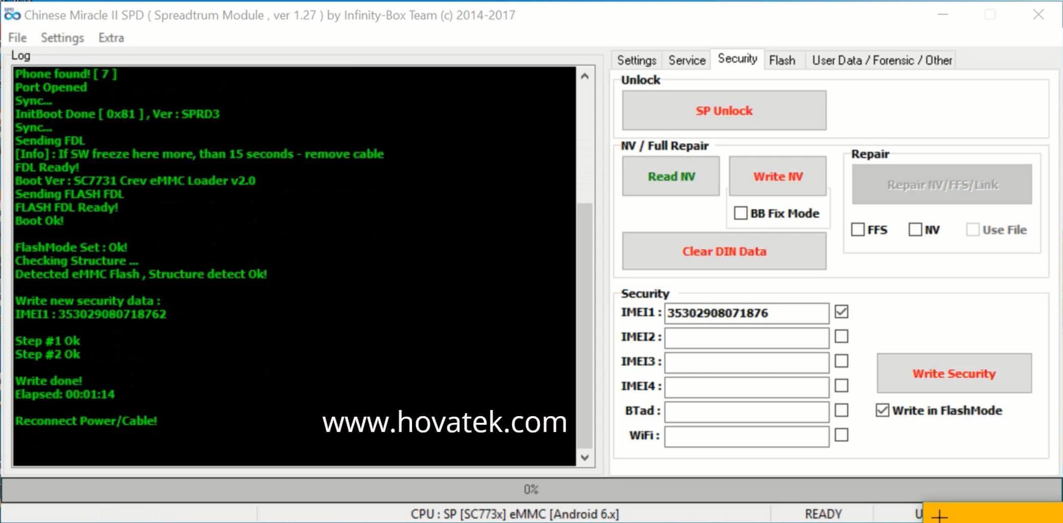

  9. Once the IMEI / Bluetooth / MAC or WiFi address has been successfully written, you should get a Done message
    [Image: How-to-write-IMEI-Bluetooth-MAC-address-...2SPD-9.jpg]
