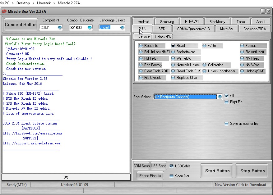

  1. Extract the content of the Miracle Box to your desktop. Open the folder and run "Miracle_Loader_2.27A" (if you're using 2.27a+loader) or just the Miracle_box.exe
    [Image: Hovatek-How-to-bypass-privacy-protection...-Box-7.jpg]
  2. Click on the MTK tab

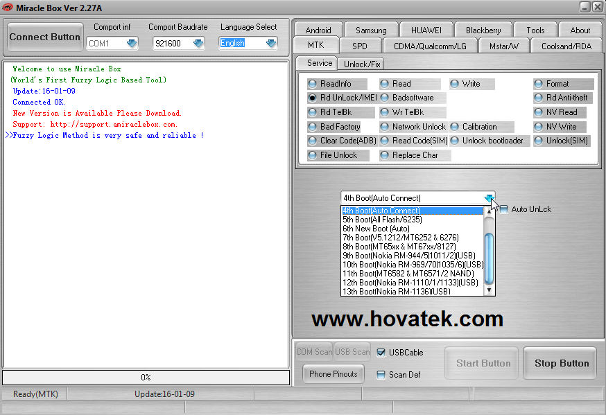

  3. Click on Rd UnLock / IMEI
    [Image: how-to-read-unlock-code-feature-phone-1.png]
  4. Click the dropdown box and select your chipset type MT**** , if you don't know the chip type just leave it in 4th Boot(Auto Connect)
