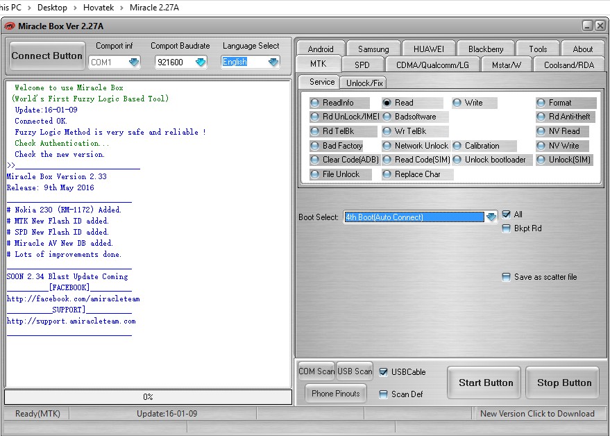

  1. Extract the content of the Miracle Box to your desktop. Open the folder and run "Miracle_Loader_2.27A"
    [Image: Hovatek-How-to-bypass-privacy-protection...-Box-7.jpg]
  2. Wait till the Miracle Box program is launched
    [Image: Hovatek-How-to-bypass-privacy-protection...-Box-1.jpg]
  3. Click on the MTK tab
    [Image: Hovatek-How-to-bypass-privacy-protection...-Box-2.jpg]

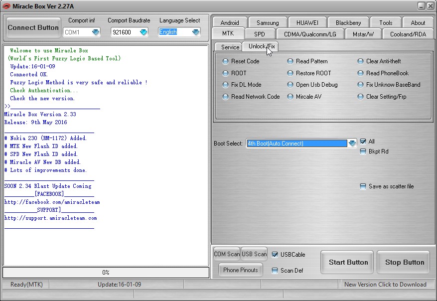

  4. Click on the Unlock / Fix tab
    [Image: Hovatek-How-to-bypass-privacy-protection...-Box-3.jpg]

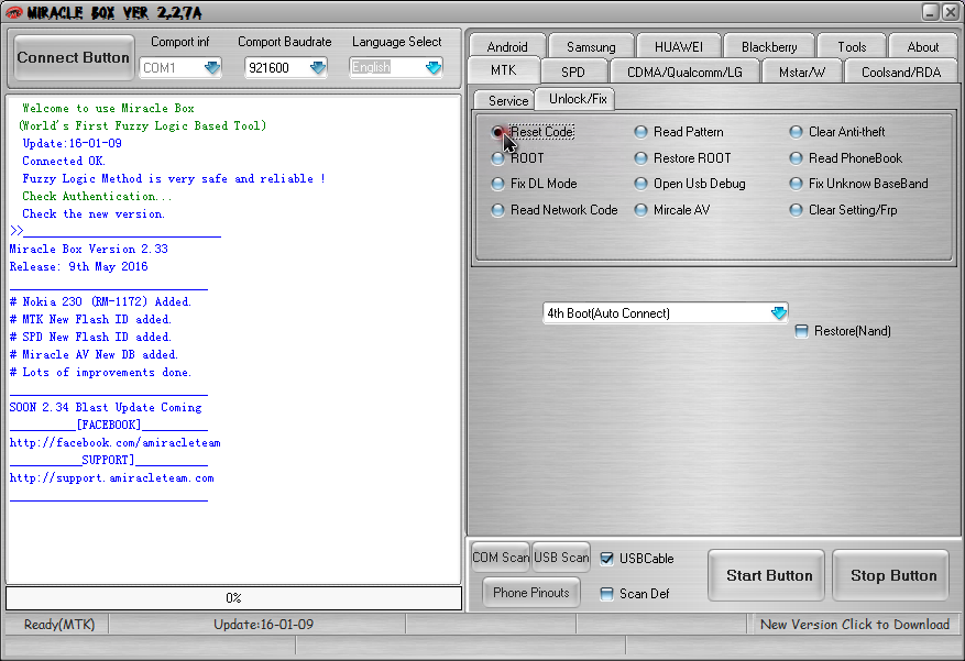

  5. Tick Reset Code
    [Image: How-to-remove-bypass-Pattern-Pin-or-Pass...-Box-1.png]

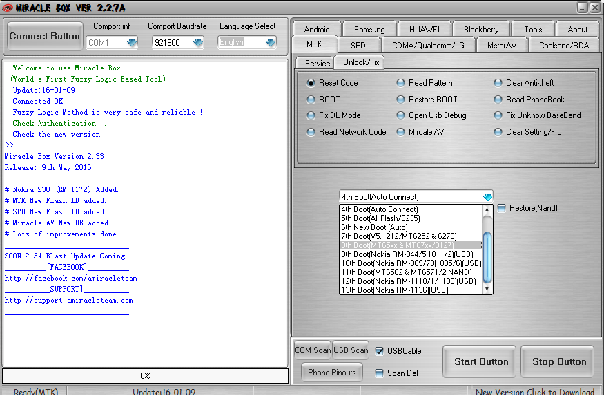

  6. Click the dropdown box and select your chipset type MT****
    [Image: How-to-remove-bypass-Pattern-Pin-or-Pass...-Box-2.png]

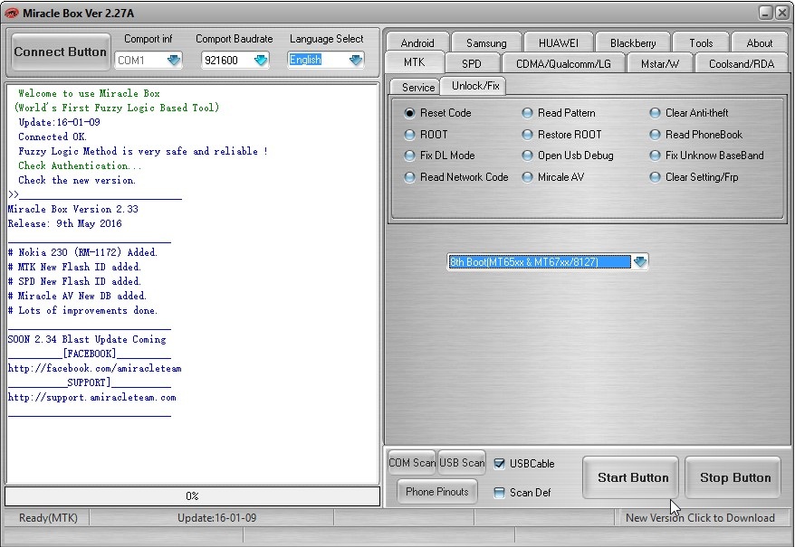

  7. Click the Start Button
    [Image: How-to-remove-bypass-Pattern-Pin-or-Pass...-Box-3.jpg]

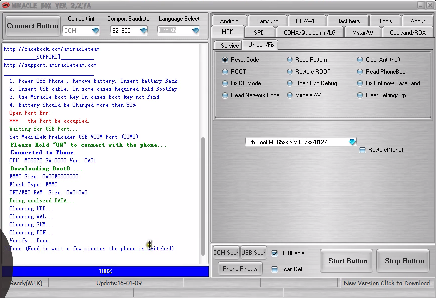

  10. Wait for the message ">>Done. (Need to wait a few minutes the phone is switched)"
    [Image: How-to-remove-bypass-Pattern-Pin-or-Pass...-Box-4.png]
