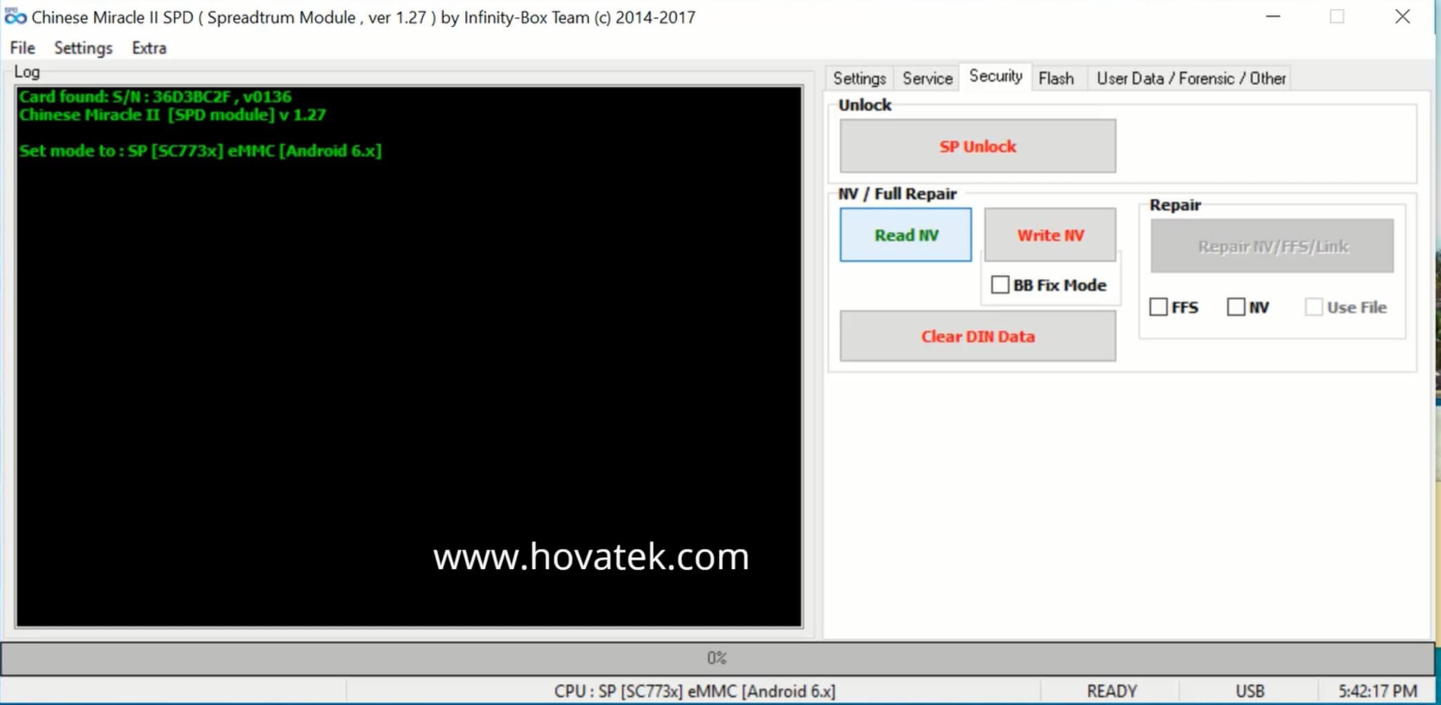

  1. Click Read NV
    [Image: How-to-backup-restore-NV-on-a-Spreadtrum...-SPD-4.jpg]

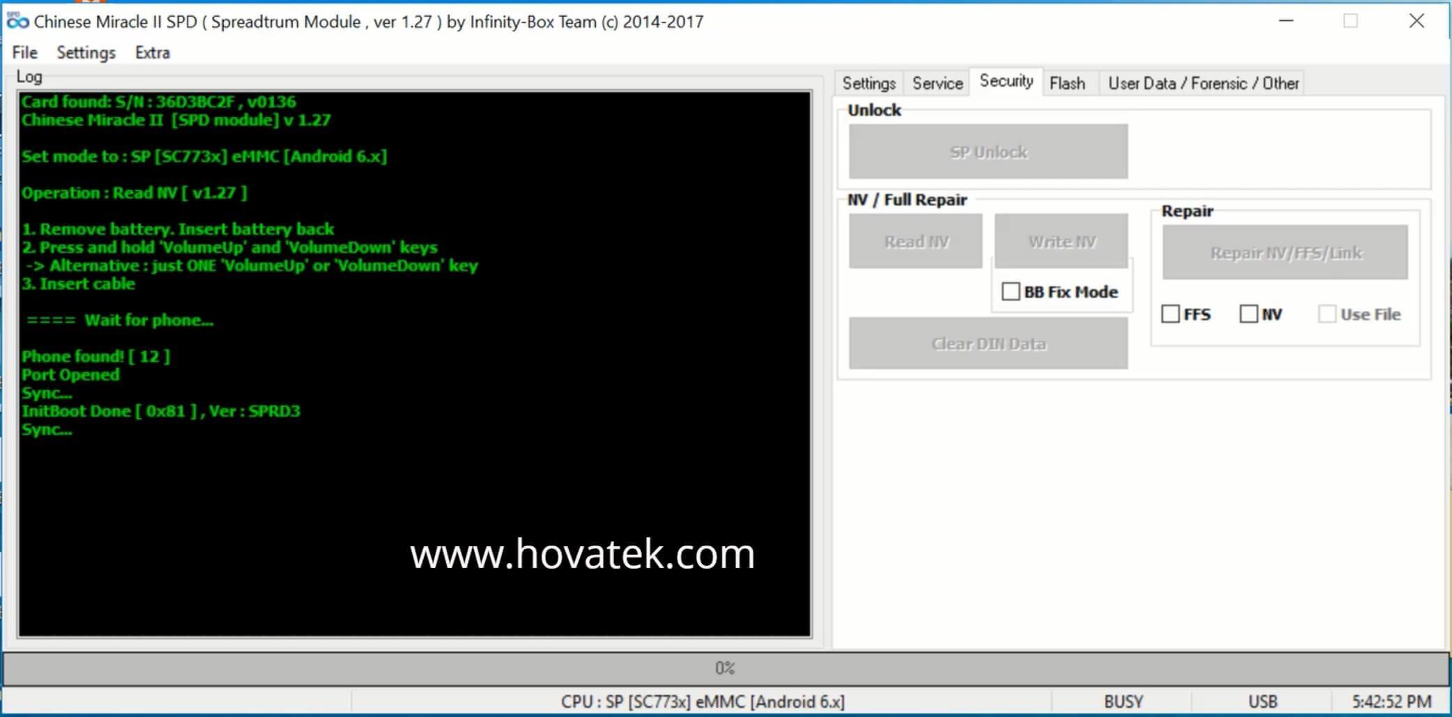

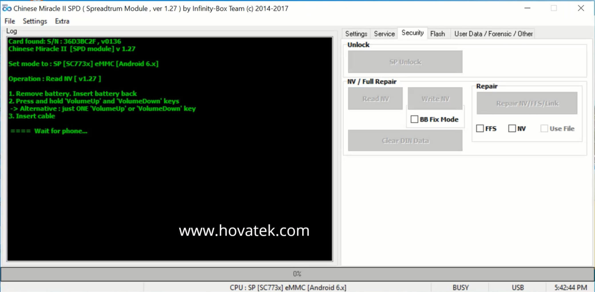

  2. Once you see ====Wait for phone..., power off the phone without NV issues (still with battery in it), hold the volume down button then connect to the PC via a USB cord
    [Image: How-to-backup-restore-NV-on-a-Spreadtrum...-SPD-5.jpg]
  3. The phone should get detected
    [Image: How-to-backup-restore-NV-on-a-Spreadtrum...-SPD-6.jpg]

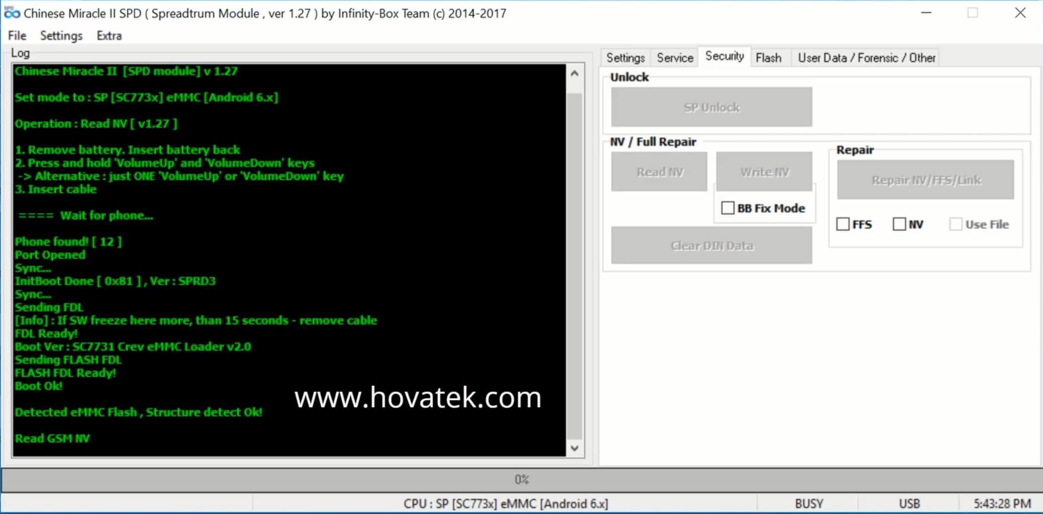

  4. CM2 SPD should start reading the phone's NV
    [Image: How-to-backup-restore-NV-on-a-Spreadtrum...-SPD-7.jpg]

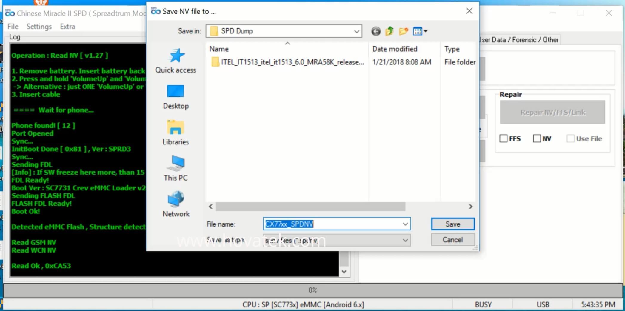

  5. In the Window that pops up, navigate to the location you wish to save the NV then click Save
    [Image: How-to-backup-restore-NV-on-a-Spreadtrum...-SPD-8.jpg]

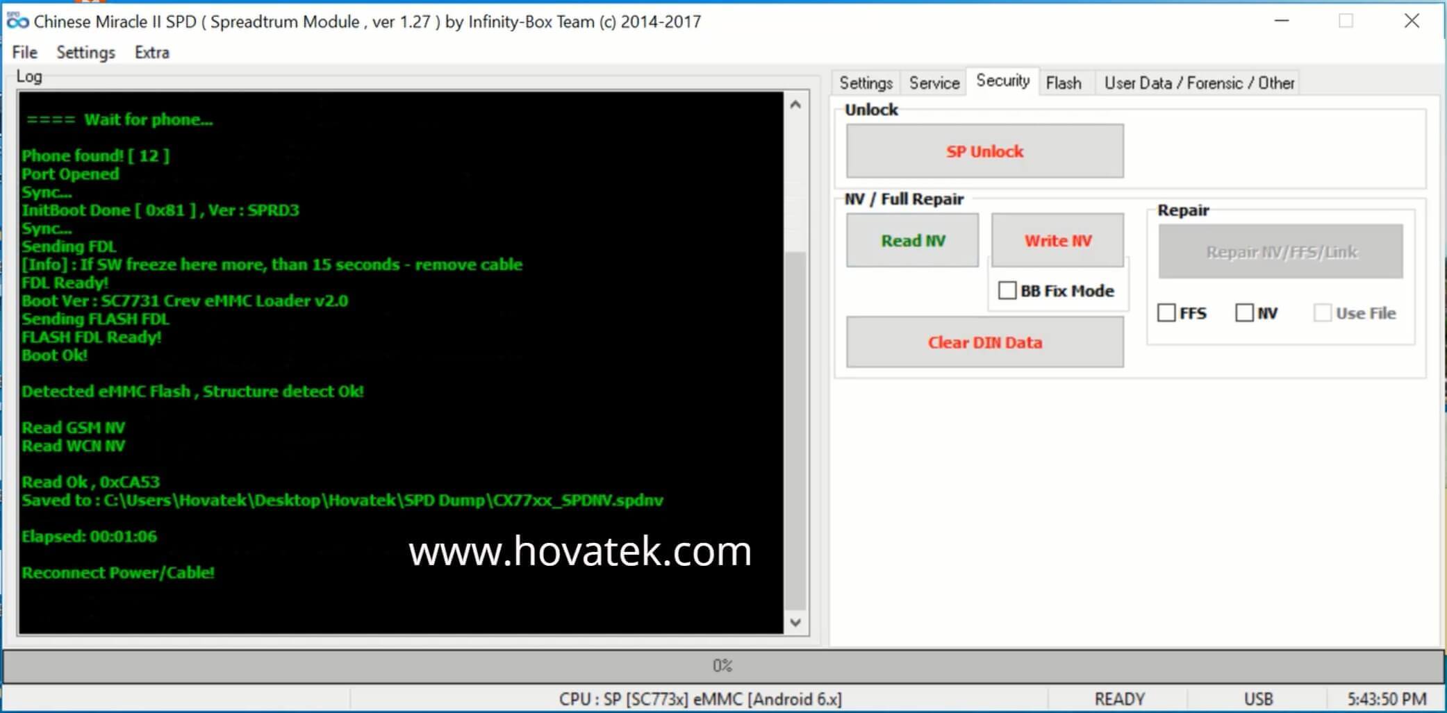

  6. You should get a Done message once NV backup is complete (the file is usually named something like Cxxxxx_SPDNV.spdnv )
    [Image: How-to-backup-restore-NV-on-a-Spreadtrum...-SPD-9.jpg]

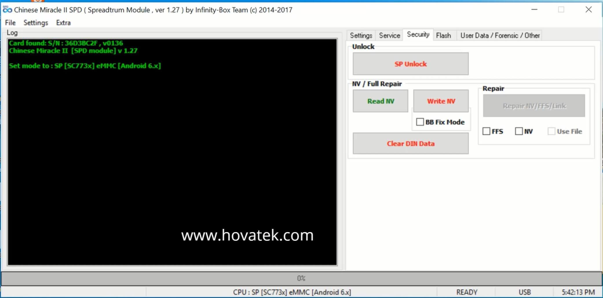

  1. Still under Security, tick BB Fix Mode (to repair Baseband) then click Write NV
    [Image: How-to-backup-restore-NV-on-a-Spreadtrum...SPD-10.jpg]

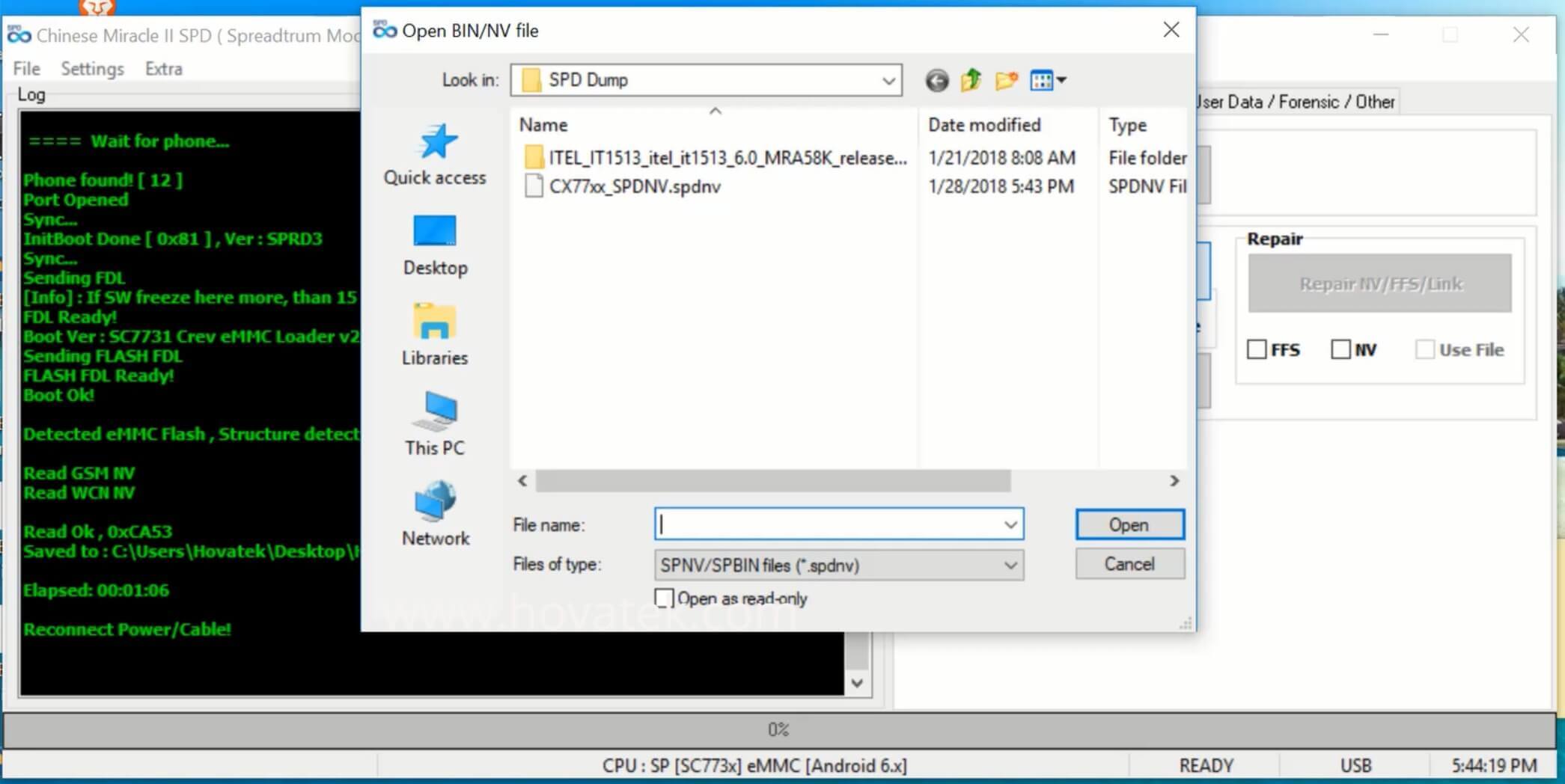

  2. In the Window that pops up, navigate to the location of the NV file (SPDNV.spdnv) , highlight it then click Open
    [Image: How-to-backup-restore-NV-on-a-Spreadtrum...SPD-11.jpg]

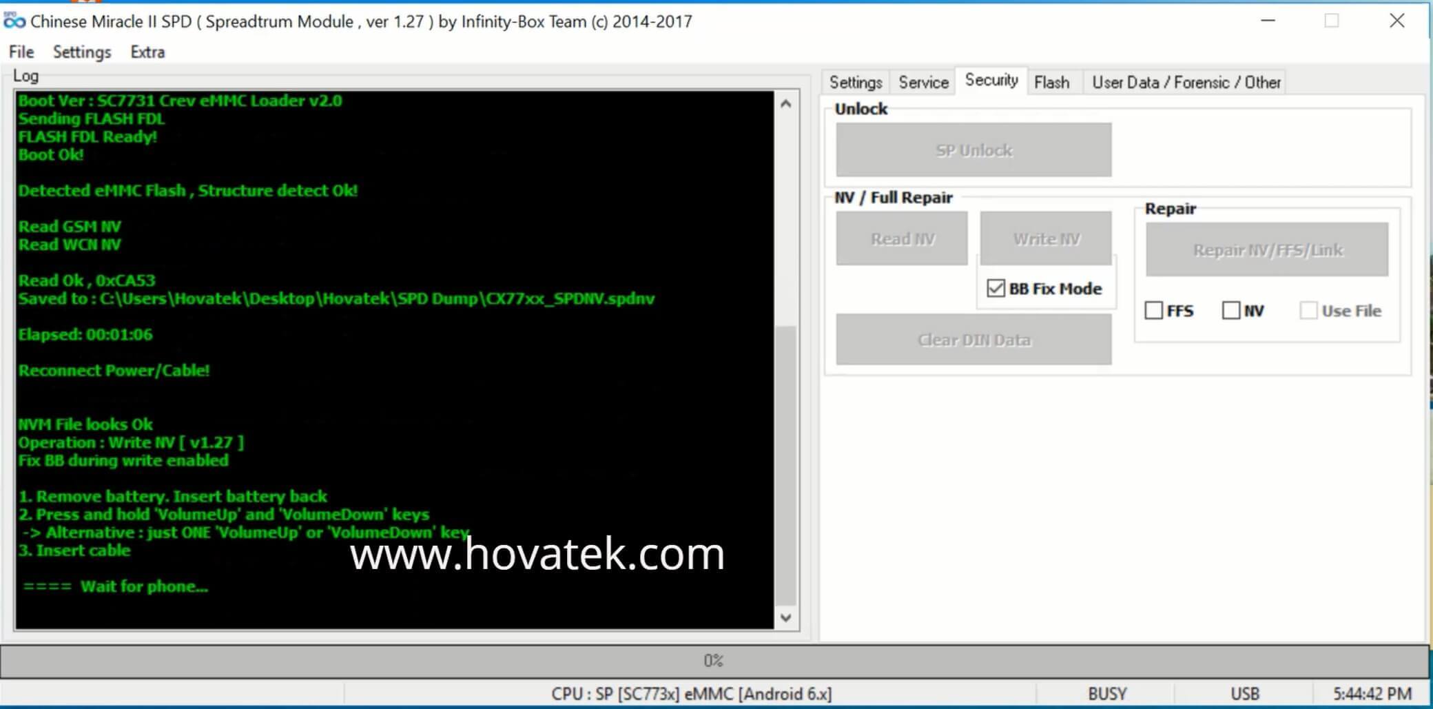

  3. Once you see ====Wait for phone..., power off the phone having NV issues (still with battery in it), hold the volume down button then connect to the PC via a USB cord
    [Image: How-to-backup-restore-NV-on-a-Spreadtrum...SPD-12.jpg]

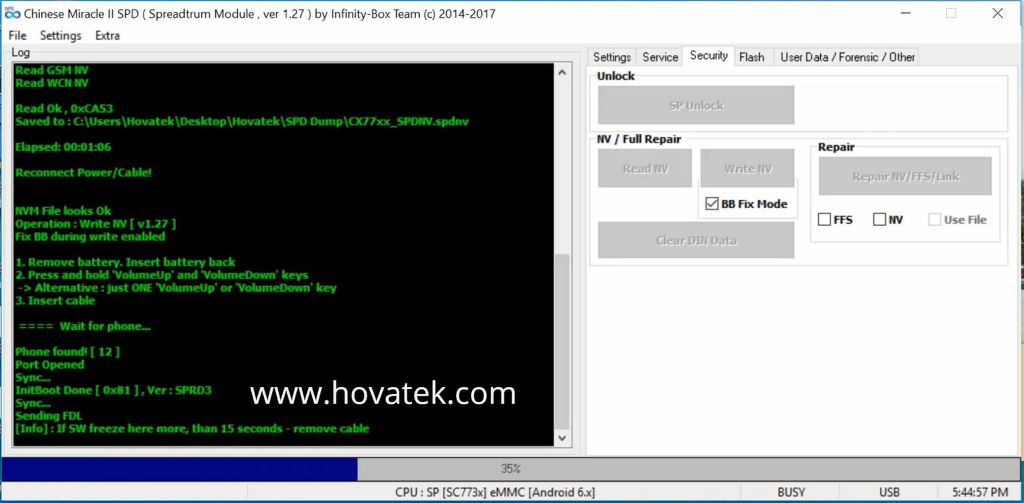

  4. The device should get detected
    [Image: How-to-backup-restore-NV-on-a-Spreadtrum...SPD-13.jpg]

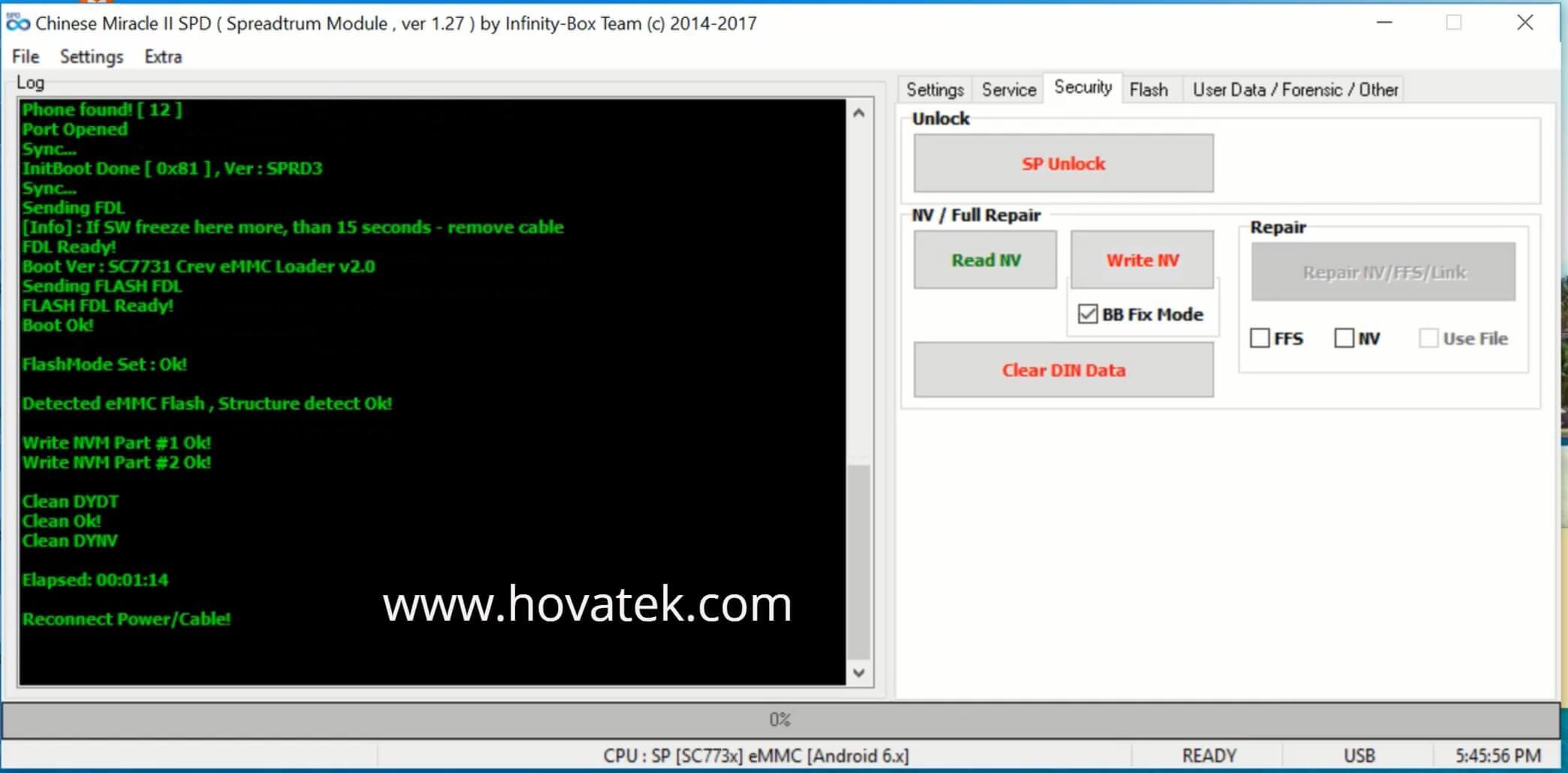

  5. CM2 SPD should start restoring the NV to the phone
    [Image: How-to-backup-restore-NV-on-a-Spreadtrum...SPD-14.jpg]
  6. You should get a done message once restore is complete
    [Image: How-to-backup-restore-NV-on-a-Spreadtrum...SPD-15.jpg]

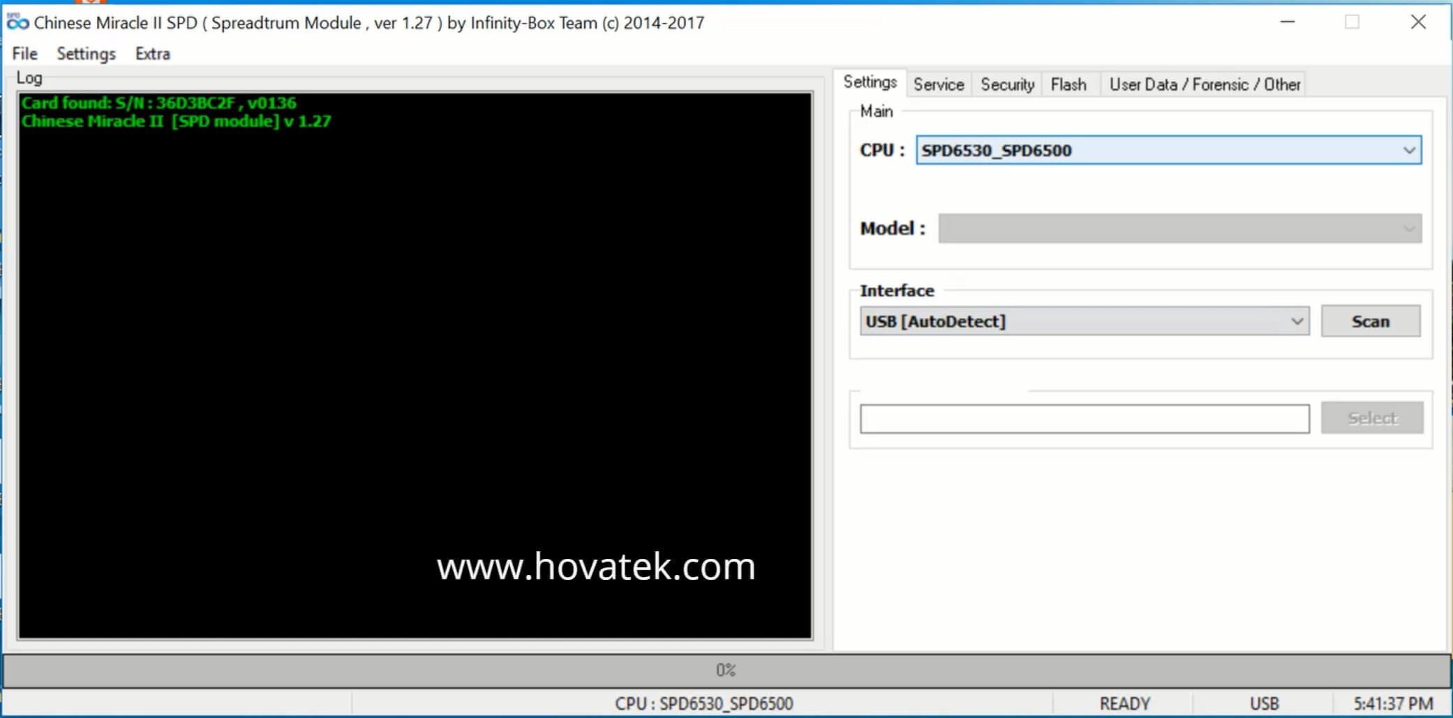

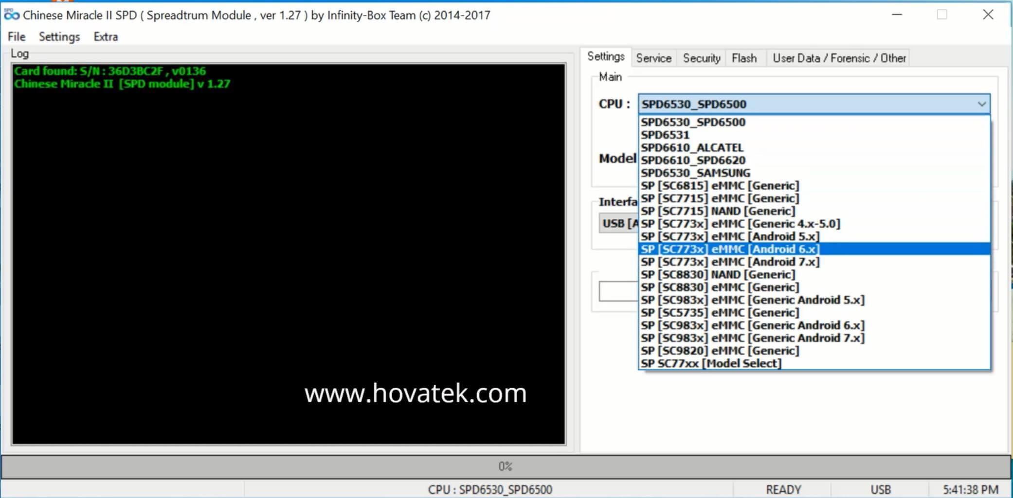

Quote:In this video tutorial, I'll be explaining how to backup a Spreadtrum Android phone's NV using Infinity CM2 SPD. Its very important you've set it up, installed your Spreadtrum drivers and have the dongle connected to your PC. Once you've done these, launch the Infinity box CM2 SPD module. and wait for the dashboard to come up. Once it comes up, under Settings - CPU, select your phone's chipset. We have a guide on how to identify your phone's chipset so check it out.
