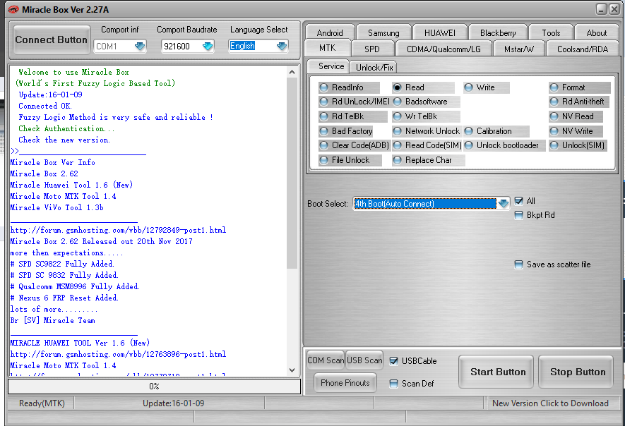

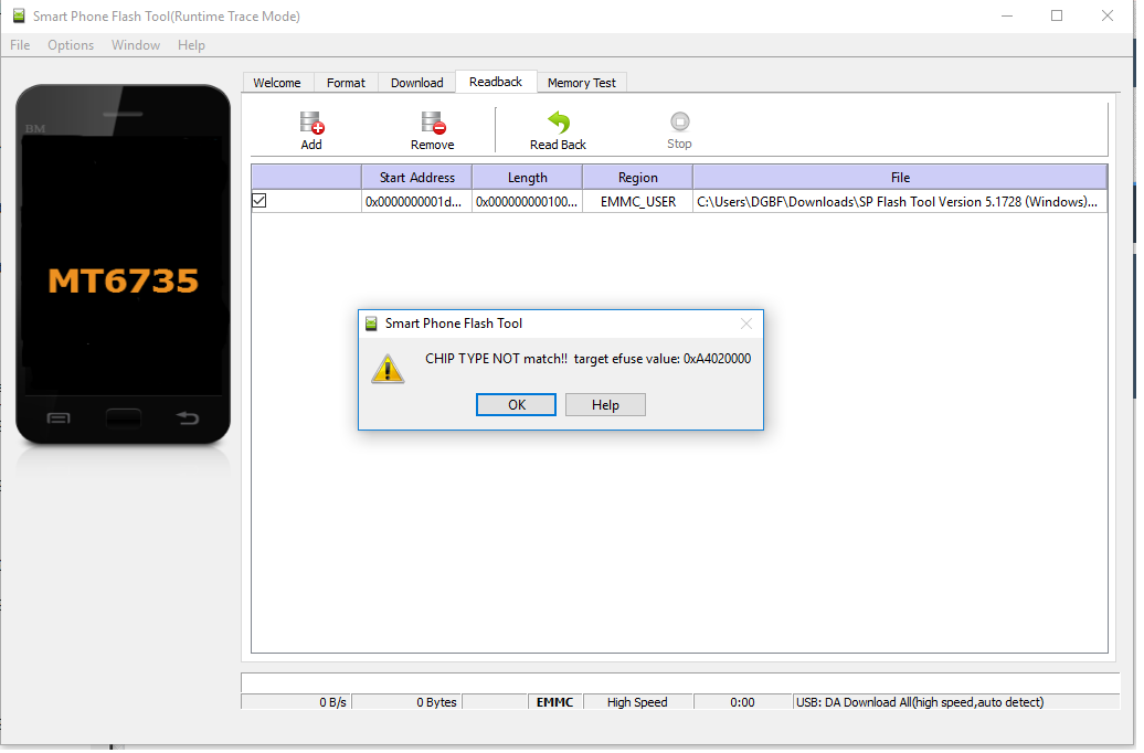

22-11-2017, 01:41 AM
#14
[attachment=4372 hovatek pid='124407' dateline='1511279801']
(21-11-2017, 02:01 PM)ThePunisher Yeah, it can. I unlocked the bootloader with "fastboot oem unlock", so it should be fine.
Download the scatter file for your chipset @ [REMOVED]
Follow the guide @[REMOVED] and readback only boot.img and recovery.img
Skip the MTK Droid tools part since you already have a scatter file.
The start and length values you need can be obtained from the scatter file
physical_start_addr is the start
partition_size is the length
Let me know how it goes
Couldn't do it... Error 5054, Obtain DRAM failed!
Tried on two computers, two cables and several different USB ports...
Crap, I really don't want to be stuck with an unrootable phone...
I really appreciate your patience.

22-11-2017, 11:04 AM
#15
(22-11-2017, 01:41 AM)ThePunisher Couldn't do it... Error 5054, Obtain DRAM failed!
You must have downloaded the wrong scatter file.
Which scatter file did you download?

22-11-2017, 09:17 PM
#18
(22-11-2017, 06:27 PM)hovatek
(22-11-2017, 01:09 PM)ThePunisher MT6737M_Android_scatter.zip
Which I believe is correct.
Check your comment at [REMOVED, I still can't post links.] . I see MT6735
I don't know why Miracle Box thought it's MT6735, but I downloaded that scatter and tried.
The result was:
CHIP TYPE NOT match!! target efuse value: 0xA4020000
Which means it's probably not 6735.
From getvar all:
(bootloader)    max-download-size: 0x8000000 (bootloader)    partition-size:flashinfo: 1000000 (bootloader)    partition-type:flashinfo: raw data (bootloader)    partition-size:userdata: 32000000 (bootloader)    partition-type:userdata: ext4 (bootloader)    partition-size:cache: 19000000 (bootloader)    partition-type:cache: ext4 (bootloader)    partition-size:system: c8000000 (bootloader)    partition-type:system: ext4 (bootloader)    partition-size:metadata: 2500000 (bootloader)    partition-type:metadata: raw data (bootloader)    partition-size:nvdata: 2000000 (bootloader)    partition-type:nvdata: ext4 (bootloader)    partition-size:frp: 100000 (bootloader)    partition-type:frp: raw data (bootloader)    partition-size:tee2: 500000 (bootloader)    partition-type:tee2: raw data (bootloader)    partition-size:tee1: 500000 (bootloader)    partition-type:tee1: raw data (bootloader)    partition-size:keystore: 800000 (bootloader)    partition-type:keystore: raw data (bootloader)    partition-size:secro: 600000 (bootloader)    partition-type:secro: raw data (bootloader)    partition-size:oemkeystore: 200000 (bootloader)    partition-type:oemkeystore: raw data (bootloader)    partition-size:seccfg: 80000 (bootloader)    partition-type:seccfg: raw data (bootloader)    partition-size:expdb: a00000 (bootloader)    partition-type:expdb: raw data (bootloader)    partition-size:logo: 800000 (bootloader)    partition-type:logo: raw data (bootloader)    partition-size:recovery: 1000000 (bootloader)    partition-type:recovery: raw data (bootloader)    partition-size:boot: 1000000 (bootloader)    partition-type:boot: raw data (bootloader)    partition-size:para: 80000 (bootloader)    partition-type:para: raw data (bootloader)    partition-size:lk: 80000 (bootloader)    partition-type:lk: raw data (bootloader)    partition-size:protect2: a00000 (bootloader)    partition-type:protect2: ext4 (bootloader)    partition-size:protect1: a00000 (bootloader)    partition-type:protect1: ext4 (bootloader)    partition-size:nvram: 500000 (bootloader)    partition-type:nvram: raw data (bootloader)    partition-size:proinfo: 300000 (bootloader)    partition-type:proinfo: raw data (bootloader)    partition-size:preloader: 40000 (bootloader)    partition-type:preloader: raw data (bootloader)    off-mode-charge: 1 (bootloader)    warranty: no (bootloader)    unlocked: yes (bootloader)    secure: no (bootloader)    kernel: lk (bootloader)    product: HCT6737M_65_N (bootloader)    version-preloader: 0.1.00 (bootloader)    version: 0.5 all: Done!! finished. total time: 0.211s

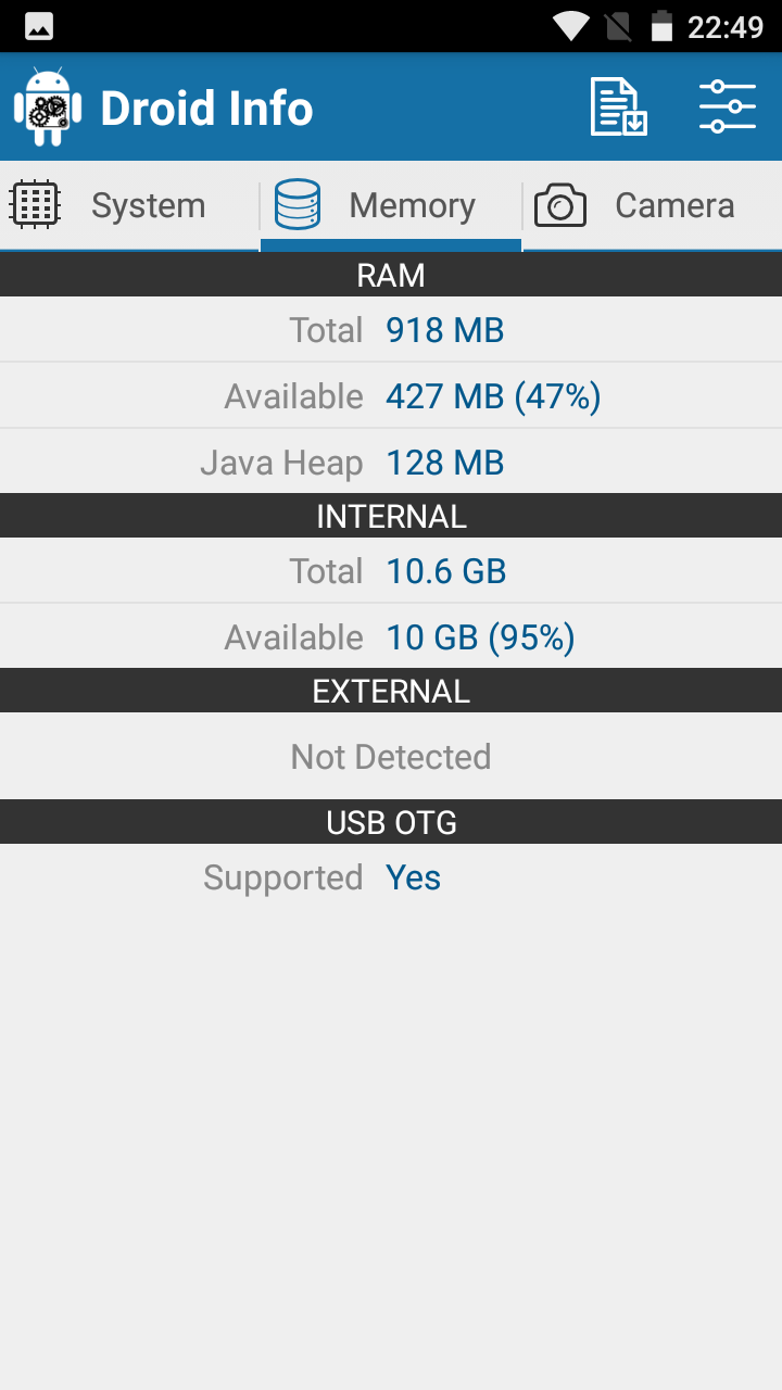

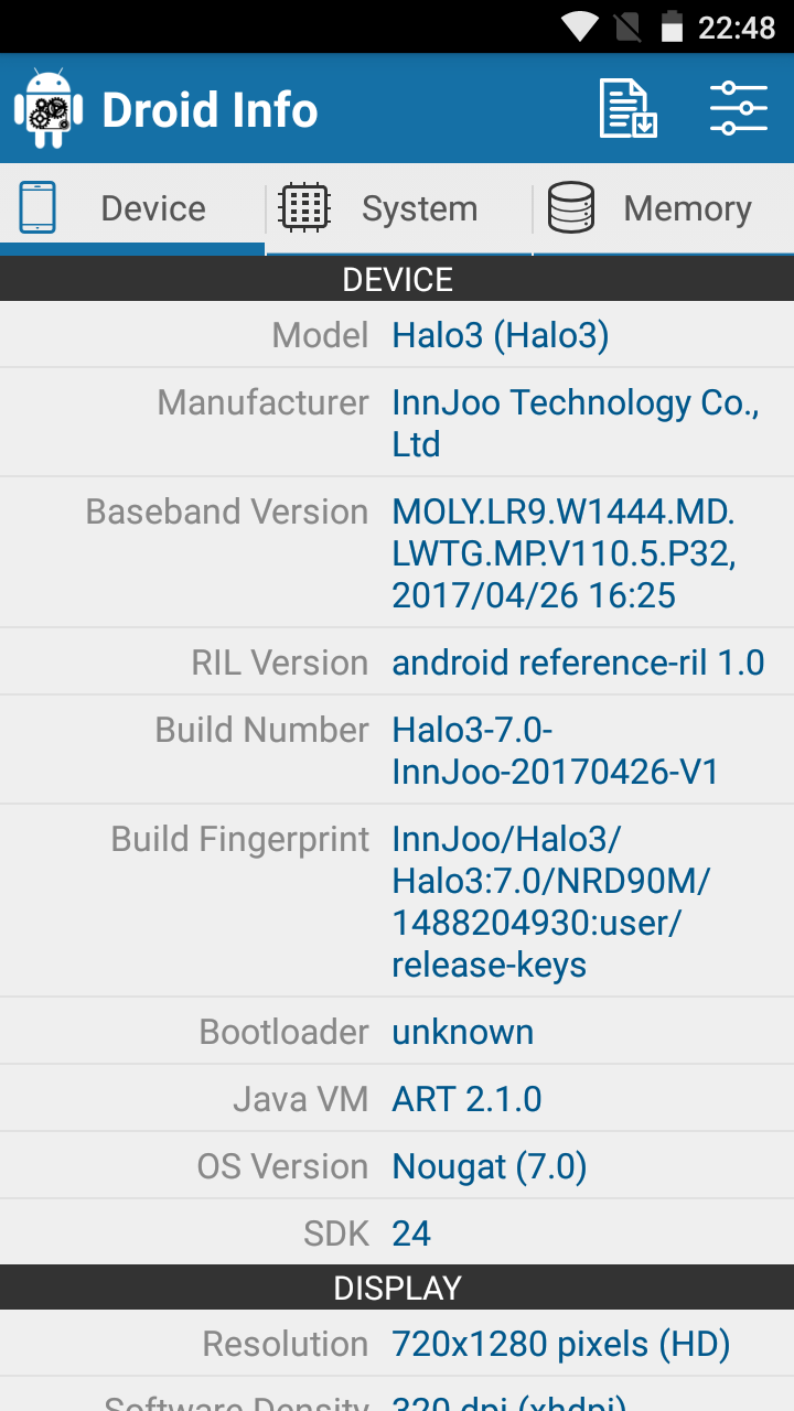

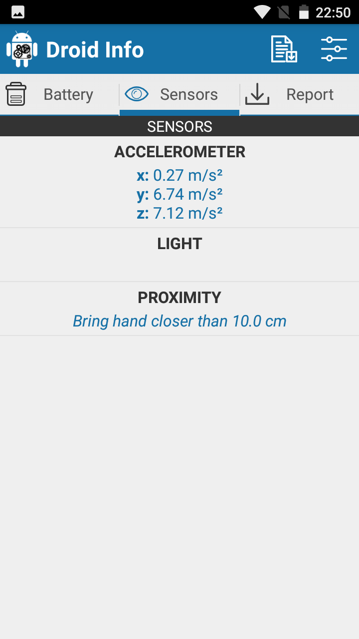

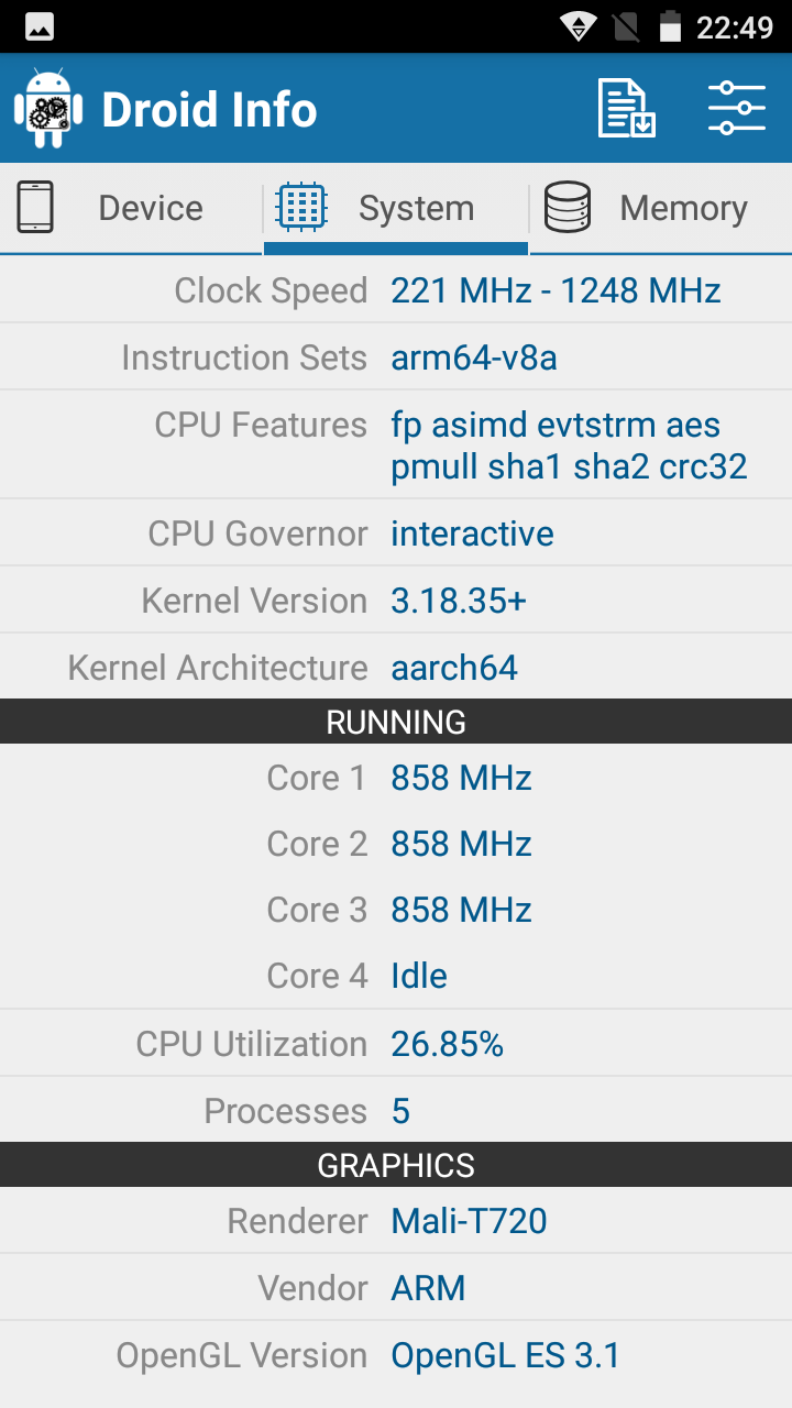

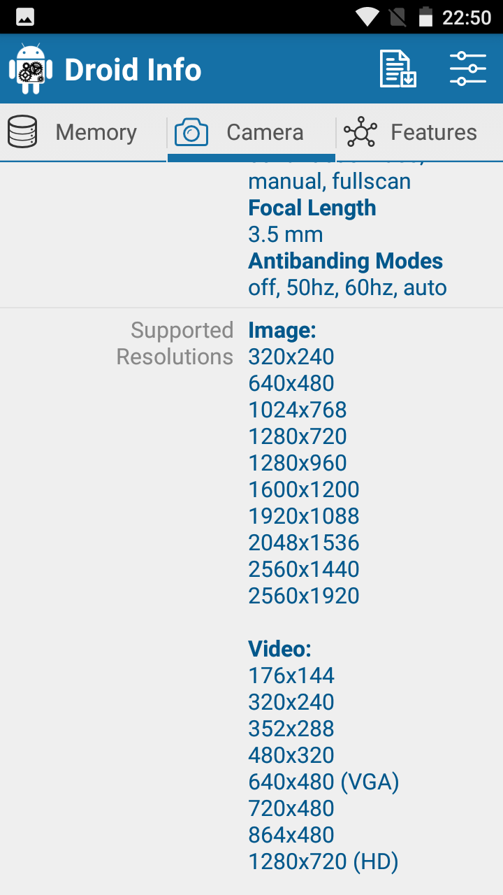

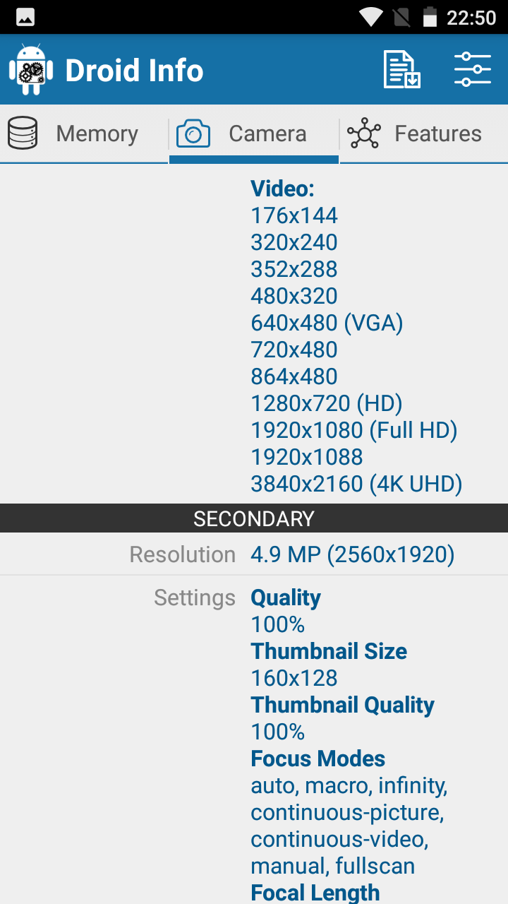

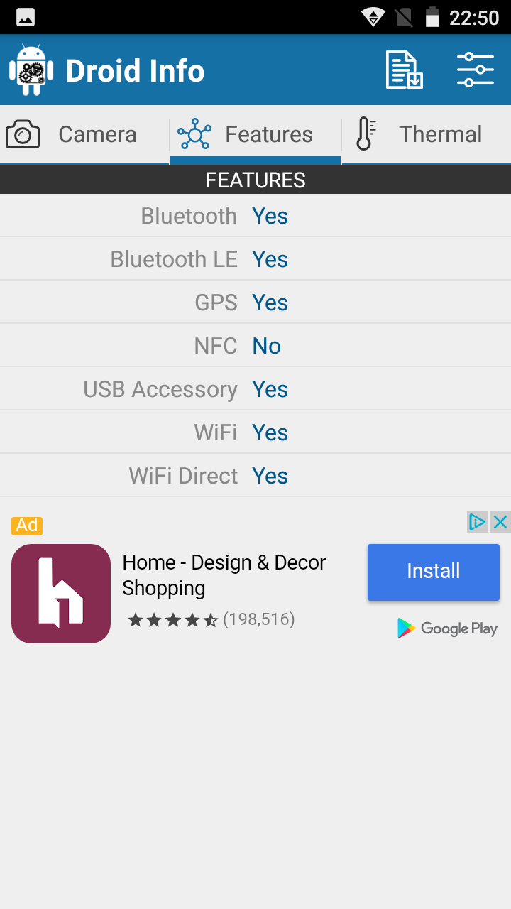

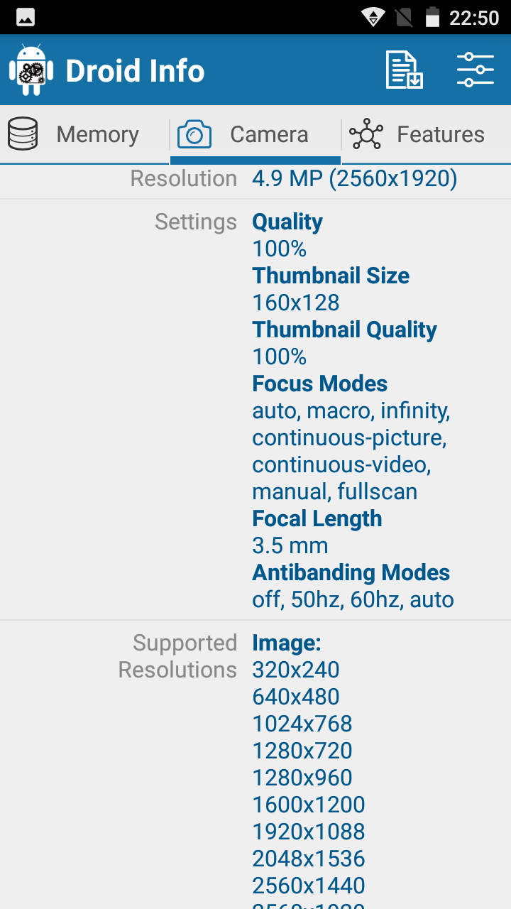

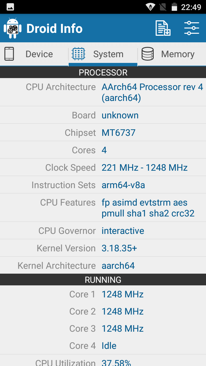

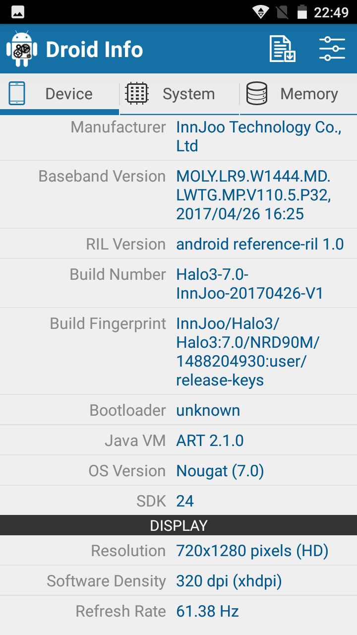

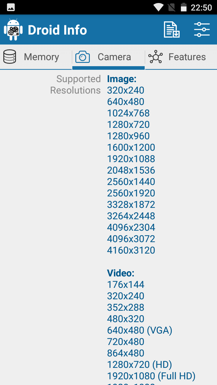

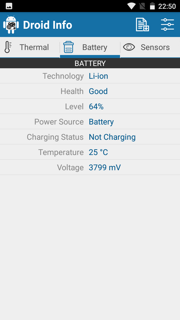

24-11-2017, 08:06 PM
#20
(23-11-2017, 02:44 PM)hovatek
(22-11-2017, 09:17 PM)ThePunisher I don't know why Miracle Box thought it's MT6735, but I downloaded that scatter and tried.
Here's what.
Get your phone's info using the guide @ (still can't post links)
attach screenshots
Done. I took a screenshot of everything, maybe it'll be of use to someone else.
