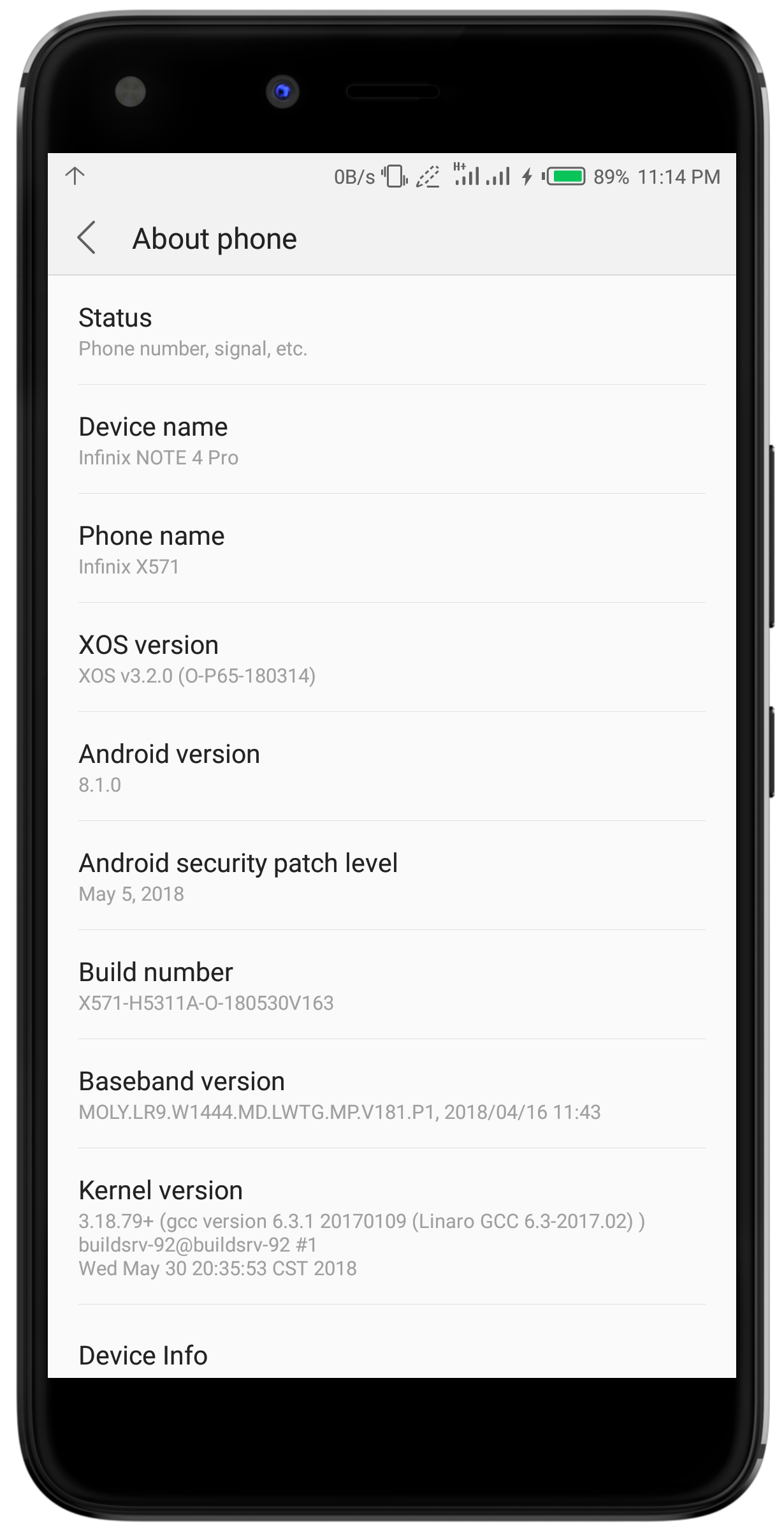

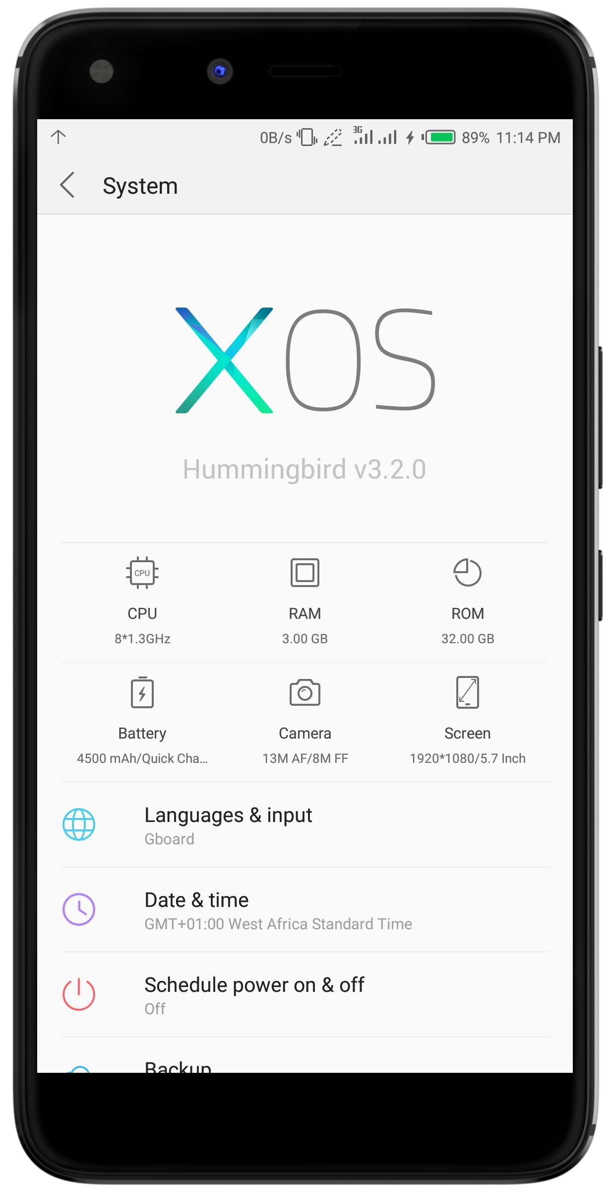

Hello please can i perform this procedure on INFINIX NOTE 4 PRO x571 OREO 8.1

(29-07-2018, 11:19 PM)olu2nde Hello please can i perform this procedure on INFINIX NOTE 4 PRO x571 OREO 8.1
port TWRP using our porting tool at https://www.hovatek.com/forum/thread-21839.html
if you still have any more queries then create a new thread for it
