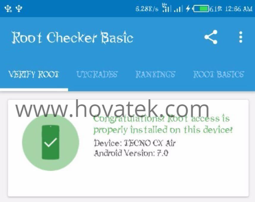

  • Confirm Root by installing and running Root Checker
[Image: Hovatek-How-to-root-Tecno-Camon-CX-Air.jpg]
