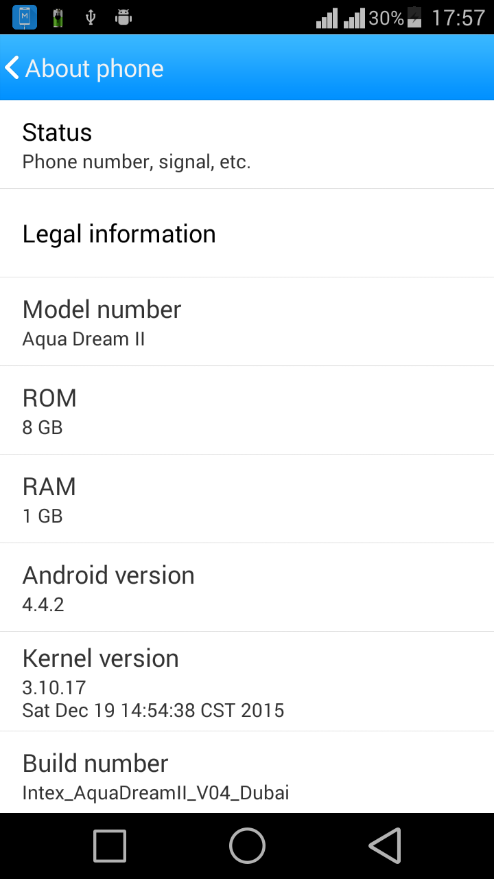

Their is Problem With Intex AquaDream II Kitkat. It Just get half restart i dont why Screen Gets Blue and then after some seconds mobile turns on from main home screen its not restart its only seems like some app gets restarted what is causing this? here is snapshot of battery Graphs . it contains so many Breaks In it. instead of this mbl doesnt gets restart only half restart. and for some time it repeats this process for many times. on restarting mbl it comes to normal working again
[Image: attachment.php?aid=3907]
Here is Detail of the Phone
[Image: attachment.php?aid=3908]
Regards

No Sir Don't Have Stock Firmware for This Device. i have tried to Hard Reset the Device but still same Issue . Why there are Gaps in Battery Graphs? Is there something Wrong with the Battery Bcz of Extensive use of the device even while charging it.

As Shown in the Build Number Its Firmware Name is "Intex_AquaDreamII_V04_Dubai" Will This "Intex_Aqua_Dream_II_V06_Indian_SER.zip" Version Works for the device? and its a pac file so how it will be flashed by using SP Flashtools?

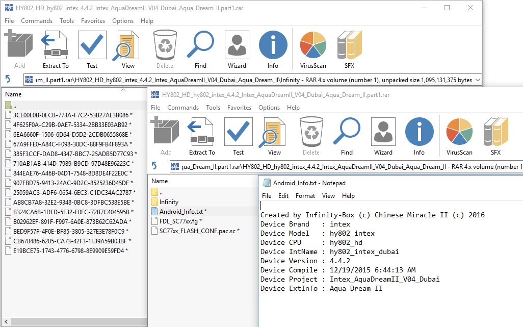

1. Can I see a full screenshot of the contents of the firmware you flashed.
Ans. Original Firmware is not available on the internet its Created by Infinity-Box © Chinese Miracle II © 2016 Firmware.
Here are the contents in the firmware

  on internet on firmware is available its pac extension file i didnt tried that file .
2. Did you flash using firmware upgrade
Ans. No i went to the technician he tries to flash it using Chinese Mircle Box Got success in it but still the same issue
He also tries the other indian firmware "Intex_Aqua_Dream_II_V06_Indian_SER" which was a .pac file through Miracle box but didnt get success. due to errors bcz this firmware was not for my model
