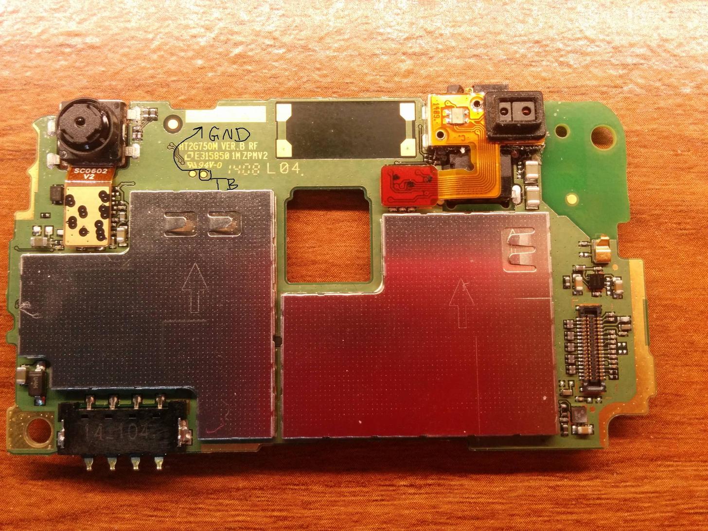

The photos of the back and the front of the PCB are posted here and here.
I tried explaining that I could not locate the colo or kcolo identifiers on the board to help with the test points. Perhaps someone can help me out here?
Thanks

The points aren't labelled . Can you find GND anywhere on the PCB?
I also want to know what happened to the phone and how it behaves when you try flshing

Could you advice me on how to detect a GND (since that also does not seem to be labelled)? I'm going to get a multi-meter later today.
The phone itself was fine. I flashed it a couple of times, but the last flash I got disconnected (physically) during the beginning of the flash and hurt the Pre-loader. This should be my main concern, regain access to the (pre-loader) flashing, isn't that right?

From what you've described, I don't think you need to join PCB mount points just yet (this is ideal for when the phone shows no sign of life at all). Flashing was interrupted and this causes the phone to go dead (check https://www.hovatek.com/forum/thread-808.html for reference )
When you encounter the above symptoms (connect-disconnect) then you need to focus on your drivers. Check this guide @ https://www.hovatek.com/forum/thread-16839.html and also the connection-disconnection fix @ https://www.hovatek.com/forum/thread-439.html . They should help you get a steady connection for flashing

(03-04-2017, 05:02 PM)barthodian ..
Don't know if this image will help

Thank you! I have briefly gone through recovering it without the need of the testpoint without success. I will give it another wing ASAP and if it still don't do the trick, I'll use this last option. Thank you @shigege
