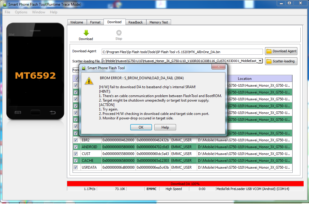

G750_U10 completely dead after flash just vibrates when pressing power button or connecting cable>Always gives this error and keeps vibrating and hear USB sound like it's keeping connecting and disconnecting. Is there any way to revive this device?

This device is a Huawei mediatek
Your approach now to solving this problem is totally BOOT REPAIR VIA MEDIATEK TEST POINT
the test point for detection are kcolo and colo....
If you are familiar with mediatek dead flashing, you may proceed to find the test point if not you may have to send the device to a service Centre for repair..
***First you need to disassemble complete and take out the PCB (board)
***The test points are mostly with no VOLTS when you test their power
***Short the test point (TP) to any GND and insert BATTERY, thereafter connect USB
***Load factory files in any suitable software and flash
****Huawei TP are found in the archives of supported GSM boxes for repair
Take complete pics of pcb for further help

(12-02-2017, 12:27 AM)basim G750_U10 completely dead after flash just vibrates when pressing power button or connecting cable>Always gives this error and keeps vibrating and hear USB sound like it's keeping connecting and disconnecting. Is there any way to revive this device?
Seems you might have to follow the fix outlined by @droidmobitech
Seems like a dead preloader.
Does the phone still get detected in device manager when you connect?
If yes, what does it get detected as.

Yes, your device has the Mt6592 cpu,
It will be appropriate if you could send pictures of the pcb for help
You may try and identify the test point, usually Colo are kcolo should be written on pcb , they are test points. ....
I assume you can go ahead, after disassemble. ..
If not, using a voltmeter, test all other unlabeled points with GND
The test point has no such volts on pcb
Short that point to gnd
Hopefullly, it should detect
If this does not work then an emmc replacement is the final solution
