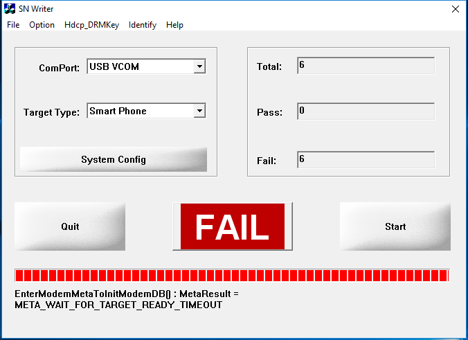

META_WAIT_FOR_TARGET_READY_TIMEOUT
Message: EnterModemMetaToInitModemDB(): MetaResult=META_WAIT_FOR_TARGET_READY_TIMEOUT
Meaning: The tool was unable to detect the phone or took too long detecting/writing to the phone
Solution:
  • Uninstall all Mediatek drivers using USB Deview then reinstall Mediatek VCOM drivers
  • Ensure to connect the phone while switched off, with the battery inserted and not holding any button
