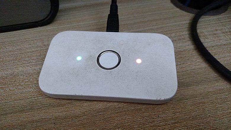

1. lets start, download links above. Download all files as shown in picture
2. disassemble the modem and short the boot pin to the USB connector as shown in the bootshot picture
3. Now connect the mifi to the PC using a usb cable while still holding the boot pin connection above. Once the device shows up in device manager, you can remove the bootshot but leave usb connected

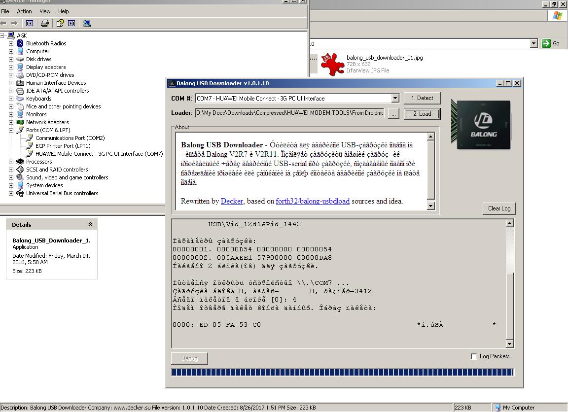

4. Launch balong downloader and flash the USBLOADER file
Extract and run Balong downloader as admin then click detect and ensure the mifi can be detected as BOOT_3G, click browse and locate the USLOADER.BIN then click load to flash

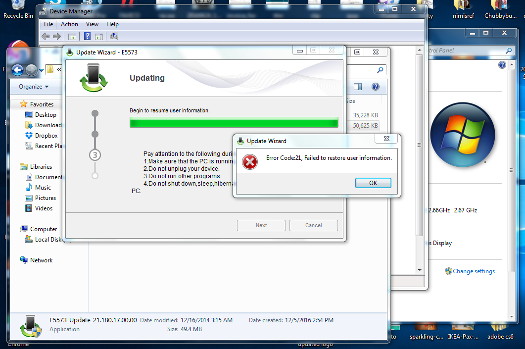

I did everything and all was fine until the last step to upgrade the dashboard to 2.180
It will update to an extent and get stock at
Begin to resume user information
the next thing it will bring up error code 21:
below is attached photo.

OK, I personally got such report from friends but Bro, your modem has been upgraded, once the update process did without Error, its installed with or without USER INFORMATION process
To verify whether mifi is working, cancel the process and put a non accepted sim, and check the mifi for wireless connection and Ethernet
Tested by me......
Modem is upgraded even with user information resume ERROR
