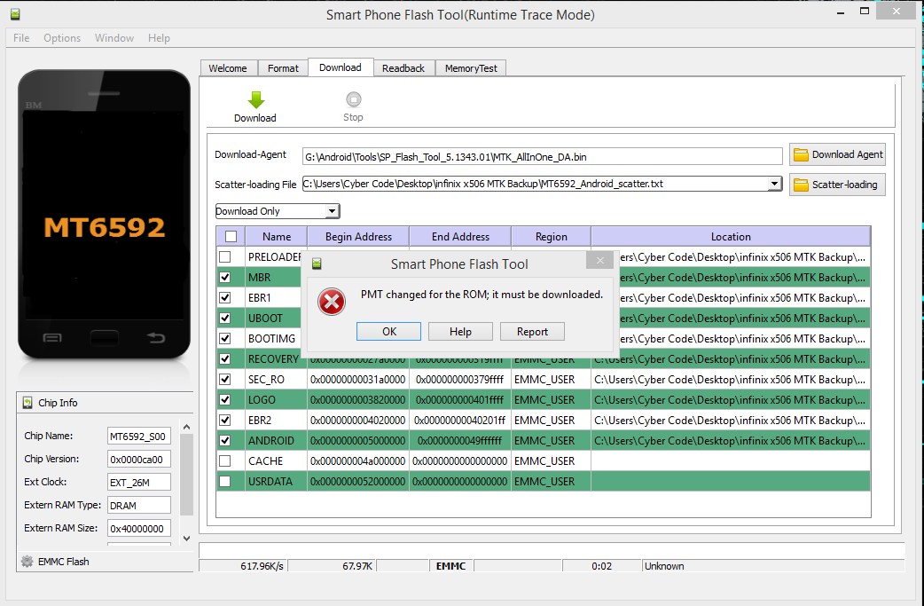

20-02-2015, 06:31 PM
In another PC this message is seen!
51,035
20-02-2015, 09:06 PM
(20-02-2015, 06:31 PM)destroyedx007 In another PC this message is seen!
to fix this issue, read  https://www.hovatek.com/forum/thread-439.html
