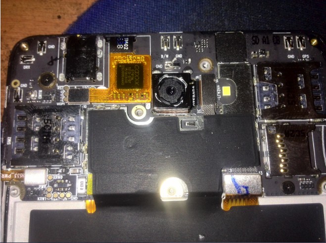

  3. After confirming that you have the right firmware, start xflash tool and load the scatter file then click on start
  4. Only connect the socket in the picture below, then connect the usb cable from the PC to the dead phone. (The PC must not detect the phone at this point)
    [Image: How-to-fix-an-Infinix-Note-2-X600-totall...ware-2.jpg]
  5. Now, make a jumper by connecting a thin piece of wire between the "ground" and the "force boot" pinout.
    [Image: How-to-fix-an-Infinix-Note-2-X600-totall...ware-3.jpg]
    [Image: How-to-fix-an-Infinix-Note-2-X600-totall...ware-4.jpg]
  6. Once your jumper is successful, you'll hear the the connection sound on your PC. The PC will recognize your phone and the xflash tool will begin flashing.

whoa its work detect my device but somehow i cannot flash it because seems like it always unplug after its plug.. its like the unplug sound hearing right after its detected it... and flash processing take forever
edit : woooaaaa its works you just keep doing the part when 2 jumper conected one time... just keep push it till the flashtool goes into green flash load thank hovatex thanx TS you are really life saver

i don't really understand the making a jumper part i connected a network wire to that golden panel don't know where to connect the other end and my computer is yet to detect the phone

19-02-2016, 07:36 PM
finally did the jumper thingy pc now detects the phone but am facing error 3178

19-02-2016, 10:20 PM
(19-02-2016, 07:36 PM)storm52 finally did the jumper thingy pc now detects the phone but am facing error 3178
did you download and install the drivers from my link just make sure about that and everything will be fine
and read this line carefully
" just make the jumper for one touch don't keep them connected"
