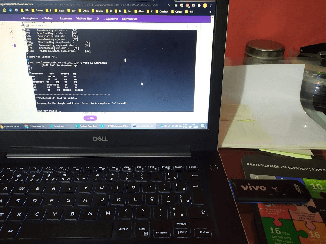

Hello everyone
I have a D-Link DWR-910 Modem with bricked Firmware, this happened after receiving this guidance from D-Link Support to update my modem =/
During the process there was a failure for no reason in the update...
After this error, the Modem does not load the system, it just flashes the LED in RGB and only shows the device as "Android Bootloader Interface" in Windows Device Manager.

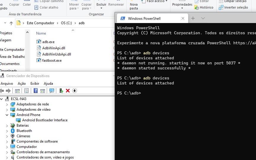

No, it's another version,
I tried to identify it by adb, but it does not appear in the list of devices

(24-03-2021, 08:47 PM)crazypsico No, it's another version,
you should try fastboot devices instead, the device is currently in bootloader i.e fastboot as identified by device manager
