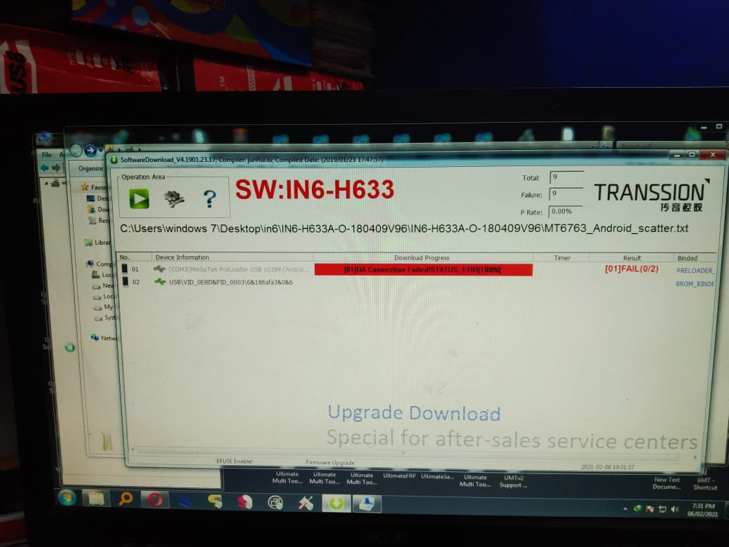

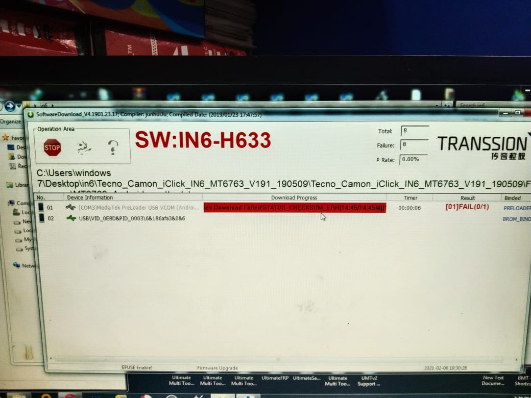

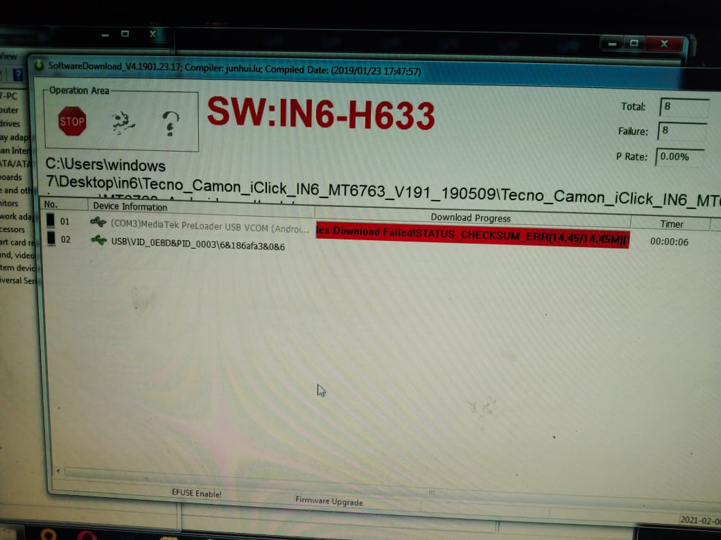

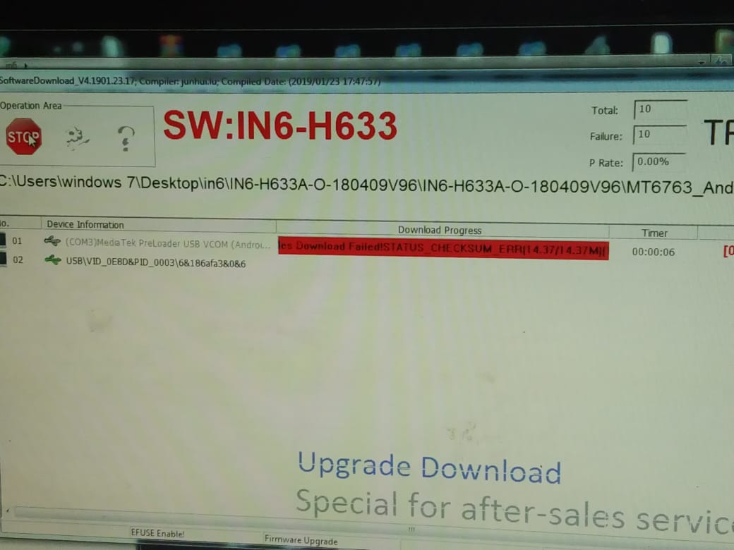

when customer gave his phone that time phone is fine but its google play service error
when i formated his phone its stuck in recovery after reboot reset phone ( data encrypt mybe dycrpt idk)
after that i flashed phone with " Tecno IN6-H633A-O-190509V191 "
now phone is completely dead R.I.P
now i tryed with this firmware but no luck
IN6-H633A-O-180409V96
Tecno_Camon_iClick_IN6_MT6763_V191_190509
tool :-
Tecno_Flash_Tool_v4.1901.23.17
Softwaredownloadv4.1801.03.10_for_AfterSales
same error STATUS CHECKSUM ERROR

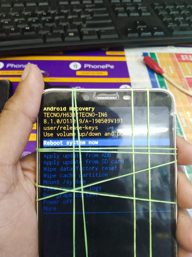

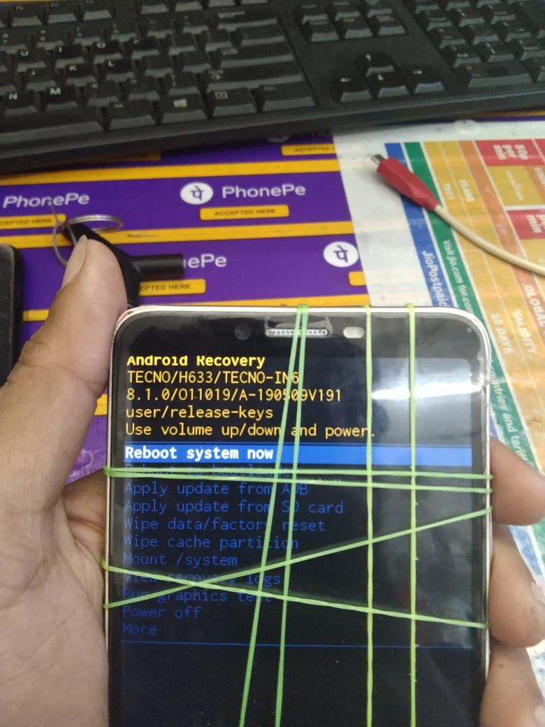

here is alive recoevery pic
old right now mobile still dead
