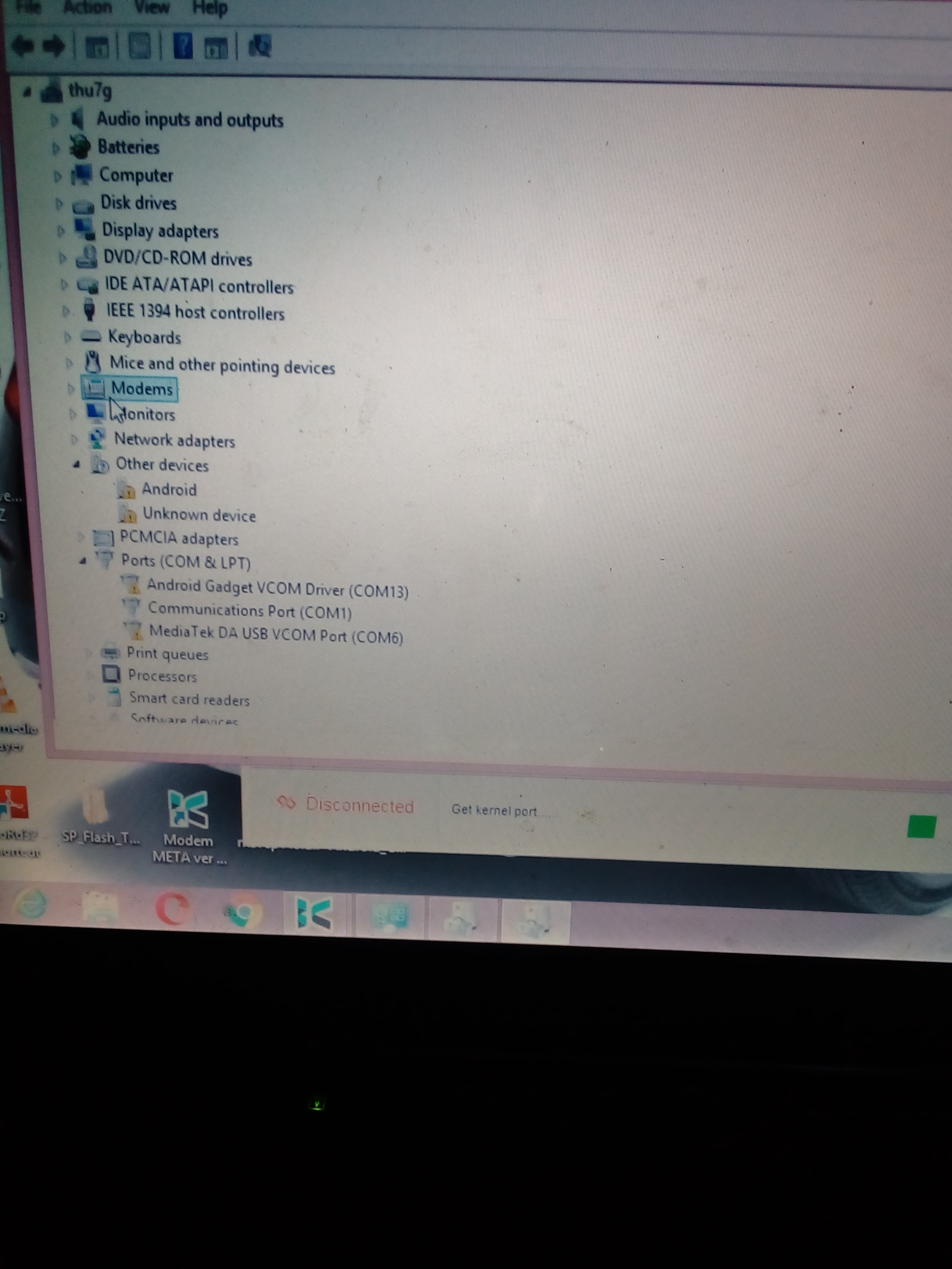

04-09-2020, 09:52 AM
Here is my device manager

04-09-2020, 10:59 AM
I have finally fixed this issue using modem meta ,the issue I faced had to do with one of the drivers saying unknown all I did was to disable the unknown driver and the tool did it's job tanks so much for your assistance sir I am very greatful long live hovatek team
