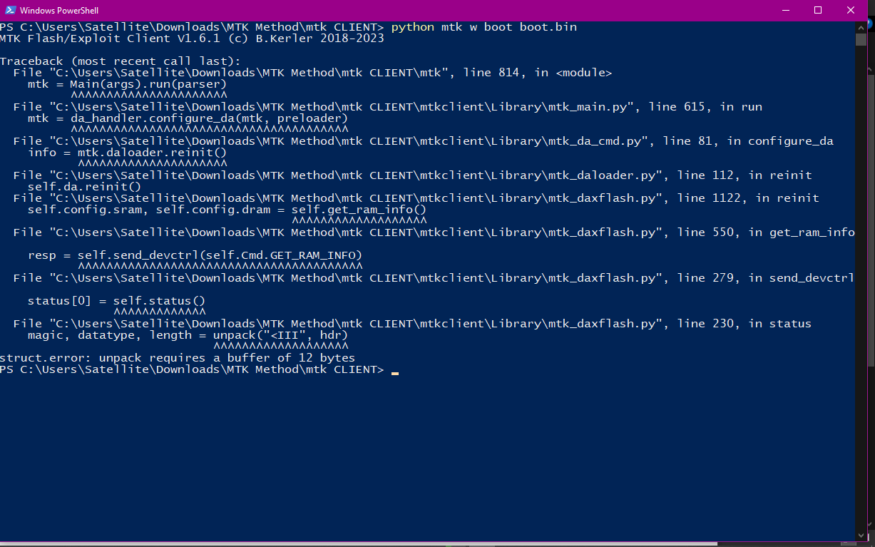

(02-03-2023, 05:49 PM)kelvinchinedu Change the partition name from .img to .bin and it will loacate it
Hi, thankyou so much for still being with me bro, I renamed the extension from .img to .bin of boot file
I used mtk client method to run it and it saidSadattachment)

(02-03-2023, 05:49 PM)1kelvinchinedu Change the partition name from .img to .bin and it will loacate it
hi, here's the document with the full PowerShell error I got after typing:
"python mtk w boot boot.bin"
please check the attachment or right here:

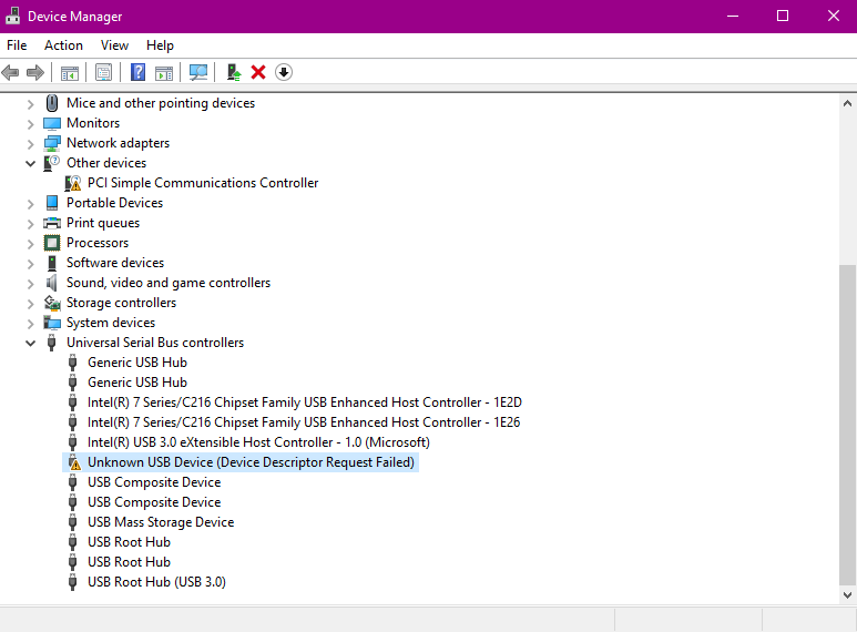

Issue two:
please view the attachment:

hi I got this error when I ran this command in mtk client

(10-03-2023, 08:47 AM)OnlyKlaus hi I got this error when I ran this command in mtk client
Attach the screenshot
