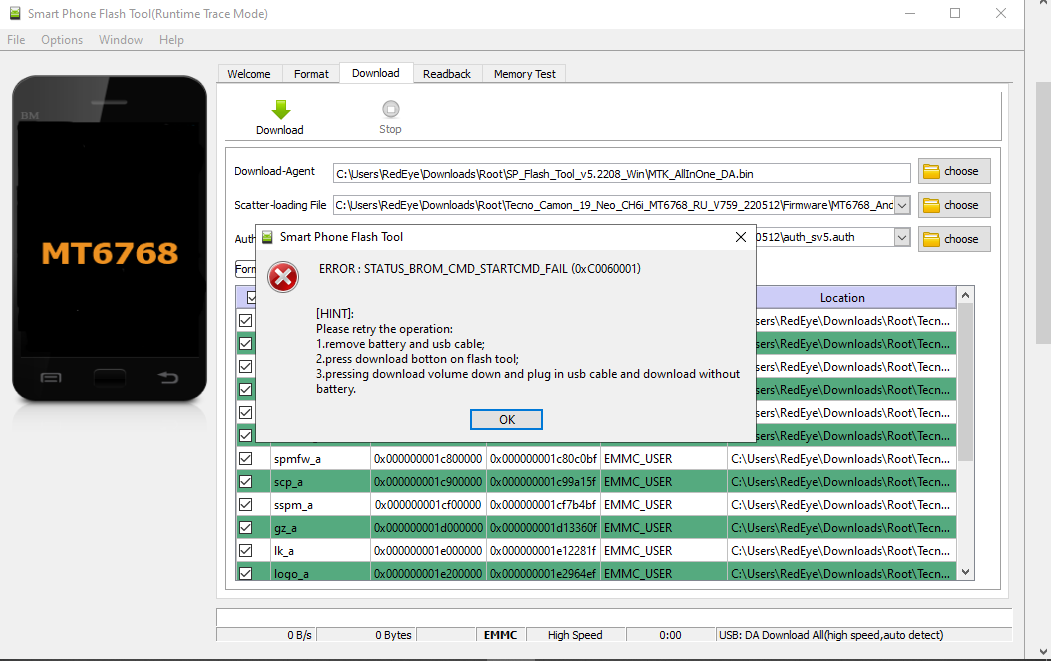

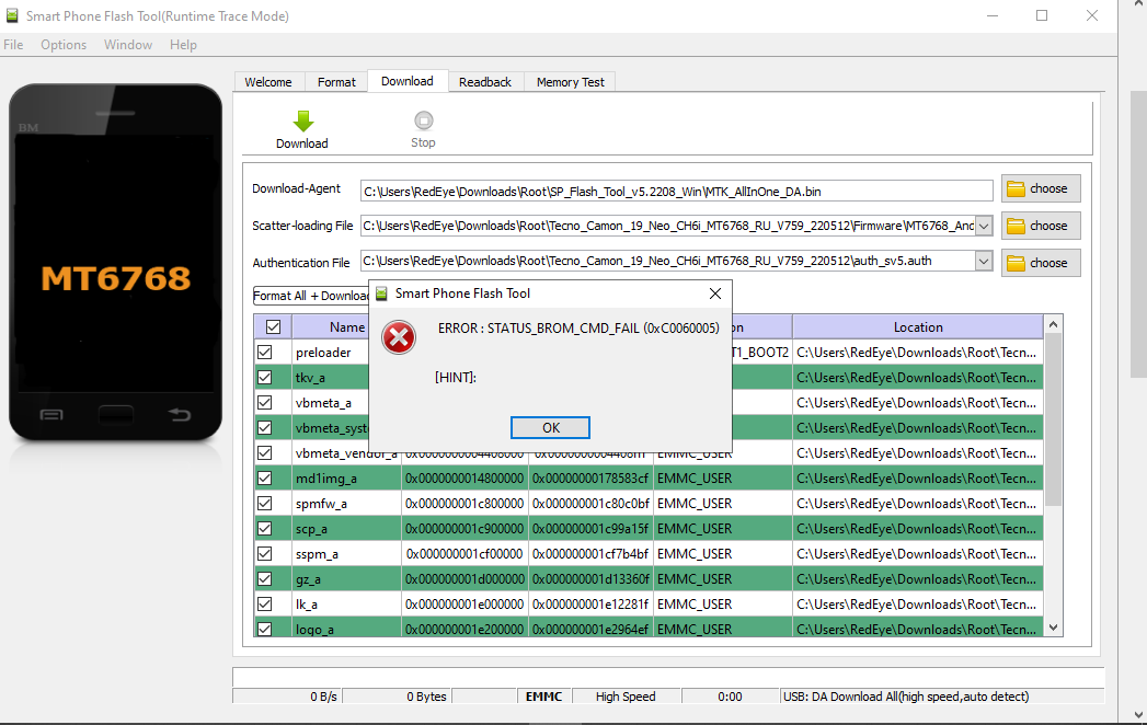

I have spent nights trying to solve this, please help.
My Phone: Tecno Camon 19 Neo (CH6i) MT6768
My issue: orange state bootloop, the phone also disconnects and reconnected again and again to pc
how?: it happened after I used magisk v25 to root my phone using a patched boot.img which I flashed into the phone using fastboot.
I have a stock firmware ready to flash and so I tried to flash using SP Flash Tool but it gives me multiple errors like
I am not sure what to do please help

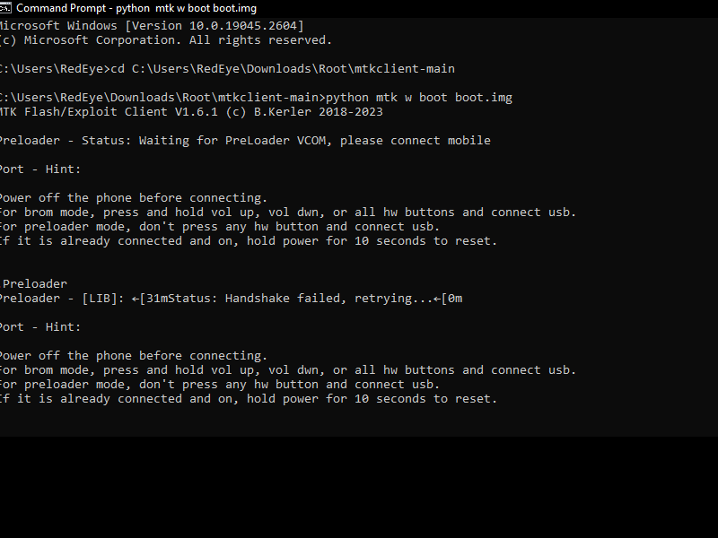

I also tried to flash boot.img using mtk client by this method:https://www.hovatek.com/forum/thread-40866.html
but it says something in line with "Preloader - [LIB]: ←[31mStatus: Handshake failed, retrying...←[0m"
in my device manager when I first put the cable in it says "media tek usb port" but then it disconnects refreshes and says "media tek preloader usbvcom"

I tried to flash boot.img using fastboot but it does not detect my device.
so I tried to flash boot.img using mtk client and it was unsuccesfull for some reason.
it gives me this error when I try using mtkclient again (attachment:cmd 1.png)
the usb driver when I connect my phone to pc is "Media Tek port..." but then it disconnects and refreshes with "Media tek preloader vcom..." from device manager.
