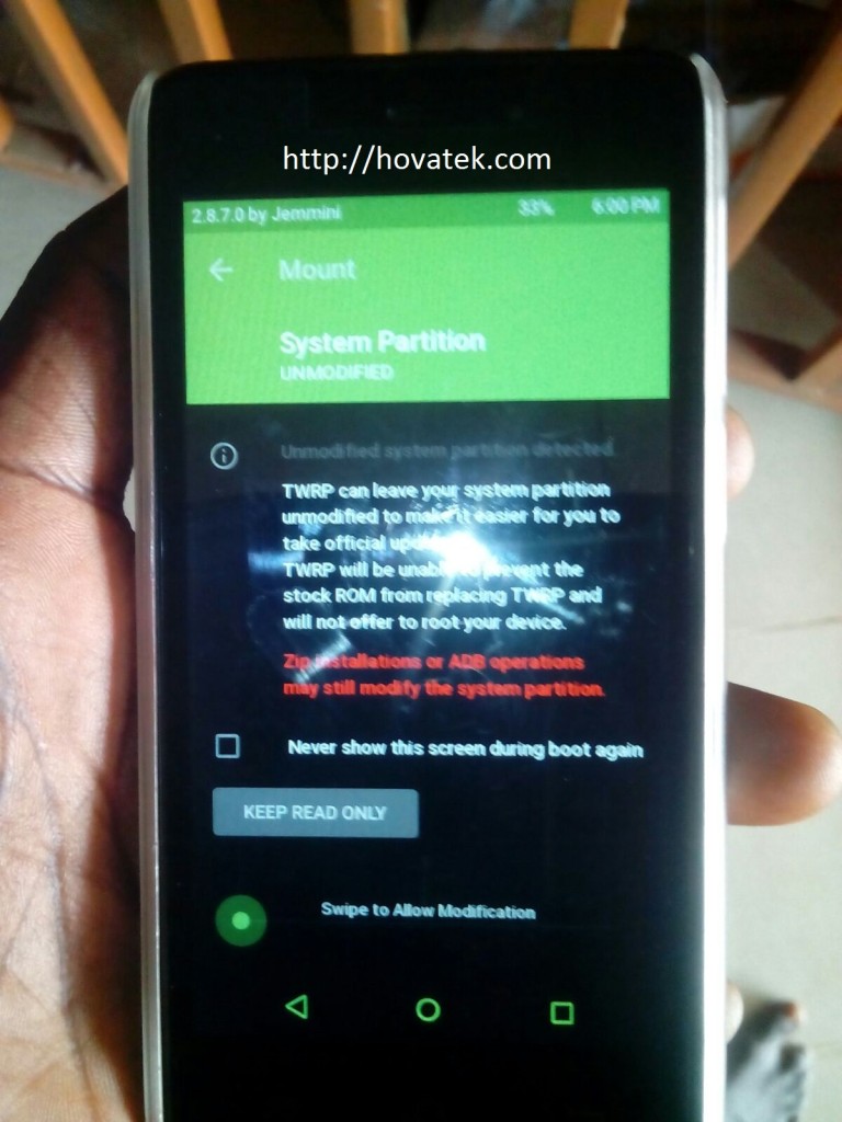

- If you get a message (in TWRP) like in the image below then swipe to allow TWRP modify the system partition
- To swipe, place your finger on the green circle then slide to the right
