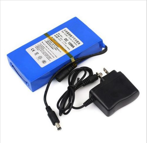

: If there’s one area these hubs score low, its their battery life. What is 2 hours of battery time (The Mi-Fis can boast of more)? Its supposed to be a source of internet connection, not a UPS to allow you shutdown your Desktop PC after a power failure. Over-charging is another thing that kills their batteries. You see, these routers don’t have a battery indicator so there’s no way to know when your battery is almost empty or full, so you just keep charging. You might be advised to take out the battery when connected to power and re-insert during a power failure but this is not practical (see the guide on how to remove and re-insert a Swift hub’s battery at https://www.hovatek.com/forum/thread-2907.html ; what a process to have to repeat time and again). The good news is that you can get a power bank for your 4G LTE hub (router).
power bank for swift, spectranet and smile 4g lte router hub
I got the 9800 mAh capacity (of this power bank) for as low as $28 and have -on several occasions- gone over 20 hours without it ever going flat. Now, that’s better.
