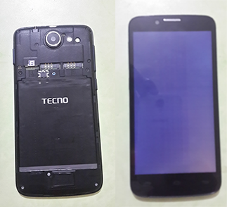

Hello Director, İ am Nurudeen from Ghana. İ happen to have a problem with my Tecno Phantom A+. However;
1. İ have installed the drivers as you specified.
2. İ have flashed my phone with the MTK-Backup you provided me. Thanks for that.
But still my phone wont boot up. blank screen lights up and keeps on vibrating and restarting. Also, İ tried the fastboot method; İ successfull installed the adb as well.
when check for devices:
Available devices attached 123456789ABDCEF            recovery
When i tried flashing it says "<wiating for device>
Below is a picture of what my phone does when pres the power button.
Thank you.

1. can the phone boot into recovery mode?
2. does the phone show Tecno logo when you try booting?

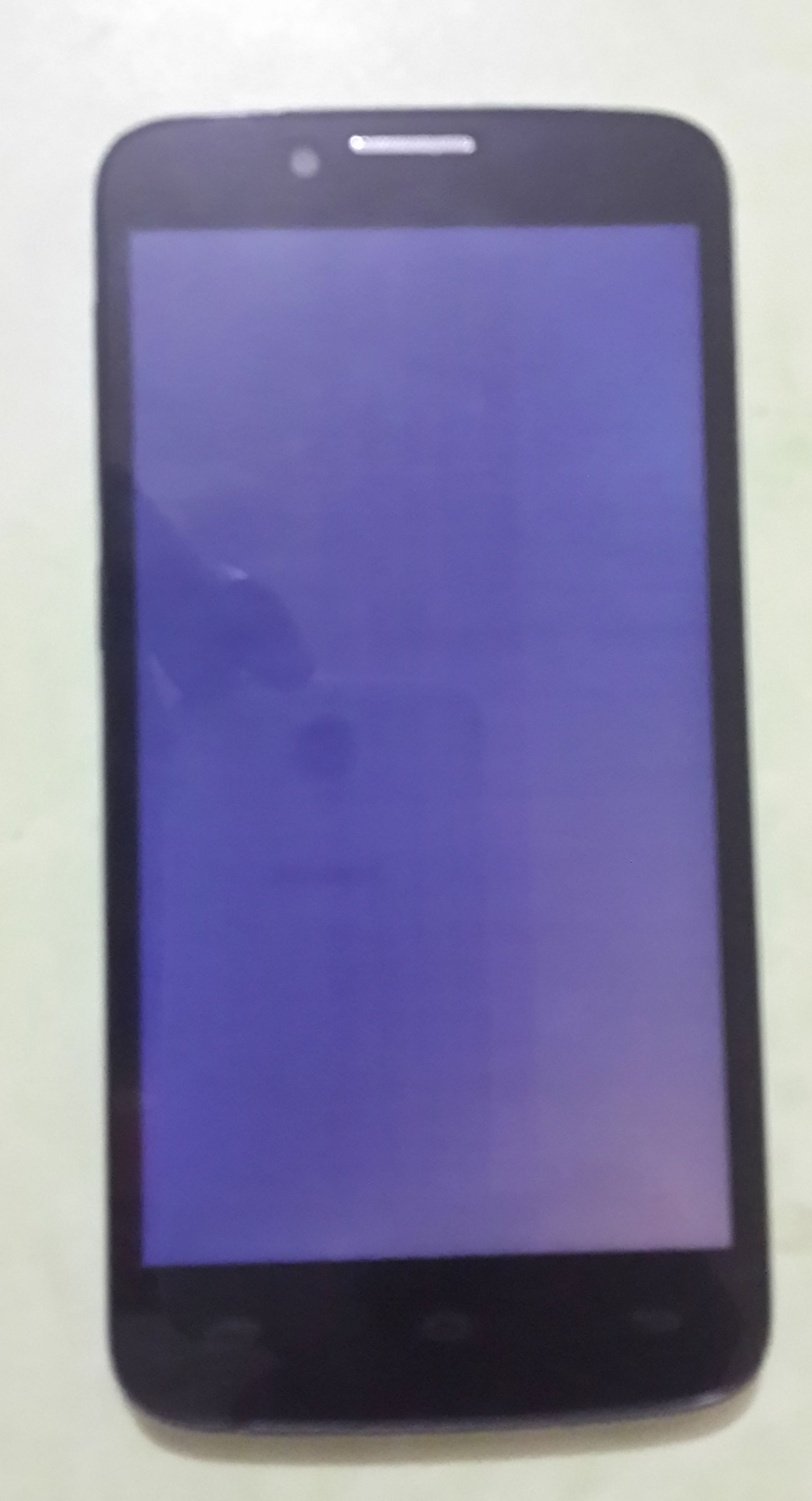

11-12-2014, 10:50 PM
When i press volume increase + power it stucks at the light blue screen in the picture above and it does not vibrate nor goes on and off. İt boots into recovery. But
İ cant best tell weather that's stock recovery or CWM recovery. However i have flashed it with CWM recovery and it was success with the green round logo.
Director nothing displays text nor icon on my screen.
Thank you.
This post was last modified: 11-12-2014, 11:08 PM by Affableural183.

12-12-2014, 06:57 AM
The screen does not display anything to see Director.
but when it is in the recovery mode, it does not goes on and off.
when i press only power button it keeps vibrating and going off and on i mean the blue screen BUT when press volume increase + power it stays blue, no vibrating no turning off.
below is how it will show:
Thank  you.

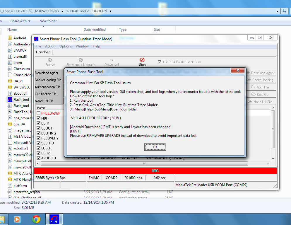

12-12-2014, 05:28 PM
thanks a lot Director, i did format it with MTK-Backup you provided with SP flash from this Site but still no changes.
Actually it was from this site that i got the F7 Preloader that even make my phone to show some life in it.
First i couldnt flash it ... it was givimg me erros.
Could it be the preloader or İs there a way of fartmatting the whole partitions i mean the EMMC and re-program the whole phone.
Thank you.

51,059
12-12-2014, 06:09 PM
(12-12-2014, 05:28 PM)Affableural183 thanks a lot Director, i did format it with MTK-Backup you provided with SP flash from this Site but still no changes.
Thank you.
that means what you should be using is the Tecno Phantom A (F7) MTK backup. go request for this exact file @ https://www.hovatek.com/forum/thread-311.html
