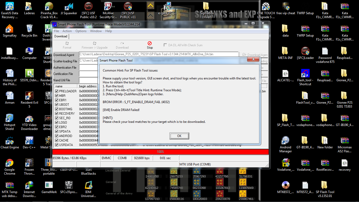

Hovatek Help me to fix my GIONEE P2s Dead/Brick No Power No Recovery No Battery Sign and flash tool is error when i flash it "click the attachment file" tnx just comment please

error 4032 is a mismatch error (refer to https://www.hovatek.com/forum/thread-439.html )
you need to get a Gionee P2S firmware from a different source and try flashing it

(24-09-2015, 04:13 PM)hovatek error 4032 is a mismatch error (refer to https://www.hovatek.com/forum/thread-439.html ) you need to get a Gionee P2S firmware from a different source and try flashing it
Hovatek please gave me Exact Firmware of Gionee P2s and Flash tool  Big Grin
This post was last modified: 15-08-2016, 12:06 AM by hovatek.
25-09-2015, 11:19 AM
(25-09-2015, 07:23 AM)agladeras Hovatek please gave me Exact Firmware of Gionee P2s and Flash tool  Big Grin
how did you get the one you were trying to flash?

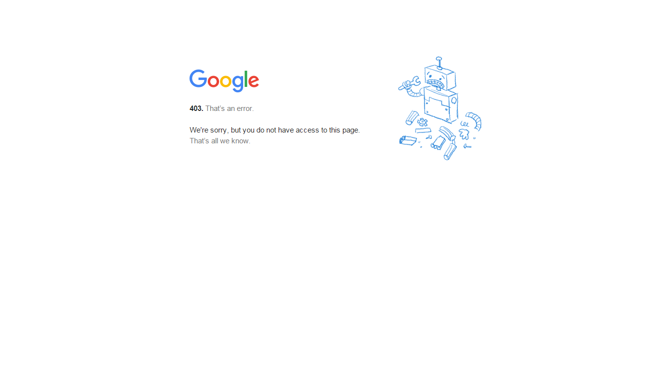

I get it on "xdafirmware" but i have 3 version of stock ROM the "T5459" "T5303" and "T5231"
all stock ROM are in "xdafirmware" your collection of GIONEE is cannot download error in google docs

and all 3 versions you tried flashing gave error 4032?
