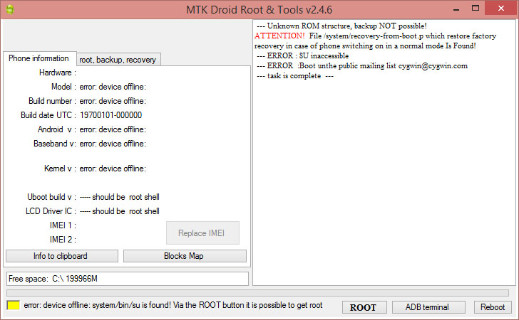

11-11-2014, 12:46 PM
#16
hovat
JayJagz I can't change from Carliv Touch Recovery to Clockworkmode since the phone is not booting into main menu, unless there is a flashable zip that i can flash it with CTR but i have MTK backup with me
if the phone can boot into carliv touch recovery then it can get detected by MTK droid tools and you can flash clockworkmod recovery to the phone. just follow the guide
MTK droid tool detect the phone but shows error in phone information, please check screenchot i upload

(11-11-2014, 12:46 PM)JayJagz MTK droid tool detect the phone but shows error in phone information, please check screenchot i upload
ok. that must mean the phone is bricked at the moment. If this is true then you'll need to reflash only system.img (Android) in sp flash tool. please, list the files in your MTK backup before you proceed.

51,057
11-11-2014, 09:25 PM
#20
JayJagz boot
EBR1
EBR2
lk
logo
MBR
MT6572_Adriod_scatter
Preloader
recovery
secro
system
alright. shouldnt be much of a problem here. Flash only Android (system.img) in SP Flash tool using this guide @ http://www.hovatek.com/forum/thread-159.html
