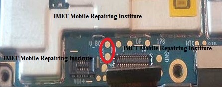

03-07-2025, 02:22 PM
(26-06-2025, 01:26 PM)dlikedoves When I select port on the QFIL flash tool I see this: Qualcomm HS-USB Diagnostic 900E (COM45)
Thank you
That is Diag mode.
Was this the pinout you used (image attached below)?
You can also try holding Power + Volume decrease button for about 30 seconds, then retry EDL with button combo

03-07-2025, 02:27 PM
Thank you all for your support, I later discovered the fault was from one faulty camera bridging the board and preventing display
It was at the point of trying to buy another panel that the camera prevented the new panel from displaying so I powered mine without the cameras and it worked fine
Thanks once again
