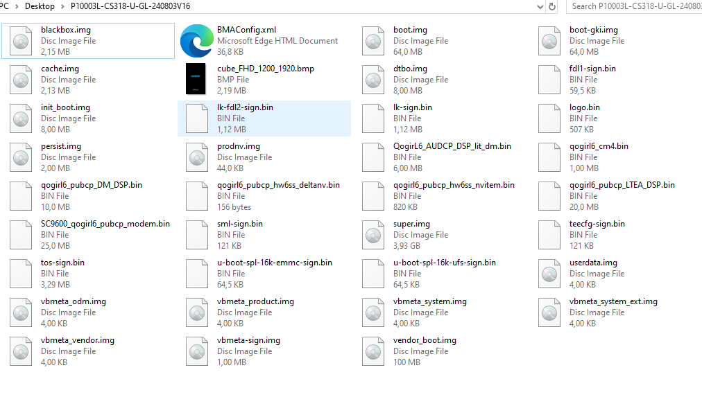

here's my firmware screenshot after extracting from PAC file sir. i still not able to booting up or even entering recovery mode from this device.

(13-05-2025, 12:33 AM)javanesse.net@gmail.com here's my firmware screenshot after extracting from PAC file sir. i still not able to booting up or even entering recovery mode from this device.
The problem seems to be super.img. Maybe its in the wrong format/type.
