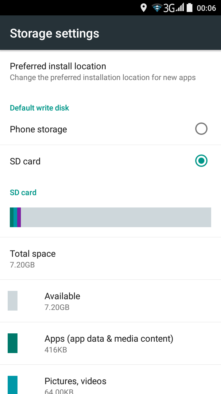

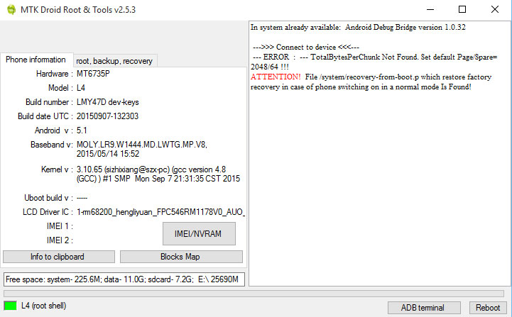

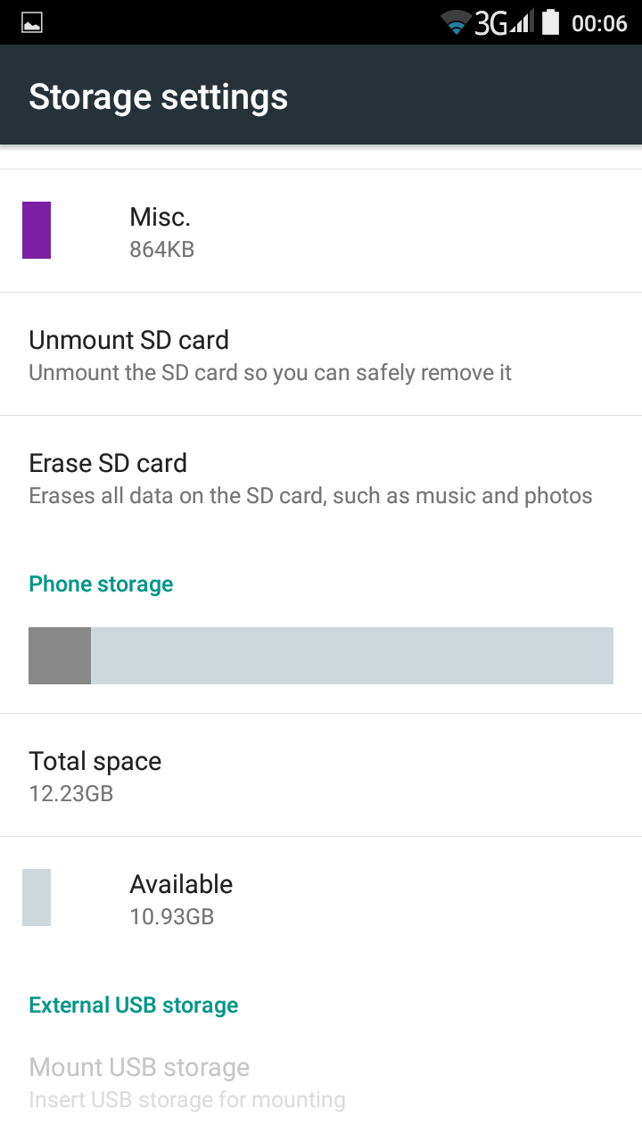

10-11-2015, 08:11 PM
#57
As I mentioned:
at least 7GB free space on SD card.
at least 10GB free space on phone storage.
Plz see screens
Plus, you can see the first "TotalBytesPerChunk" error on connect which is still there and is not leaving it alone
This post was last modified: 10-11-2015, 08:25 PM by bellskar. Edit Reason: MTK Droid Tools with memory detail
