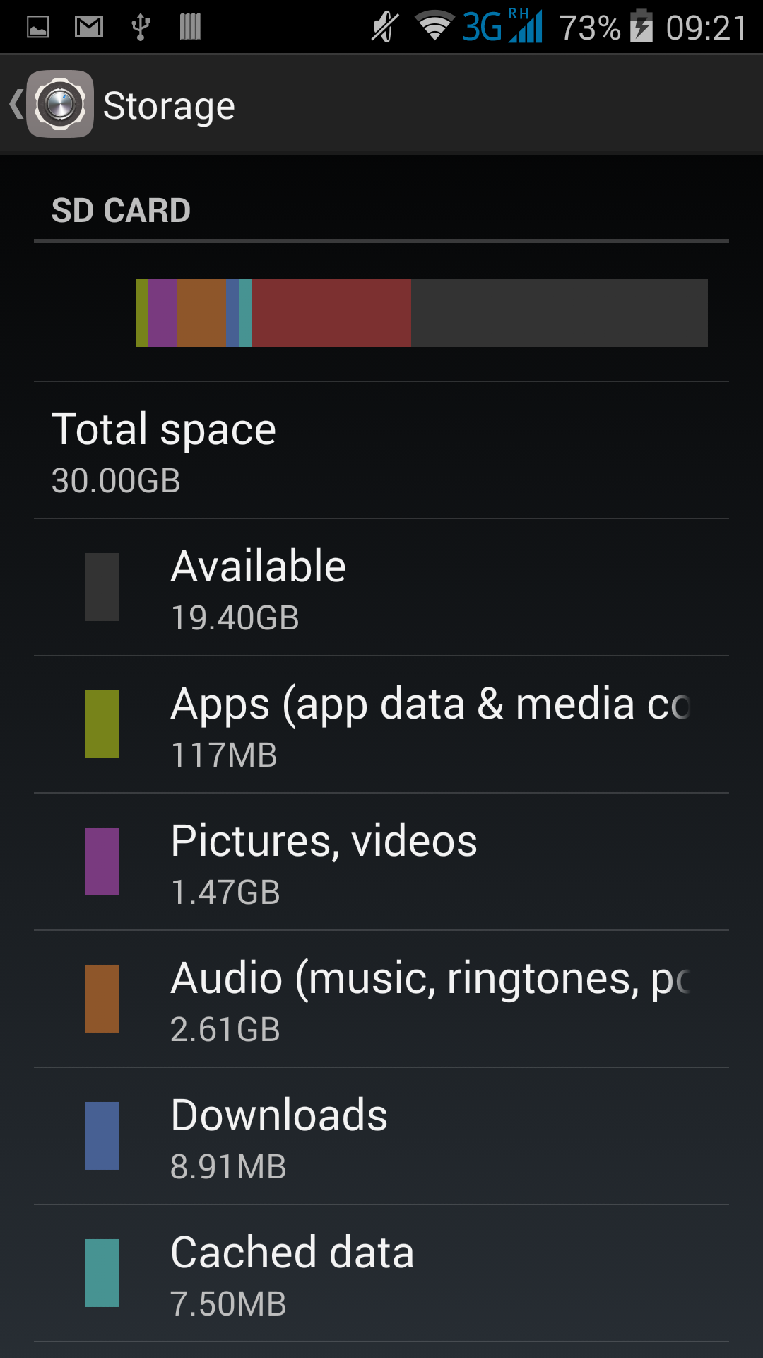

Hi,

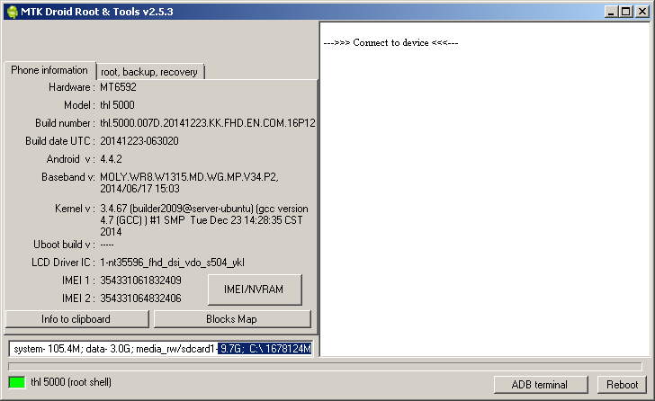

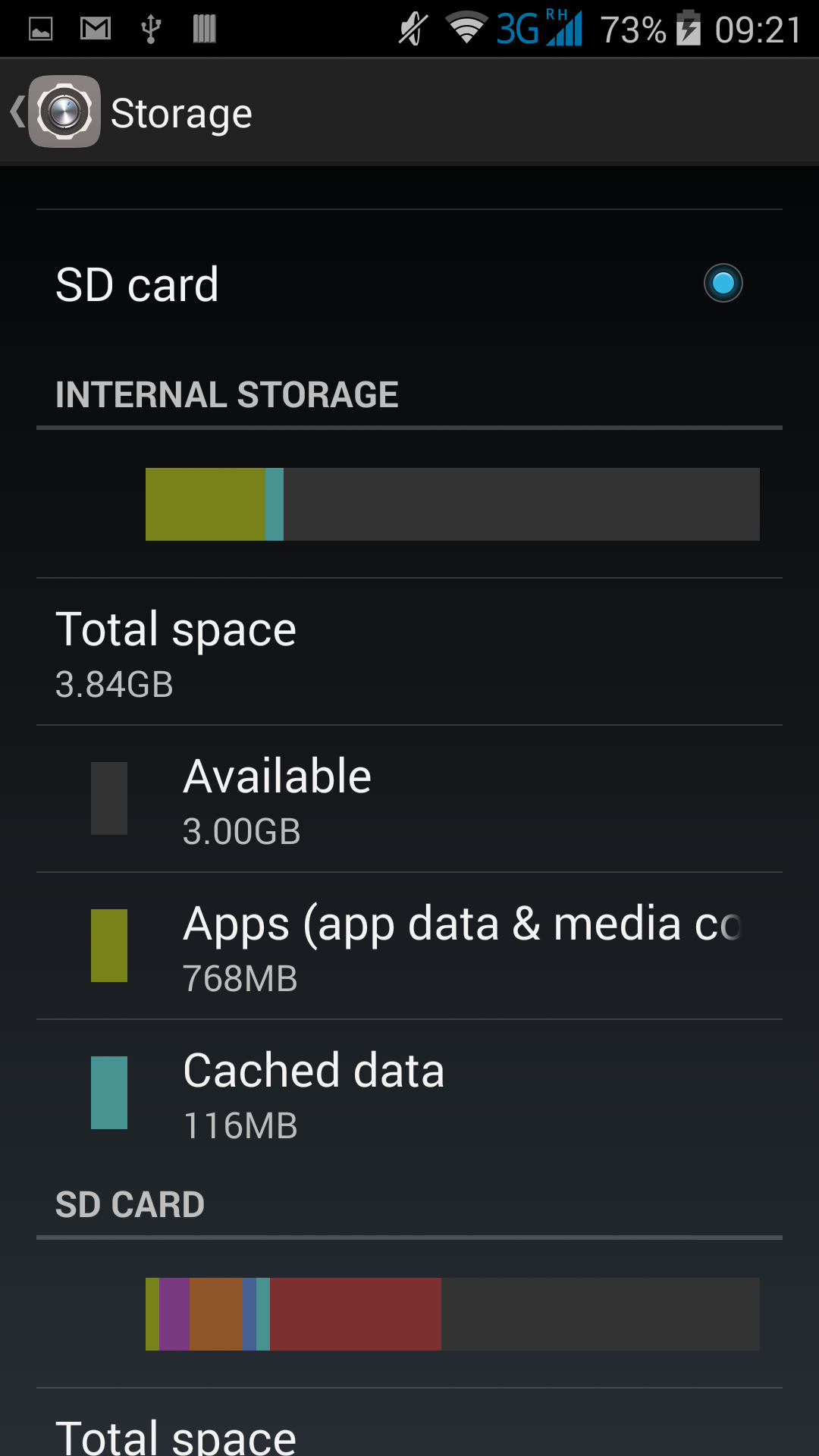

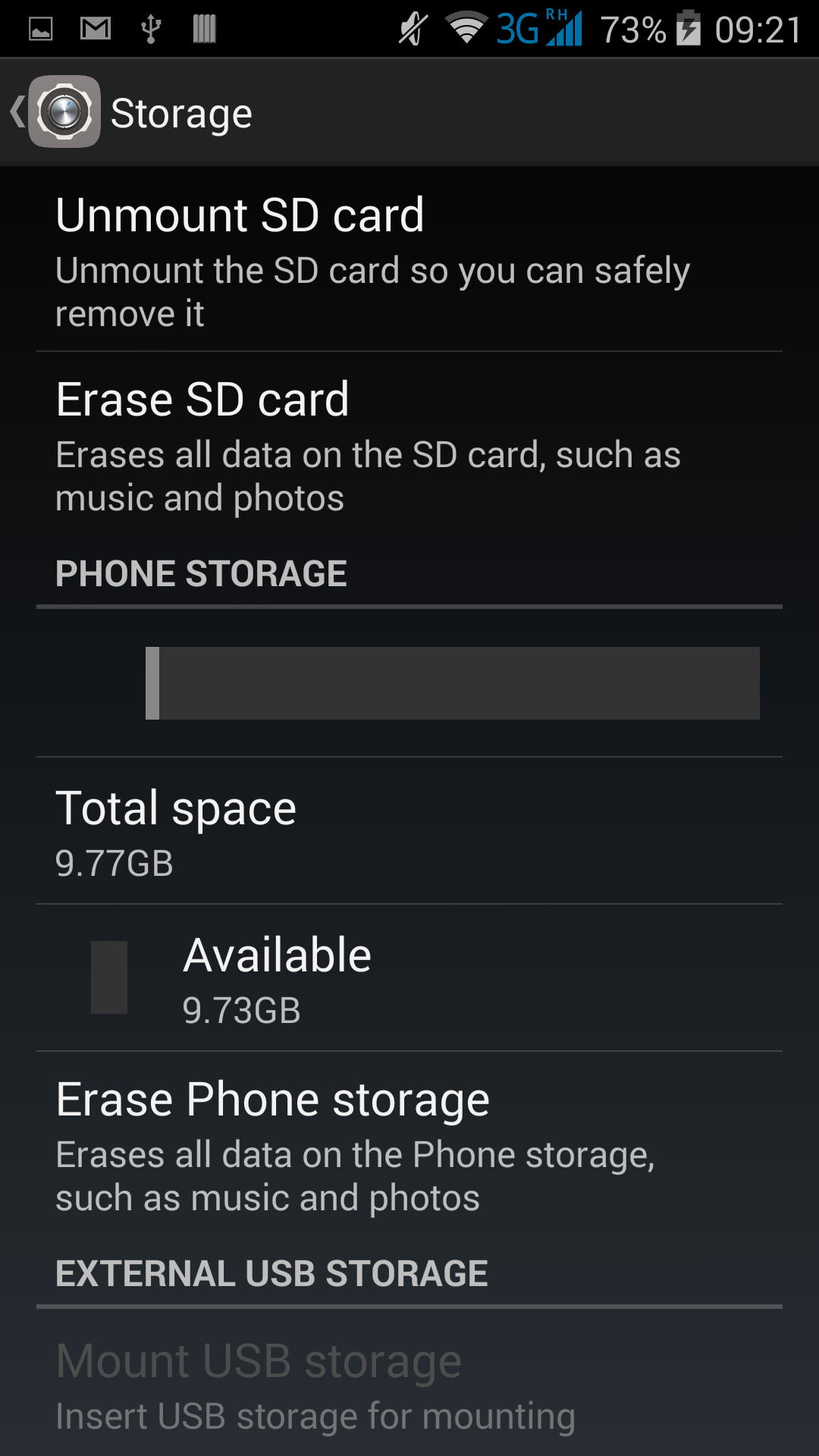

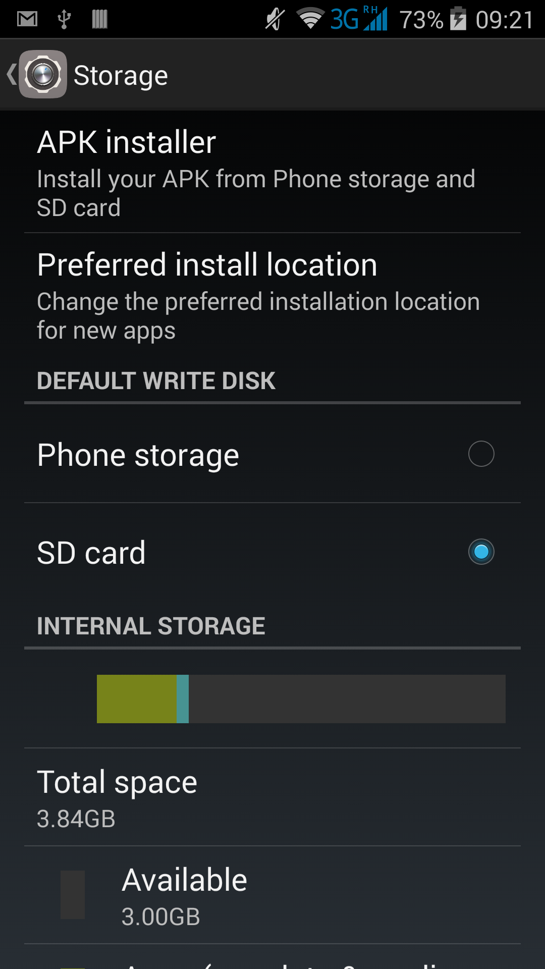

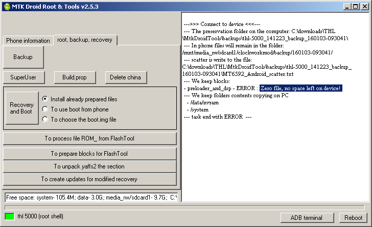

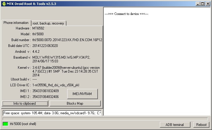

I keep getting this " Zero file, no space left on device!" error.
I have plenty of space left on my device.
Please see the attached files. I tried to gather as much info as i could.

03-01-2016, 08:36 PM
(03-01-2016, 09:42 AM)doron Here is the rest of the info/log files.
the partitions might be too large.
try using the method @ https://www.hovatek.com/forum/thread-526.html
