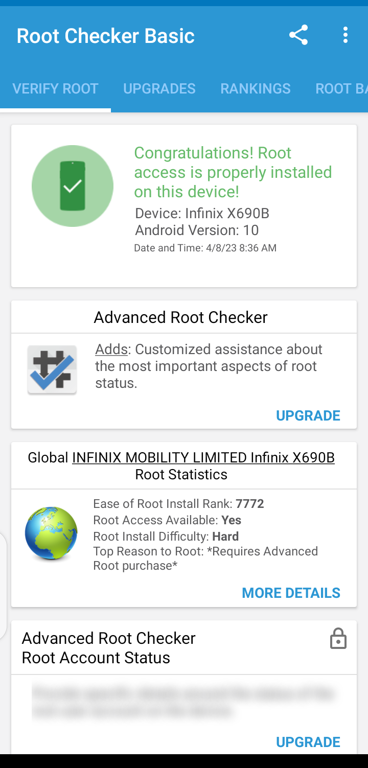

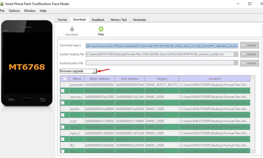

bootloader has been unlocked, and device is rooted

One time I flahsed the phone with SP flash tool, sim card detected and Baseband became known, but imei tool couldn't work because the phone refused to enter metamode
