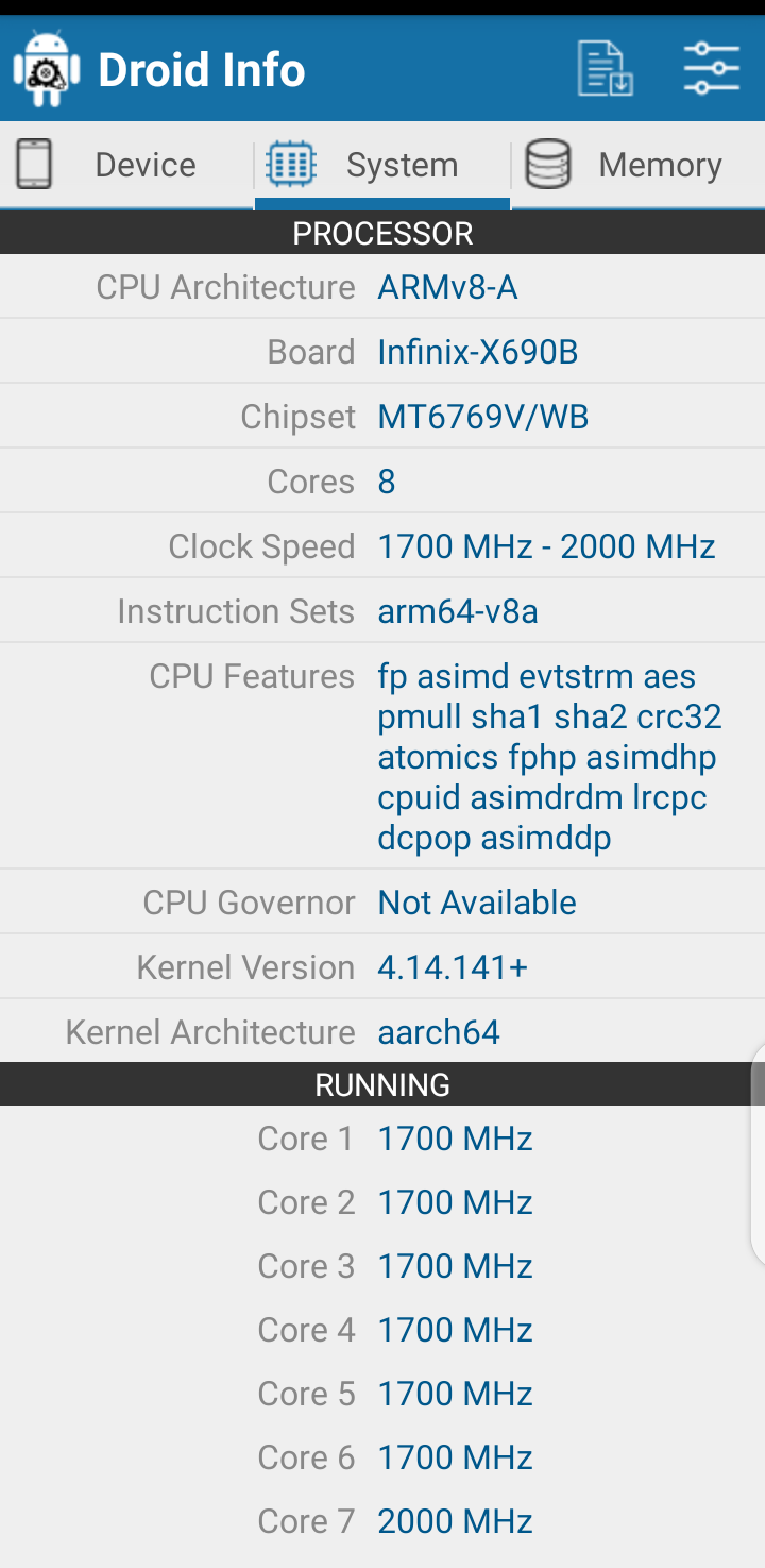

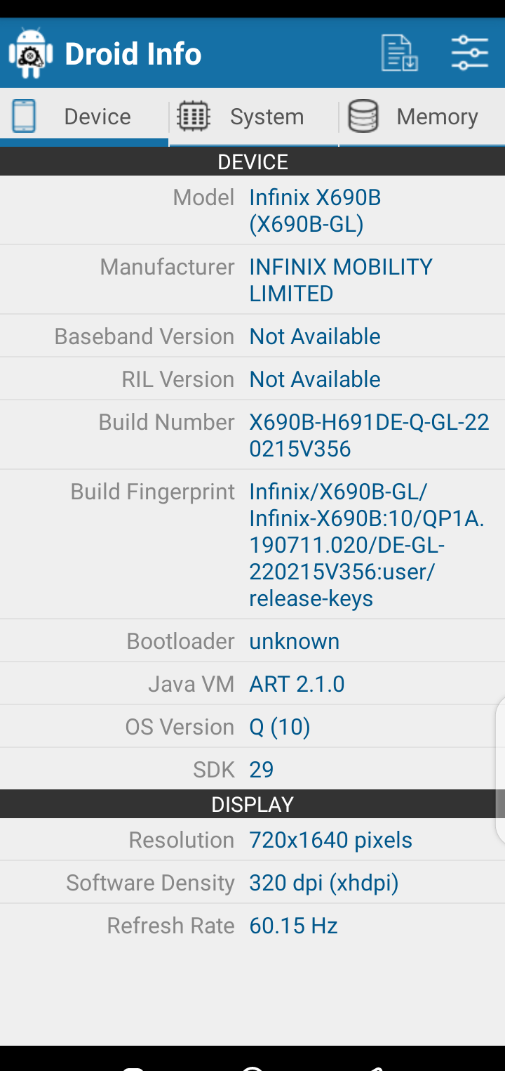

I used this command (adb getvar all) or something like that.. and it showed the baseand number.
But droid info is saying unknown
