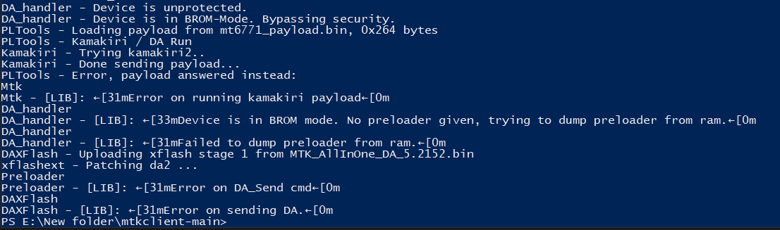

@Abdulkaleem14,
Thank you. But I am getting an error, and I can't understand it. I have attached it:

13-06-2022, 09:09 AM
(12-06-2022, 07:33 AM)adithxv @Abdulkaleem14,
Try in MTK bypass and share the output

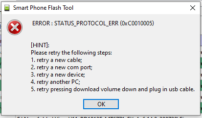

14-06-2022, 04:54 PM
I first successfully bypassed using MCT, and then used SP Flash Tool (UART, 921600). It gets stuck at Download DA 100%, a filled red bar, and gives an error. This happens in every port I have and all cables. I have attached the screens

14-06-2022, 10:41 PM
(14-06-2022, 04:54 PM)adithxv I first successfully bypassed using MCT, and then used SP Flash Tool (UART, 921600). It gets stuck at Download DA 100%, a filled red bar, and gives an error. This happens in every port I have and all cables. I have attached the screens
Change SP flashtool settings from (UART, 921600) to Highspeed USB

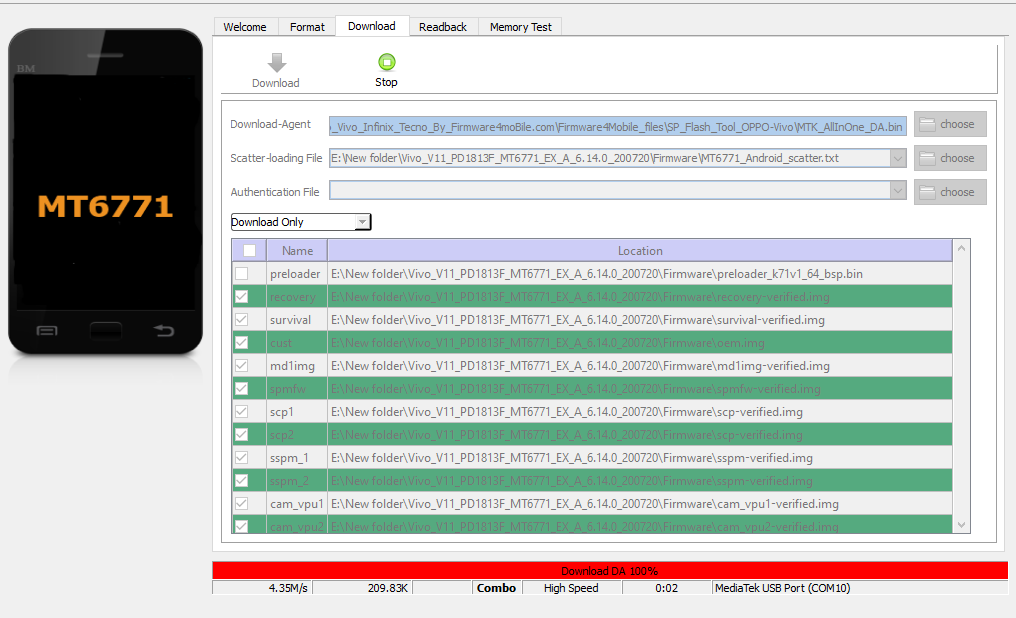

15-06-2022, 03:37 AM
I tried the option you mentioned, again the same error and red bar (DA 100%). SS attached

16-06-2022, 10:24 AM
(15-06-2022, 03:37 AM)adithxv I tried the option you mentioned, again the same error and red bar (DA 100%). SS attached
Do you have both mtkclient and mtk bypass set up?
Let me see the output with MTK bypass @ https://www.hovatek.com/forum/thread-37957.html
