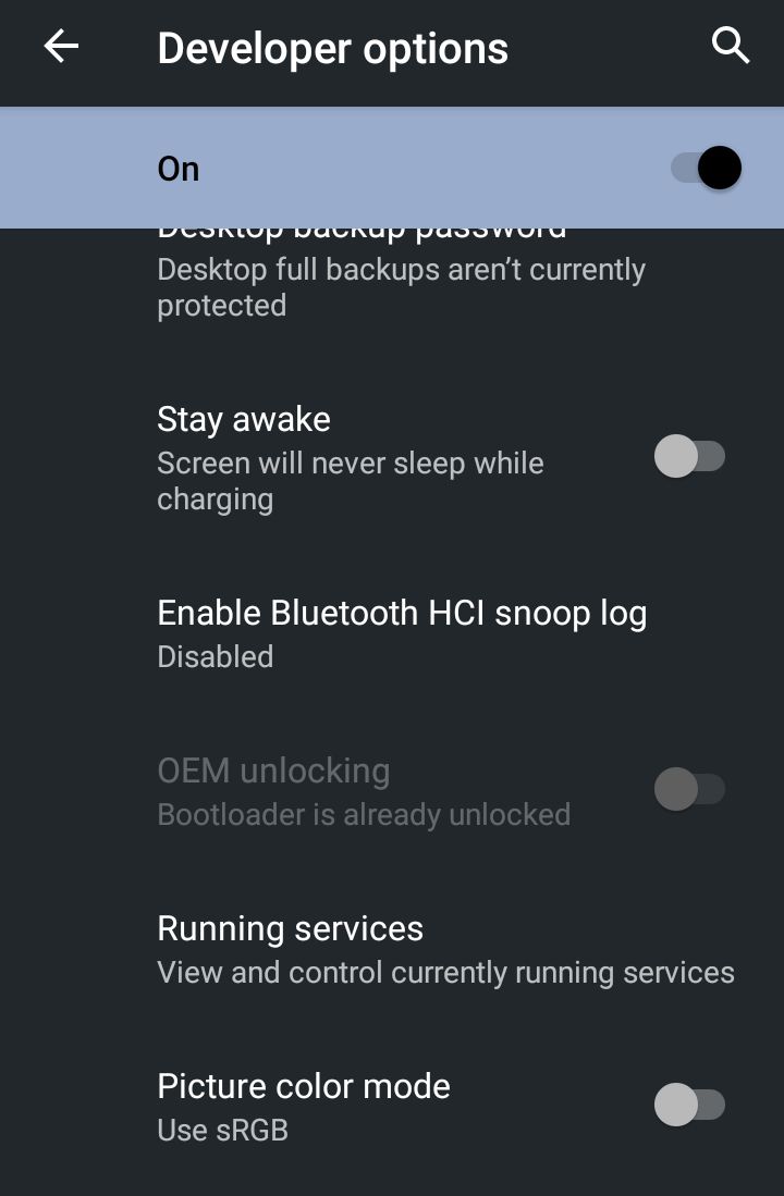

so, I want to ask another thing..after unlocking Bootloader I failed many attempt to flasg twrp so I 3 time soft bricked my phone and had to flash my stock firmware using spd upgrade tool, so is my Bootloader still unlocked? I am little bit confused because in developer options Below "OEM Unlocking" options it Bootloader is already unlocked and option is disabled but the swith is turned off...can you confirm me is it still unlocked or not? I added a screenshot, check.
And Yah I will post the result after I flash the "Stock Vbmeta" like you said, tnx for early reply.
Looks like its still unlocked. You can confirm in fastboot though.

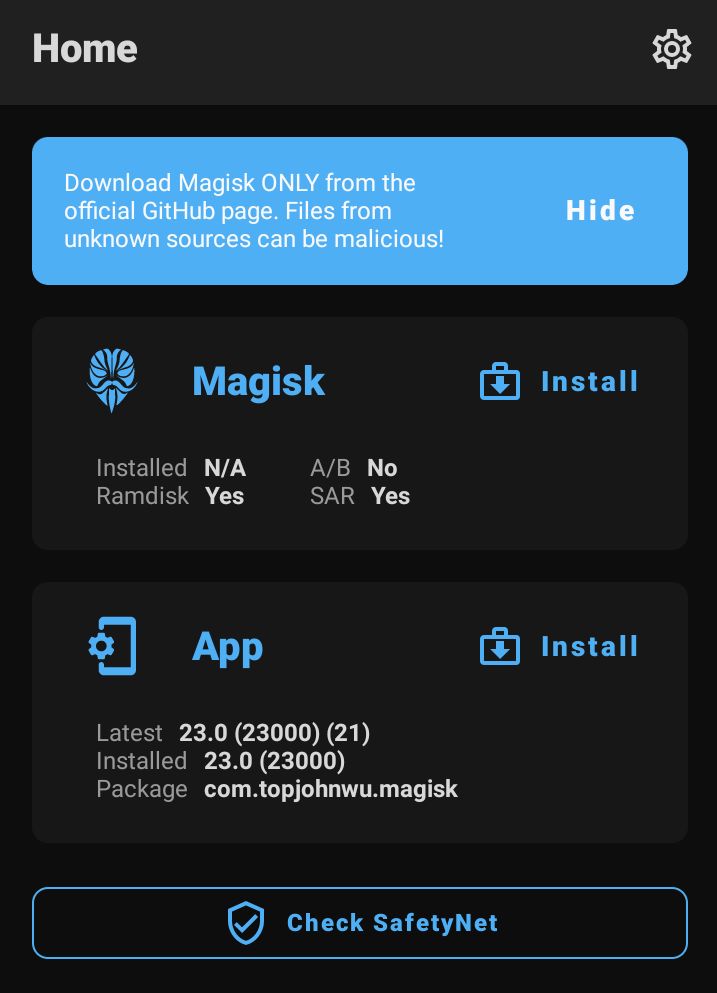

19-11-2021, 05:38 PM
#18
(19-11-2021, 04:37 PM)hovatek set flag to 0
ok flashed, now what?
how can I root using magisk?
my phone is system-as-root (confirmed)
in magisk app ramdisk is yes
I attached a screenshot of magisk
I didn't used hovatek.pem for any partition while making custom signed vbmeta
(flashed stock vbmeta)
also, do I need to flash Magisk signed patched recovery or Magisk signed patched boot?

20-11-2021, 07:40 AM
#19
(19-11-2021, 05:38 PM)Ahmed Jubayer
(18-11-2021, 07:01 PM)Ahmed Jubayer See attached files please...
set flag to 0
flash magisk patched boot
