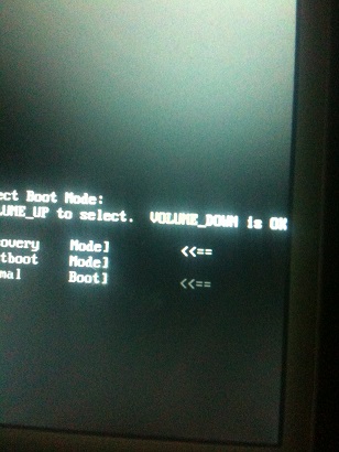

Have you been seeing Select boot mode when you try booting your MTK Android phone? Well, some MTK users have complained about their MTK Android phones not booting normally when they press the power button. Instead, their phones boot straight into boot mode with the cursor / arrow  automatically scrolling up and down, thereby, not allowing to select any option. Phones in such a situation also can't boot into recovery mode.  Many of such cases are linked to faulty boot / recovery partitions.
How to fix an MTK Android phone booting straight into boot mode
If you're experiencing such, here are some things you could do.

[Image: MTK_Phone_entering_boot_mode.jpg]

(20-07-2014, 07:45 PM)hovatek Some Tecno users have complained about their Tecno phones not booting normally when they press the power button. Instead, their phones boot into recovery or factory mode (shows a selectable list of boot mode, Recovery mode, Fastboot, Normal mode etc) with the cursor / arrow automatically scrolling up and down, thereby, not allowing to select any option. Don't fret, the Tecno phone isn't bricked; the volume down (decrease) button or volume up (increase) is just sticky and you need to lift / loosen it. To confirm that the volume button(s) is / are faulty, connect the phone to a working PC then try powering the phone on again. A PC connection automatically overrides the effect of both volume buttons. If the phone comes on normally then you have a confirmation that one of the volume buttons is faulty. In many cases, holding both volume buttons before pressing the power button helps the phone boot into normal mode. If this doesn't help, take a look at both volume buttons.

My android phone is not booting into recovery mode, it only boot factory mode automatically when I insert the battery. I have tried all my possible best, connecting to PC, checking the both volume button and other, but the phone continue to boot into factory mode any time I power it on and sometimes it power itself Mean while one of my android phone is not booting into recovery mode, it only boot factory mode automatically when I insert the battery and boot into factory mode each time I inserted the battery into the phone. Anytime I press the power + home + volume up button simultaneously, i will not just power on at all until i release my hand. Any help pls!

My android Gowin T401 is not booting into recovery mode, it only boot factory mode automatically when I insert the battery. I have tried all my possible best, connecting to PC, checking the both volume button and other, but the phone continue to boot into factory mode any time I power it on and sometimes it power itself on each time I insert the battery and boot into factory mode. Anytime I press the power + home + volume up button simultaneously, i will not just power on at all until i release my hand. Any help pls!

list the items you see in factory mode

Auto text
Manual text
Flash file
Reboot
Others items on normal tecno android factory mode

what happens when you select the recovery mode option in factory mode

I tried flashing the phone with steps given with spflash tool but the problem persist, later I power the phone with volume decrease with power button but is only showing chinnese language which I don't understand please is there anything I can do I try holding volume decrease button and power but it kept going to the select boot mode screen with the cursor moving.
Please any help in the house please anyone
