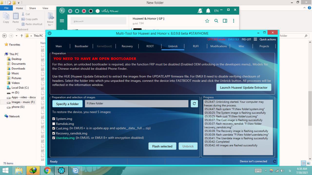

13
13-08-2021, 03:43 PM
#17
(13-08-2021, 08:07 AM)hovatek
(12-08-2021, 06:42 AM)javadoverall I tried 3 different firmware in dload that did not go to the flash screen at all
I also flashed 3 firmwares in fast boot mode, but nothing happened after the flash
I think my phone is hard-broken؟
1. Which boxes / dongles do you have?
2. Share the screenshot(s) of the fastboot command(s) you ran
Unfortunately I do not have a box or dongle.
i use uni android tool or molti tool for flash whith fastboot
