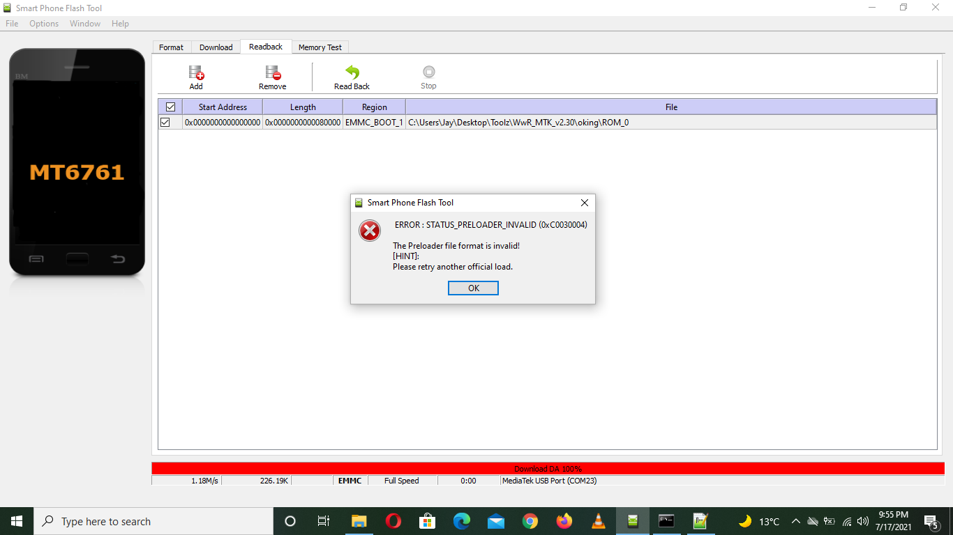

Team..am having a problem on reading the full file using sp flash...am geting the error (attached) and am verry confused on memory test tab..its different from other chipset..how can i read full filmware of this phone as stated here https://www.hovatek.com/forum/thread-21970.html

(18-07-2021, 10:11 AM)joe-crack Team..am having a problem on reading the full file using sp flash...am geting the error (attached) and am verry confused on memory test tab..its different from other chipset..how can i read full filmware of this phone as stated here https://www.hovatek.com/forum/thread-21970.html
fix for this error is listed @ https://www.hovatek.com/forum/thread-439.html ; you need an existing preloader for nokia 2.3 to proceed with readback
download any firmware for the same model (regardless of build), extract the preloader and include it's path in spft download tab before proceeding with readback

Thanks i got it....but my problem is how can i get the address like the start address and the lengths of the whole rom

(20-07-2021, 11:35 AM)joe-crack Thanks i got it....but my problem is how can i get the address like the start address and the lengths of the whole rom
start address regardless of region (e.g emmc_boot1 or emmc_user is always 0x0)
for the length of the whole rom, you need to readback pgpt (0x0 to 0x80000) then select the pgpt into wwr as explained @ https://www.hovatek.com/forum/thread-22701.html to get the full length of emmc
